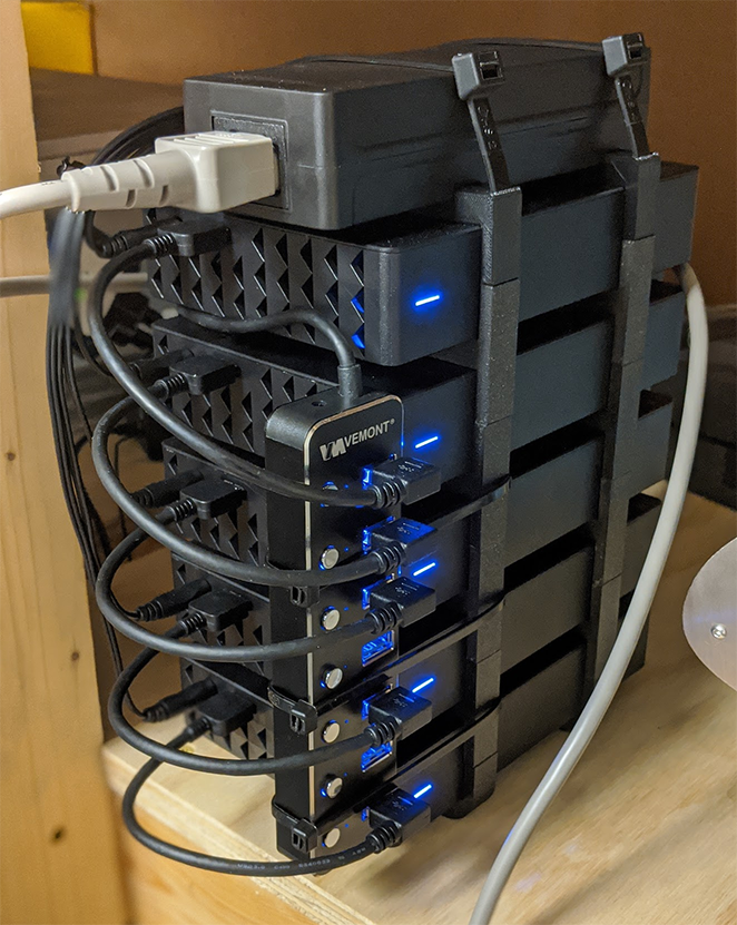

So I bought 5 external Seagate 16TB USB drives, which would give me an 80TB storage pool. I was able to buy these for $310 each, which was an amazing deal in the summer of 2020. I also bought a nice 7-port switchable USB hub, which allows me to connect or disconnect each drive at the press of a button, some short mini-USB 3.0 cables, and a more powerful 10A 12V power supply brick that output the correct voltage for these drives, plus had enough power for at least 7 drives.
I went the extra mile, and designed and 3D-printed some drive stackers that allowed me to use zip-ties assemble everything into a single stack for portability, while allowing for some airflow between the drives. I also 3D printed a small project box style enclosure to hide all the power connections, since I cut the power cords for all 5 drives and connected them to the single larger power brick.
Here's the end result:
It's not pretty, but barebones form follows barebones function.
Here's a link to the USB hub I used. It looks exotic and expensive, but it's actually a good value:
https://www.amazon.com/gp/product/B086S ... UTF8&psc=1
I can unplug the single USB cable and power cable, and carry the entire unit quite easily, and store it in a safe spot. When I need to do a backup, I plug the USB cable into my Unraid server, power it up, and sequentially press the buttons on the USB hub to do a manual staggered spin up from bottom to top (not sure if that matters, but it's what I do to ensure the drives always connect in the same order, in case that affects anything, and to minimize power draw on spin-up).

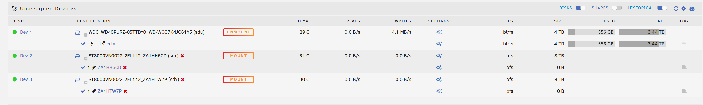

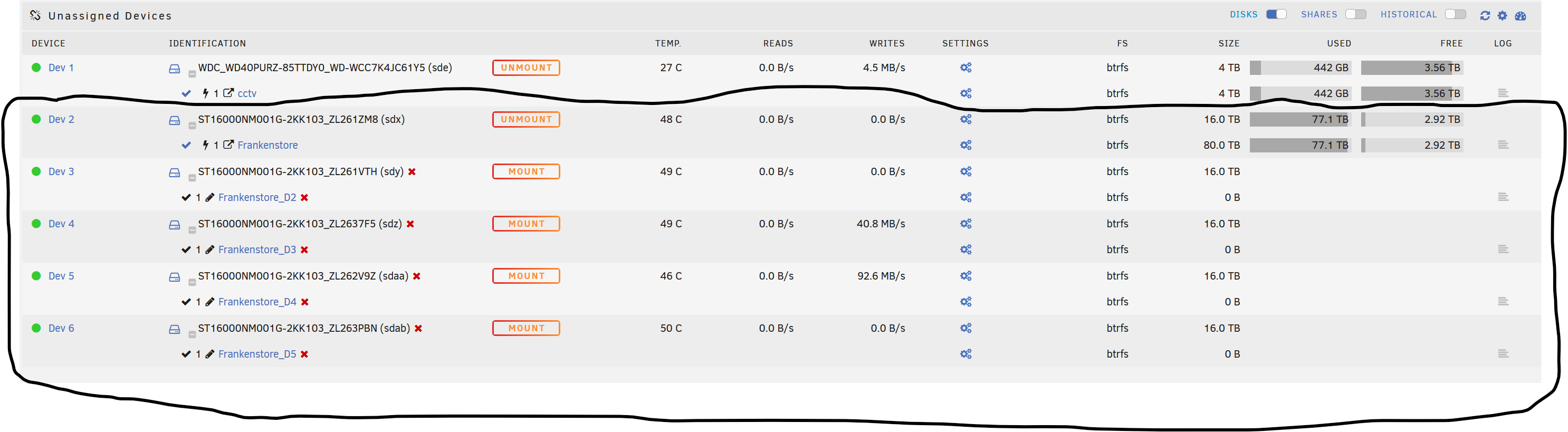

The drives appear in Unassigned Devices. The first time I had to create the pool manually, but now that always shows back up each time they are plugged in, so all I have to do is mount them.
You can ignore the first drive in the picture above, that's my 4TB video surveillance drive. Dev 2-6 are the 5 drives for my backup solution. I named the main drive Frankenstore, and then each additional drive with the drive number, i.e. Frankenstore_D2. The pool data lives on the main Frankenstore drive, so when I hit Mount it mounts all 5 together into the 80 TB large pool. When I'm done with the backup, I click Unmount, turn off the USB ports, and unplug for storage.

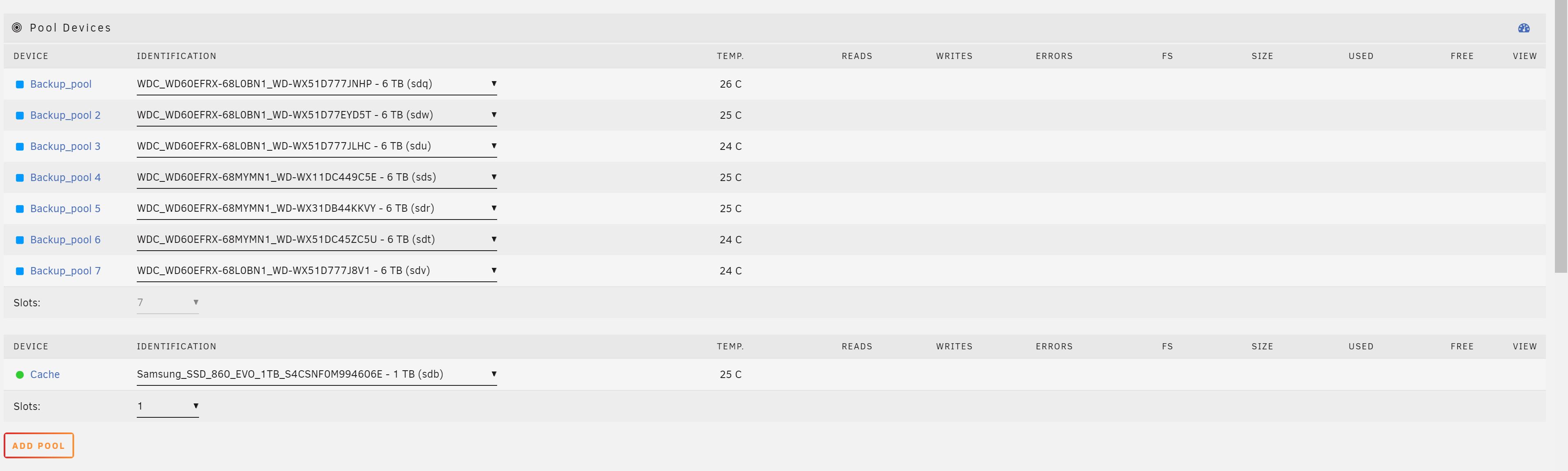

Even with the default file system set to xfs, whenever you create a pool with "Add Pool" in UD, it creates a RAID1 pool with btrfs. So for example if I create a pool with 7 WD Red 6TB, it creates a pool of 2x3 disks in raid 1, shows 18TB free and leaves one disk unused. One the main page, the pool is shown with a total size of 21TB and 3TB used.
Also even if this was to work, the pool is started at the same time at the array, so I'm not sure how happy it would be if the drives were disconnected when you start the array.
I couldn't find a way to select a different fs/disk layout either during or after the creation of the pool.

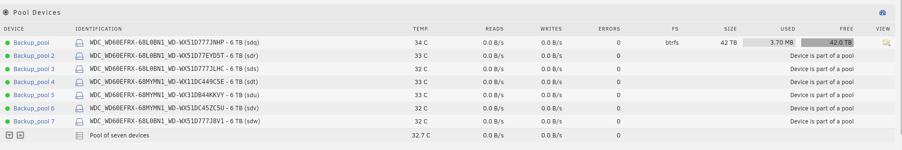

Actually I found the solution :)
If you click on the pool name in the main screen, it takes you to the settings.
In "Balance status", you can change the RAID level. I changed it to "Convert to single mode":
Balance status.JPG (89.5 KiB) Viewed 72982 times
and pronto, 42TB Free:
Full size in pool.JPG (190.31 KiB) Viewed 72982 times

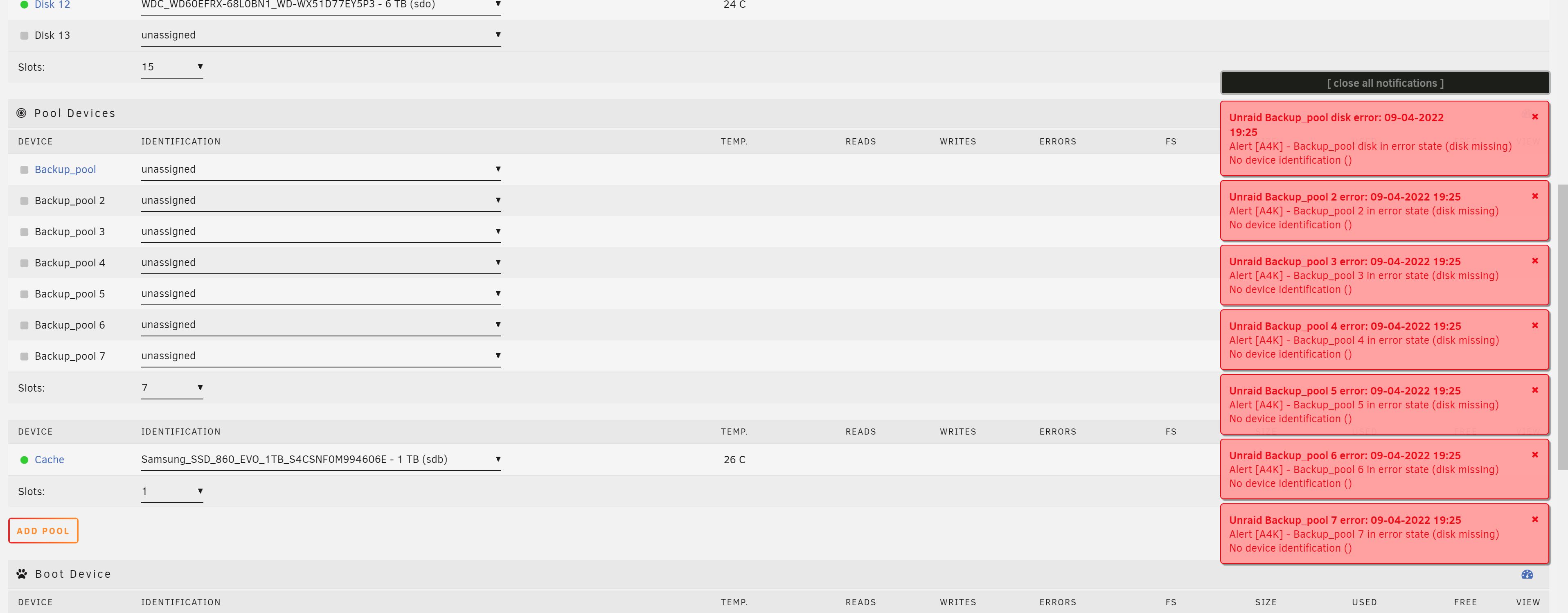

As expected, if you shutdown, take the pool drives out and boot, unraid isn't happy and reports them missing with big red warnings:
1. Boot without the pool.JPG (351.29 KiB) Viewed 72975 times
This is to be expected.
However, you can start the array as normal, as the array doesn't use the backup pool as a cache, and all is fine.
If you then shutdown, put the backup disks back (I put them all in at the same time, just to make sure that the disk order doesn't matter), and start the server again, all the disks are detected in the right order, and there are no errors. The disks look line this, with a blue square, so I was a bit worried as this is how they look when they are new and need formatting:
2. Boot with the pool or after recreating it.JPG (230.48 KiB) Viewed 72975 times
However, if you start the array, all is good / all the drives are green and the data is back, as expected, exactly as in the screenshot below.
So as long as you don't mind the big red errors when you reboot the server, that's not an issue. I use stanby so I would only see these errors once in a while.

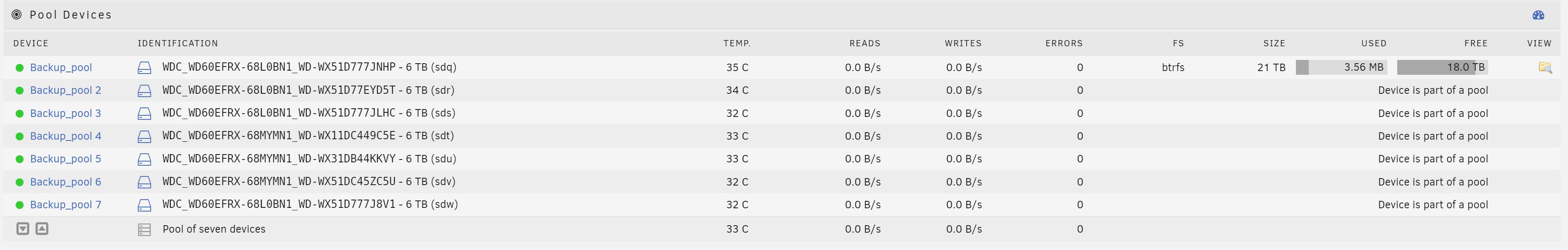

However, I wanted to go one server further, so I shutdown again, took all the disks out, rebooted, and and then I selected "none" for the pool disks, hence deleting the pool. I know, it's scary, but that way there is no pool so no errors. I wanted to see if I could get the pool data back if I recreated exactly the same pool.
So I shutdown again (not necessary, but I wanted to make sure nothing was in memory), put all the drives back in a random order, recreated a pool with the same name, and with the drives in the exact same order (in the pool). And bingo, the pool is recreated without formatting anything (it looks exactly as in the screenshot above), with all the backed up data back:
3. After recreation of the pool.JPG (227.3 KiB) Viewed 72975 times
So after your backup, you can safely delete the pool if you don't plan to use the backup for a while and are annoyed by the big red errors everytime you reboot. If you recreate the pool with the same name, same number of disks and all the disks in the same order, you'll get all the data back where it was.

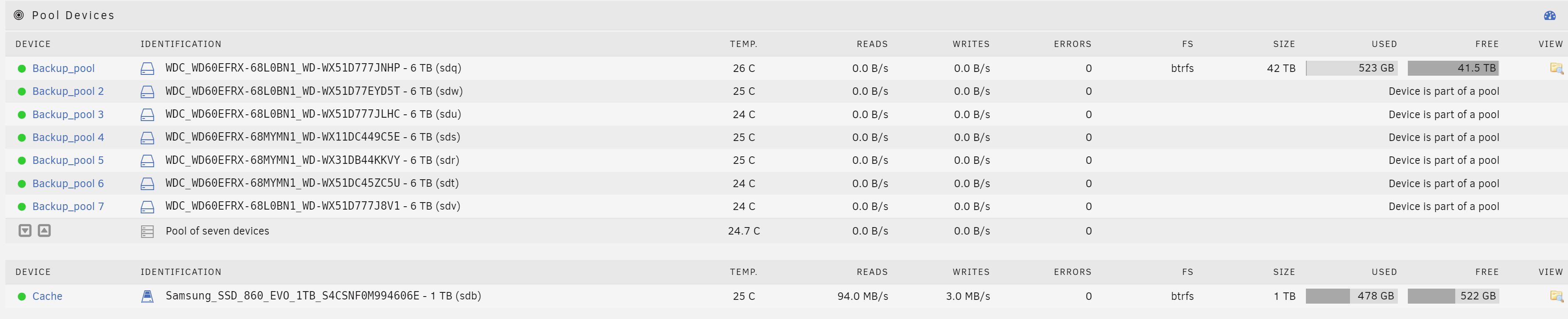

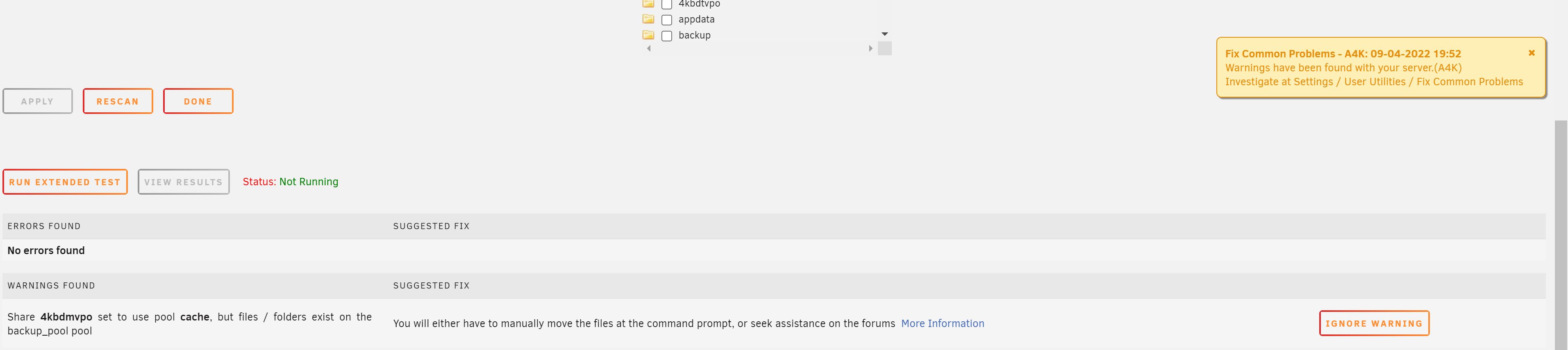

EDIT: one thing to be aware off, if you copy a share to the backup pool in the root, you're going to get an error like this from the fix common errors plugin (if you use it, and I highly recommend it):
Files detected on backup_pool.JPG (141.28 KiB) Viewed 72968 times
This is because the backup pool is supposed to be a cache, and the share I try to backup is supposed to use another cache, so I guess the plugin is confused. Maybe that's what caused the crash.
So for my second attempt, I've created a folder on the pool backup called backup_the_share_I_want_to_backup, and I copy the content of the share I want to backup into that folder to avoid this issue. I guess you could also avoid it by creating a single folder called backup and copying the shares you want to copy into it. I like the idea of a different folder, because I can select the files I want to copy and MC does it in alphabetical order (that's OCD me).
