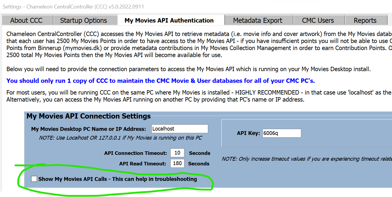

If you would like to do some more investigation first, then there is a setting you can turn on in CCC to show the API URL's: Settings > My Movies API Authentication > Show My Movies API Calls:
After enabling the above, repeat the Full Export test with "Demashitaa! Powerpuff Girls Z" in the filter box. The log output will now include the URL's that CCC is calling to access the My Movies API. Whichever call is last, right before the error, copy and paste that into a browser window on the same PC, and see what output you get (and feel free to share it with me). It will probably be some type of error message that the data can't be accessed or something like that.
