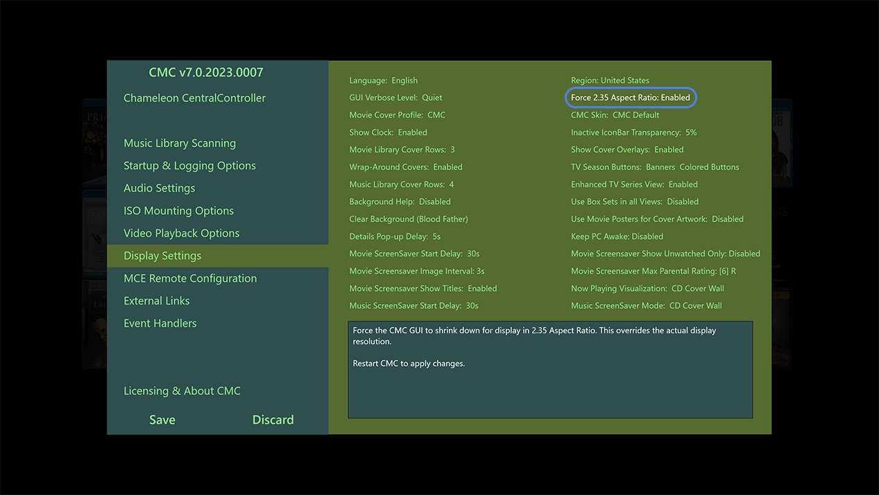

Sorry for the long delay. The next version of CMC, v7.0, will have an option to force 2.35 aspect ratio. This is configured in Settings > Display Settings > Force 2.35 Aspect Ratio:
The image above shows the effect as letterboxing on all 4 sides, as the GUI is shrunken down to fit in the reduced height. This will look better on a 2.35 screen, as there shouldn't be any black bars top or bottom, only on the sides.
Also note that the movie covers have always extended slightly off the screen on the left and right, so you will see this as the movies extend beyond the border and onto the black bars.
Hopefully the meets your needs. You can make it look better by setting the background to a black wallpaper, that way you won't notice the black bars so much in normal browsing.
