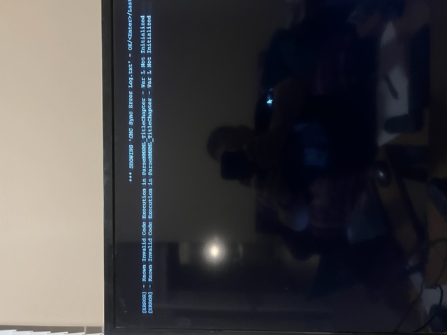

Update: sync finished, correct number of titles are showing in lower right, but it says there were sync errors. Not going to view them now, will look at the logs after seeing results.

On a better note though, I did not receive any access errors during the sync. Don't know if it's a cleaned MM database or new hard drive(NVME PCIe instead of Legacy SATA).

I'm happy to learn that you were able to sync without any access issues. If you want to continue using CME, then use the error log as a checklist, and fix each title one-by-one.
Alternatively, you can switch from using CME to using CCC. CCC looks very similar to CME, so it is an easy change. But it does a much better job of exporting data. For the most part, everyone should be using CCC now. You only need to use CME if you want to make your collection portable.
