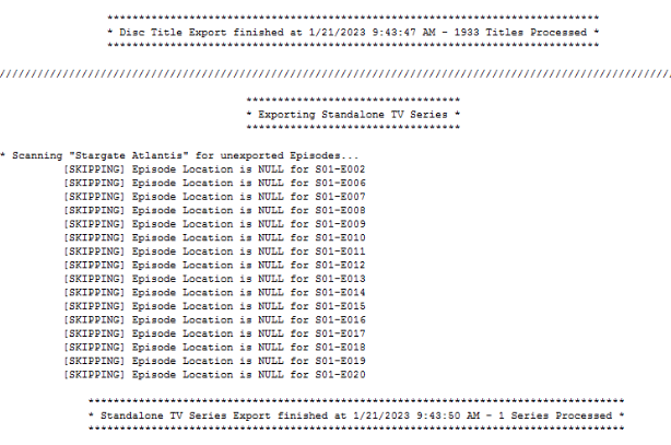

It appears that there is no entry for the disc even though the export doesn't see them missing. Episode 2 is missing since episodes one and two are in the same MLPS file. Is there a more detailed logging for the CCC export?

* Scanning "Stargate Atlantis" for unexported Episodes...
[SKIPPING] Episode Location is NULL for S01-E002
[SKIPPING] Episode Location is NULL for S01-E006
[SKIPPING] Episode Location is NULL for S01-E007
[SKIPPING] Episode Location is NULL for S01-E008
[SKIPPING] Episode Location is NULL for S01-E009
[SKIPPING] Episode Location is NULL for S01-E010
[SKIPPING] Episode Location is NULL for S01-E011
[SKIPPING] Episode Location is NULL for S01-E012
[SKIPPING] Episode Location is NULL for S01-E013
[SKIPPING] Episode Location is NULL for S01-E014
[SKIPPING] Episode Location is NULL for S01-E015
[SKIPPING] Episode Location is NULL for S01-E016
[SKIPPING] Episode Location is NULL for S01-E017
[SKIPPING] Episode Location is NULL for S01-E018
[SKIPPING] Episode Location is NULL for S01-E019
[SKIPPING] Episode Location is NULL for S01-E020

Your observation that the export doesn't see episode 1 as missing doesn't mean that episode 1 is properly mapped, it only means it was exported in an earlier CCC step. CCC tries to export episodes two different ways, with the 2nd way (shown in your screenshot) scanning for anything missed by the first method.
No, there is not a more detailed logging option, but there should be more info that what you showed. In CCC, type Stargate Atlantis into the text box, do NOT select TV Series only, and then run a Full Export. This should show everything that CCC exports for that show, including Disc Titles and TV Series. Then share that log data.

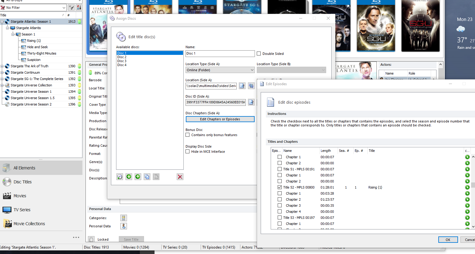

At this point, I would say the problem likely exists in My Movies Collection Management. You originally wrote that you mapped the MPLS episodes, but what I'm seeing is that this data is missing. Can you show a screenshot of MMCM showing at least one mapped episode? We need to first confirm the data really is in MM before further troubleshooting the export of that data.
