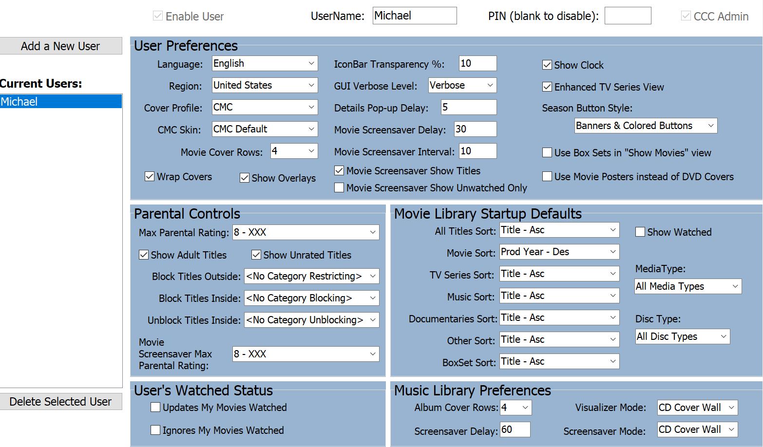

Attached is the user preferences settings from CCC. At first glance I don't correlate anything in these settings that might keep the screensaver from running.
Thoughts??
Thoughts??

I agree, that all looks good.
Just to double-check, your new install is connected to this CCC instance, yes?
