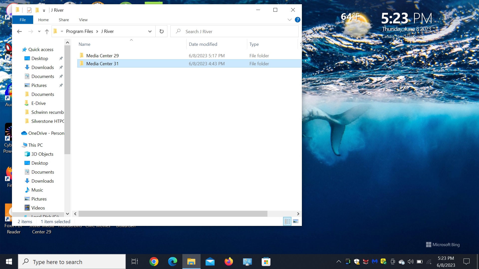

I installed Jriver 31 for testing today and it appears the cmc wants to play jriver 29 instead. I thought that the most recent "higher" version would play by default. Is there a way to have both versions installed with the higher version taking precedence? I would rather not uninstall 29 because if I need to reinstall it, I'll lose my license to 29.

I changed the "jriver 31" to "jriver 28" and 29 still comes up

I'll have to double-check the code, but I think I may have only programmed up to version 29 or 30. I didn't know 31 was out.
Also, what is the full path to 31?

C:\Program Files\J River\Media Center 31
This is the installer's default path.
