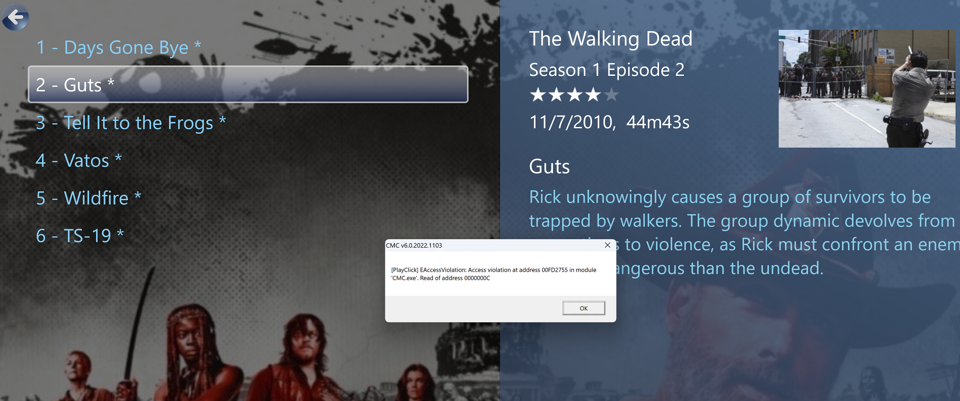

I'm not sure this is the same issue, because I'm only getting an access violation when trying to play TV Series. I use CCC.
Here is a screenshot:
CMC 1103 Access Violation (TV Series only).png (1.7 MiB) Viewed 8036 times
I was hopefult that 1103 would fix this when I looked at the log, but it didn't.
I tried playing different titles with different ratings, I also tried to select MPC-BE rather than jRiver, makes no difference, the error happens before the player actually launches.
My UHD Blurays play fine (with jRiver), it's only the TV Series.
The shares are online and the Dune plays them without any issue (using CM info with the MM integration).
Please let me know if you'd like me to send you a log. There is nothing to be noted, here is the content of playclick:

Re: Access Violation
Post by Pauven » Thu Apr 06, 2023 2:36 pm
Hey Manni,
I'm pretty sure this is a completely separate issue.
Can you turn off WoL and try again?
