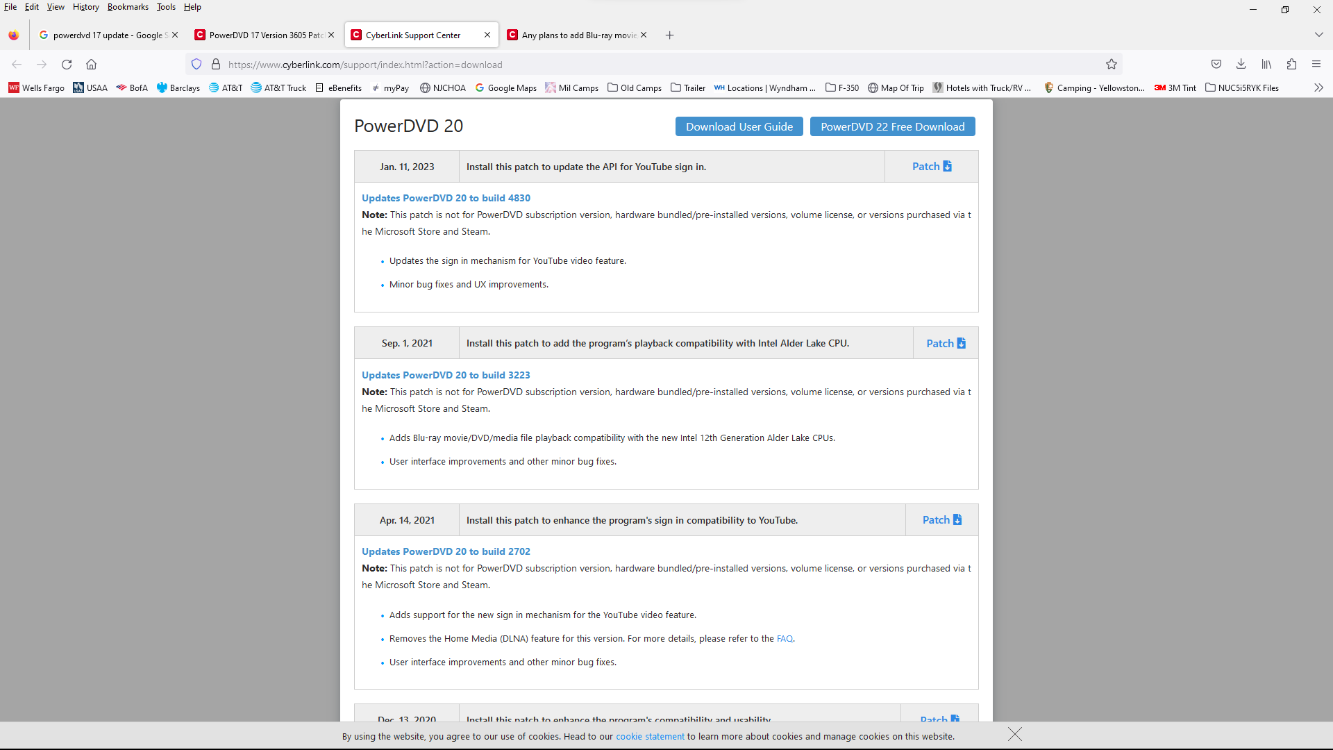

And finally, here is a screenshot of the updates for PowerDVD 20 (and available in newer versions) for 12th gen Intel support which was released in SEP 2021. The last update for version 17 was in JAN 2019, so it will not get the update.
Screenshot 2023-10-25 165144.png (96.85 KiB) Viewed 9554 times
That leaves me with shelling out big money for new PowerDVD for all the computers, or abandoning my support for them after some 15-20 years. There does seem to be better options out there anyway. Hopefully this helps new users in not spending money on something that doesn't work, or users migrating and unable to make their systems work due to older versions.
