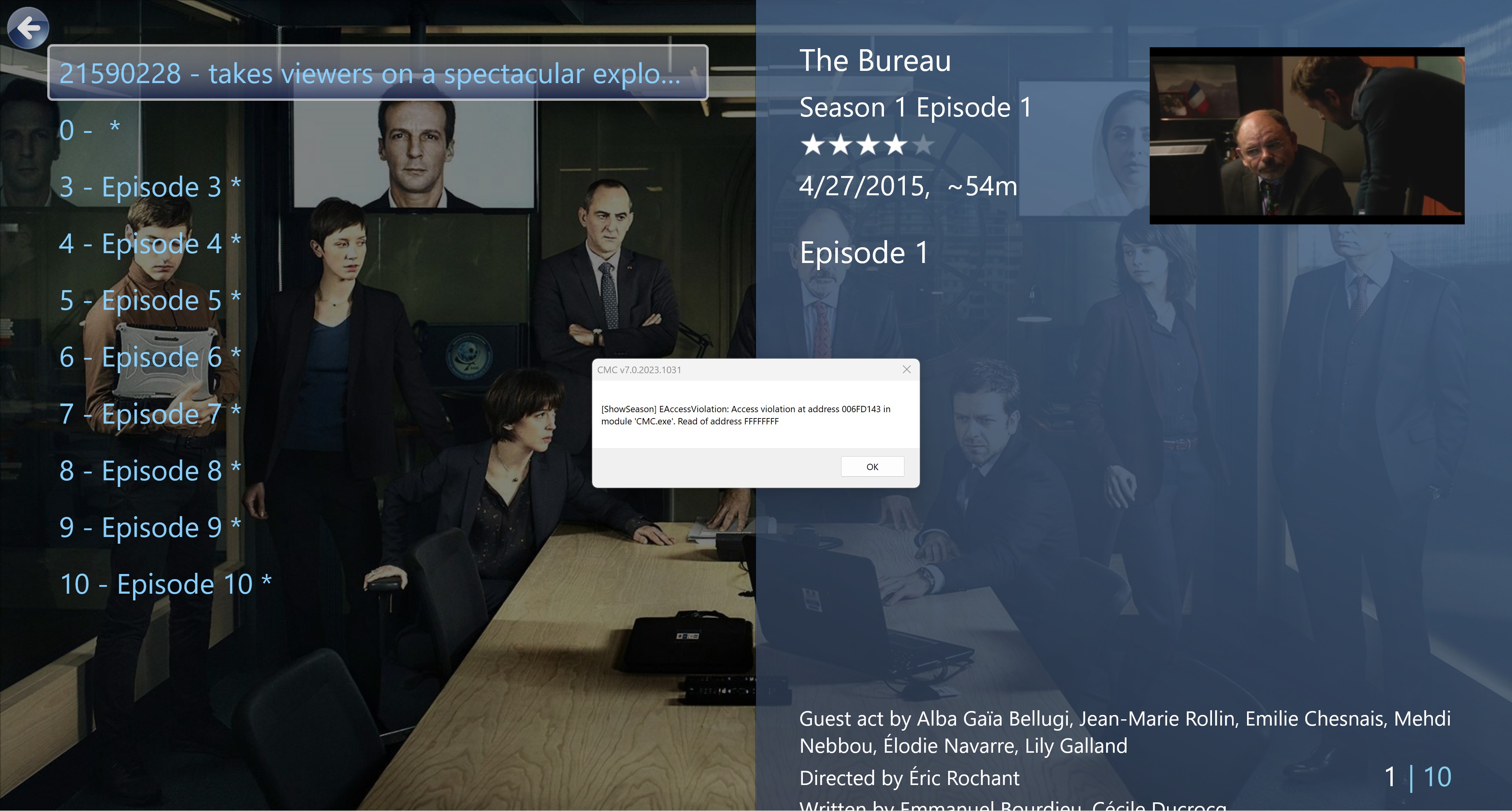

After watching episode 1, I got the following error message:
Error after watching episode 1.jpg (742.71 KiB) Viewed 29663 times
The episode list was garbled as well. I had never got that error before, and haven't seen it since when watching the next 3 episodes. [EDIT: I since got it a few times while watching episodes 5-8].

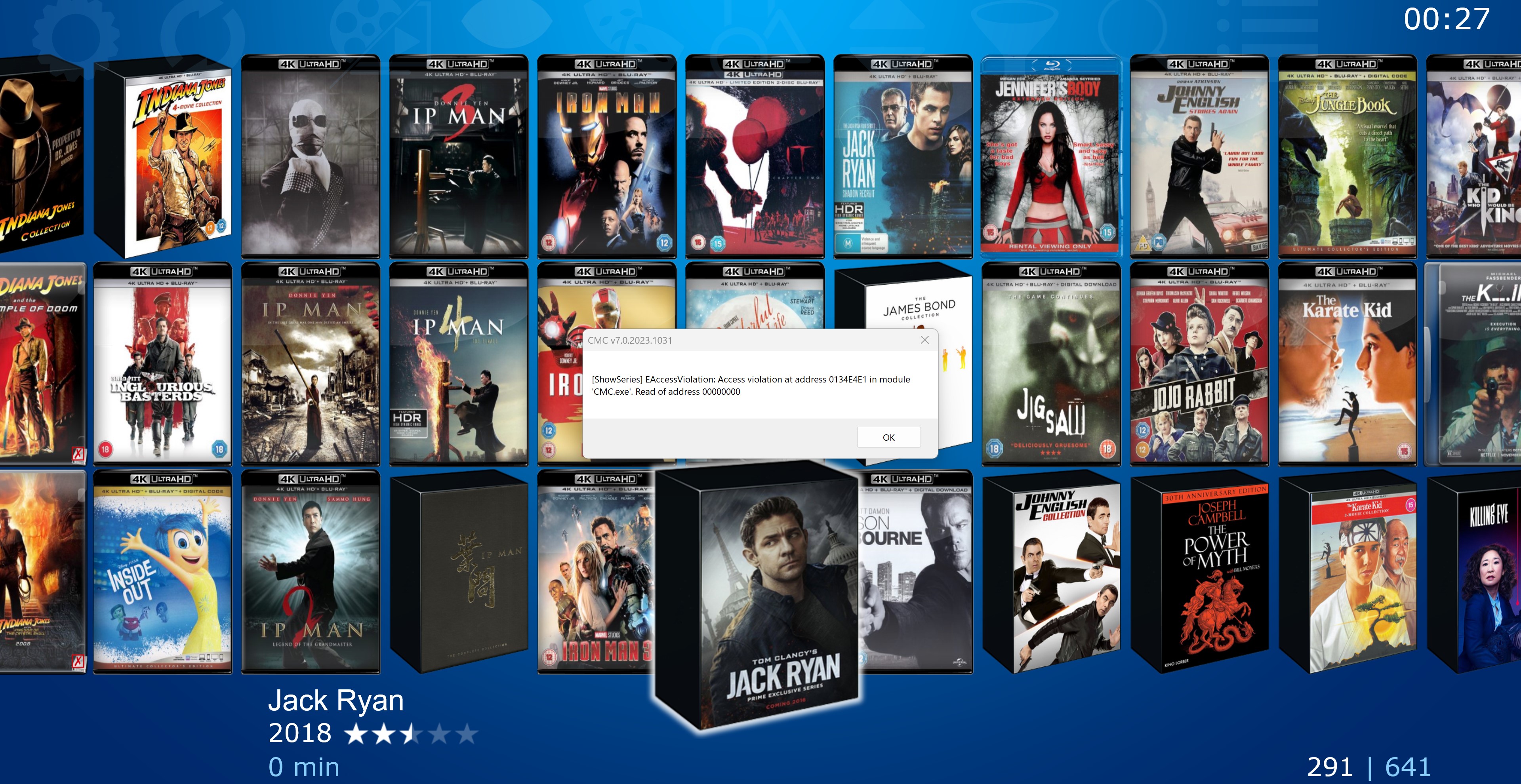

I also got an error after the playback of the last episode, after it returned focus to CMC and I tried to exit:
Series error after last episode playback.jpg (1.32 MiB) Viewed 29445 times

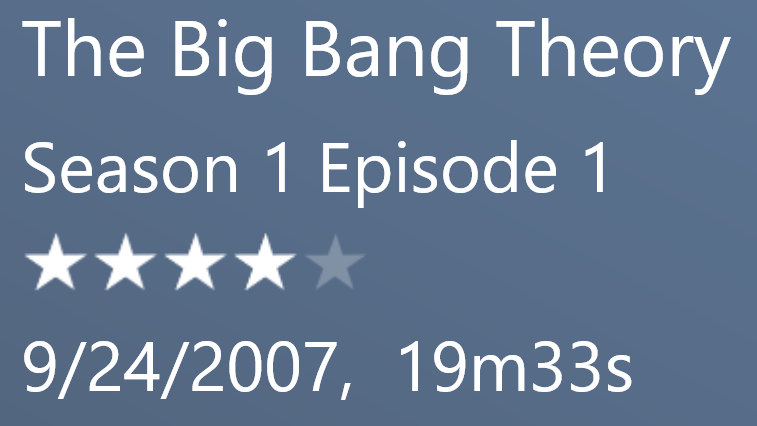

First, here's how the episode time should look when shown in CMC:
Notice it clearly indicates 19 minutes and 33 seconds.

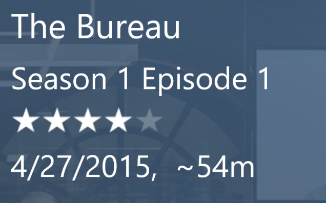

Next, look at how your Bureau episode length looks:
Missing the seconds isn't a huge deal, but that ~tilde in front, suggesting the episode is approximately 54 minutes, is bad. I don't remember programming a tilde to show, so that could be in your source data, or could be logic I've forgotten. And while to humans this is very readable, ~54 is not a number, it's a text string, and that would break my code that is looking for a number.

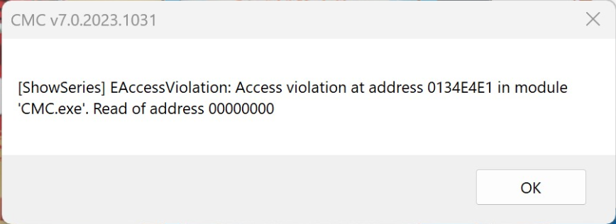

Regarding the on-screen error after playback:
That could be a side effect of a failed math result. And the failed math is that the episode's runtime was a text string, ~54 or maybe ~54m, in My Movies, and CMC tried to multiply it to get seconds (i.e. ~54 * 60 = ERROR), which totally freaked out CMC and caused the display issues and pop-up error in addition to the episode not being flagged as watched. But I would have to investigate more to be sure.

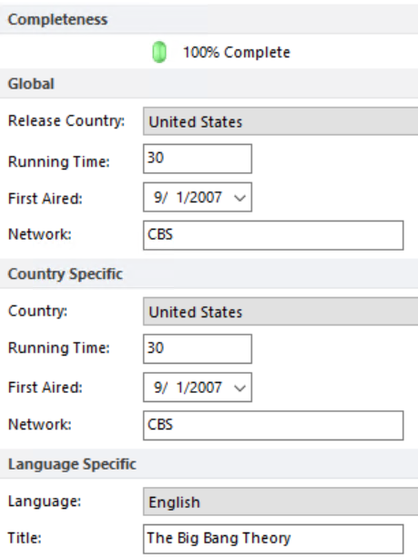

The next question is, where is CMC pulling the episode length from? I'm going a bit from memory, here, but for disc based episodes, the length is pulled from the disc data. So the 19m33s runtime for TBBT S1E1 came from the disc. Since you're using file based episodes, that data is missing. So I think the ~54 is coming from the parent TV series data. For example, here's TBBT:
Notice it says the runtime is 30 minutes, which more represents the timeslot with commercials, and not the episodes actual length.
Now, perhaps you have ~54 in yours, instead of 54. Or perhaps I have CMC defaulting back to the parent data when the individual episode value is missing, and perhaps I prefix the tilde to indicate this.
So what have you got in MMCM?
Posts: 2899
Re: TV Series episodes not always marked as watched and other errors
Post by Pauven » Fri Dec 08, 2023 12:08 pm
Double-checked my code for displaying episode runtimes:
        Runtime := MovieDB.Title[TitleIndex].Season[S].Episodes[EpisodeIndex].Runtime;
        if RunTime.IsEmpty then
          Runtime := '~' + MovieDB.Title[TitleIndex].SeriesInfo.OrigRunTime.ToString + 'm';
So, uhm... yeah. That tilde is all CMC, you won't find that in MMCM.
