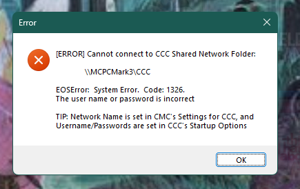

[Resolved] Error 1326 - cannot connect to shared folder issue
Post by p64imp » Thu Sep 12, 2024 2:03 am
Please see the above image... i get this every time i open CMC. It hits when it attempts to sync. Only thing is... when i dismiss the dialog it connects to sync just fine. In the settings under test connections with CCC and CMC, both resolve successful. It's just this annoying dialog that keeps bugging me every time i open CMC. How do i get this to stop? It seems the error is bogus as i have zero connectivity issues....
i'm running the 7.0 build.

CMC connects to CCC using 2 different methods.
It uses a direct messaging connection to send & receive the media database info, but this does not include any artwork.
And it uses a Windows Shared Folder to retrieve all artwork, like disc covers and fanart backgrounds.
The reason you believe the sync is working correctly is that the first method is working, so you are getting database updates. But the error is explaining that the artwork is not being updated. Since artwork gets copied locally by CMC, at first you may not even notice this issue, except for seeing the "?" covers show up for new titles (the "?" is the missing cover placeholder).
If you go into Settings > Chameleon Central Controller, you will see that there are 2 different connectivity test buttons, the second one testing the shared folder connectivity, and I expect that this will fail. So there really is an issue here that needs to be addressed.
Possible causes:
A) Shared Folder could be missing. On your CCC PC, you can close and relaunch CCC, and if the folder is missing it will offer to create it for you.
B) The user credentials for connecting to the share are wrong or no longer valid. This could happen if you changed a password, for example. To fix, in CCC you would go into Settings > Startup Options, and at the top there you would enter the correct password, and optionally change the user if you want it to use a different user account other than the one you are currently using yourself.
C) Possible shared folder corruption if you moved CCC or renamed its directory. If this sounds like your issue, let me know and I can help you fix. This is actually a Windows issue, it kinda freaks out if you change the directory structure that contains a shared folder.
D) Firewall issues. This is probably least likely, since CMC is reaching the CCC PC, so I'd focus on A and B first.
I know it may seem weird that you enter the username/password into CCC's Settings to fix CMC logging into CCC, but this really is how it works. When CMC connects to CCC using the first method direct messaging method to get the DB updates, it also gets the username/password you've configured. It then uses those credentials to log into the shared folder and grab the artwork. This makes it easier to maintain a whole house full of CMC HTPC's, you only have to enter the user/password info once, into CCC, rather than separately on every single CMC PC. But you also have to maintain it if there are any changes.
Hope that helps. If you need more info, please check out this link: 104 - Initial CCC Configuration

I actually fixed the issue looking at the debug logs from the autosync attempt.
I think what i was most confused with is the instructions don't specify client or server side with each step, so i was confused with where to operate with each of the steps.
I did as you suggested and went back through the inital setup guide realizing the password was stored on the server for accessing the server (seems a bit odd to me, how can a client hit the server if the client needs to use the authentication that is stored on the server behind authentication?)
I know there is more to it than i'm visualizing, but that's how my mind approached it, so i updated the creds on my client side which was invalid.
At some point my server updated the password, and that update did not get pinned in the CCC.exe on the server in setup options. When i updated the password here, the issue is resolved and auto sync, as well as sync on open, are showing my full collection now without error.
The second level of confusion for me is why full sync would get past this password block and sync pulling full library from the server. I know it connected and did not just revert to valid cache as the 150 movies i added yesterday show with full sync, so it would appear that full sync has different auth paths than the smart sync does...?
At any rate, i'm fixed, and i thank you once again :)
