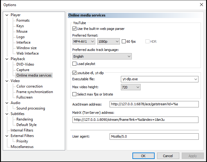

I updated one PC to MPC-BE 1.8.1 and it didn't make a difference. My "Online Media Services" page looks as was suggested previously:

UPDATE:
Apparently all my PCs were suddenly missing the required yt-dlp.exe file from the MPC-BE installation folders.
I've manually downloaded that file and added it and it's fixed this issue. Clearly I had it before; not sure what happened to lose it off all my PCs. Windows 10 Virus checking? Who knows.
