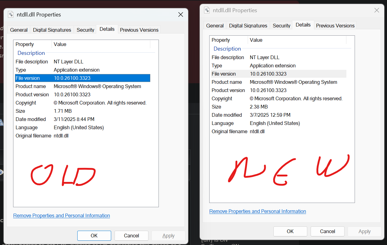

I did compare dll's and if it helps, and interestingly found the only diff is the file size. the version stamp on both is identical. see attached image.
OLD = my workhorse PC where CMC runs fine. NEW is my 395 where cmc is hitting the issue.

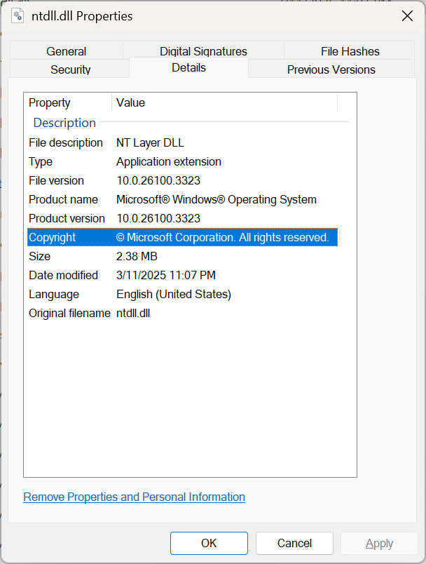

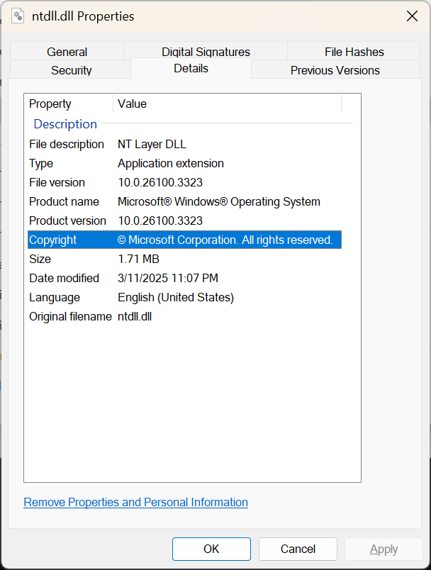

I think you may have accidentally compared the System32 ntdll.dll vs. the SysWoW64 ntdll.dll
My System32:
And my SysWoW64:
While our date stamps are ever so slightly different, it seems you're running a good version the best that I can tell.

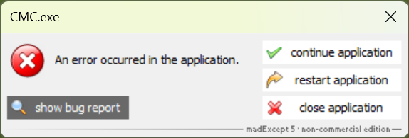

A note on using this MadExcept version: MadExcept will report all issues with a pop-up (can be quite annoying), for even the smallest things. For example, my CCC was busy doing a full export, and so I got a socket not available error, something CMC normally handles silently. But with MadExept, I get this:
Essentially, you'll need to hit Continue Application. Our goal is to replicate the total crash to desktop.
After a crash happens (or anytime you see that popup), a new file named bugreport.txt will be created in the CMC folder. That's what I'll need.
