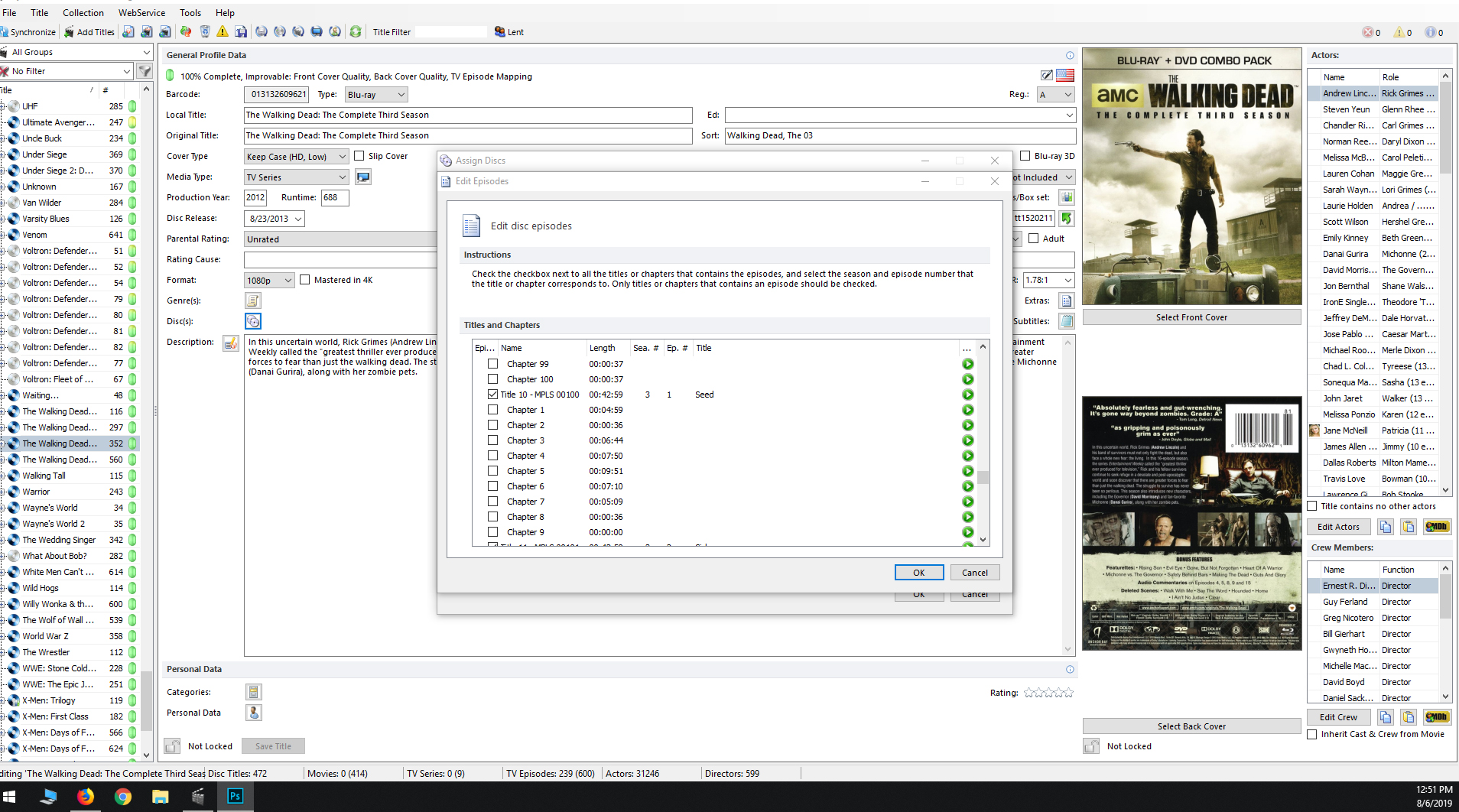

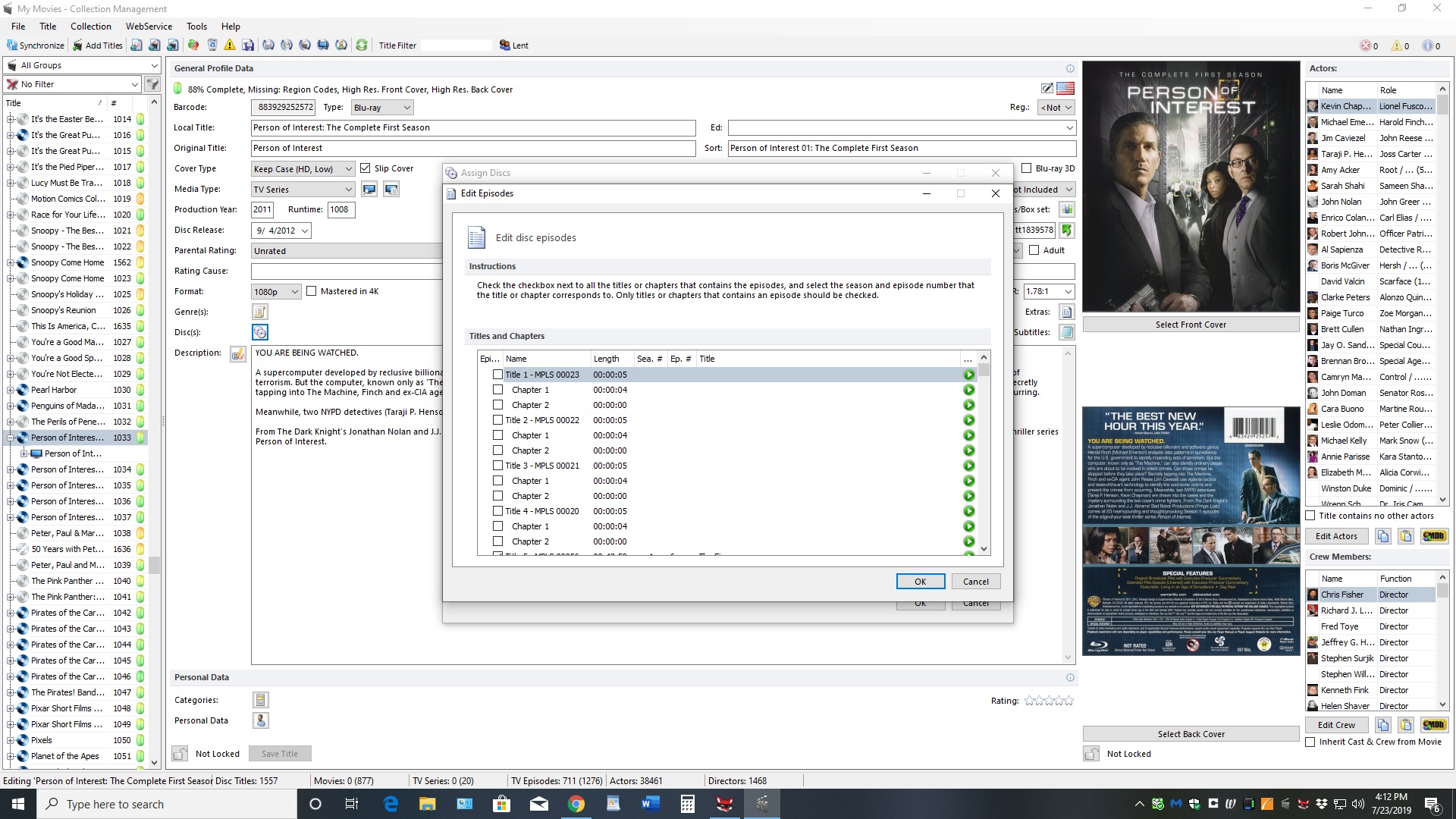

Do your disc titles in the disc mapping screens have the MPLS labels. See my screenshot for a reference.
If the MPLS labels are missing, you have to remove the discs and re-add them. This only occurs with bluray and 4k titles. DVD's don't need MPLS tags.

Re: Error During Sync
Yes, and they even are mapped properly. I just retested them.

1) a screenshot of the season 3 episode mapping in MMCM

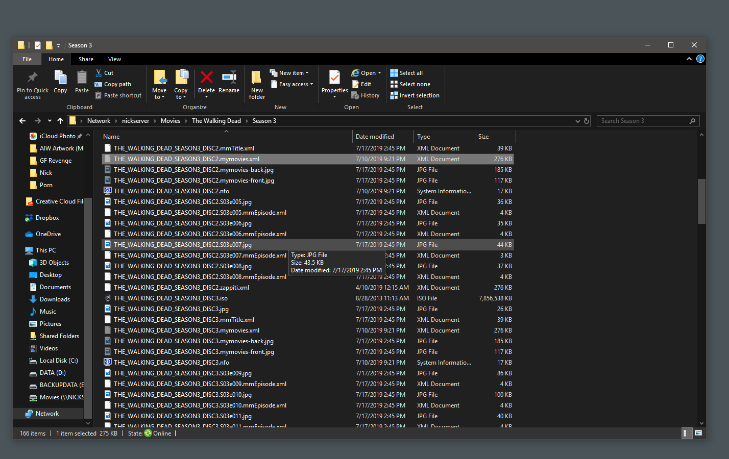

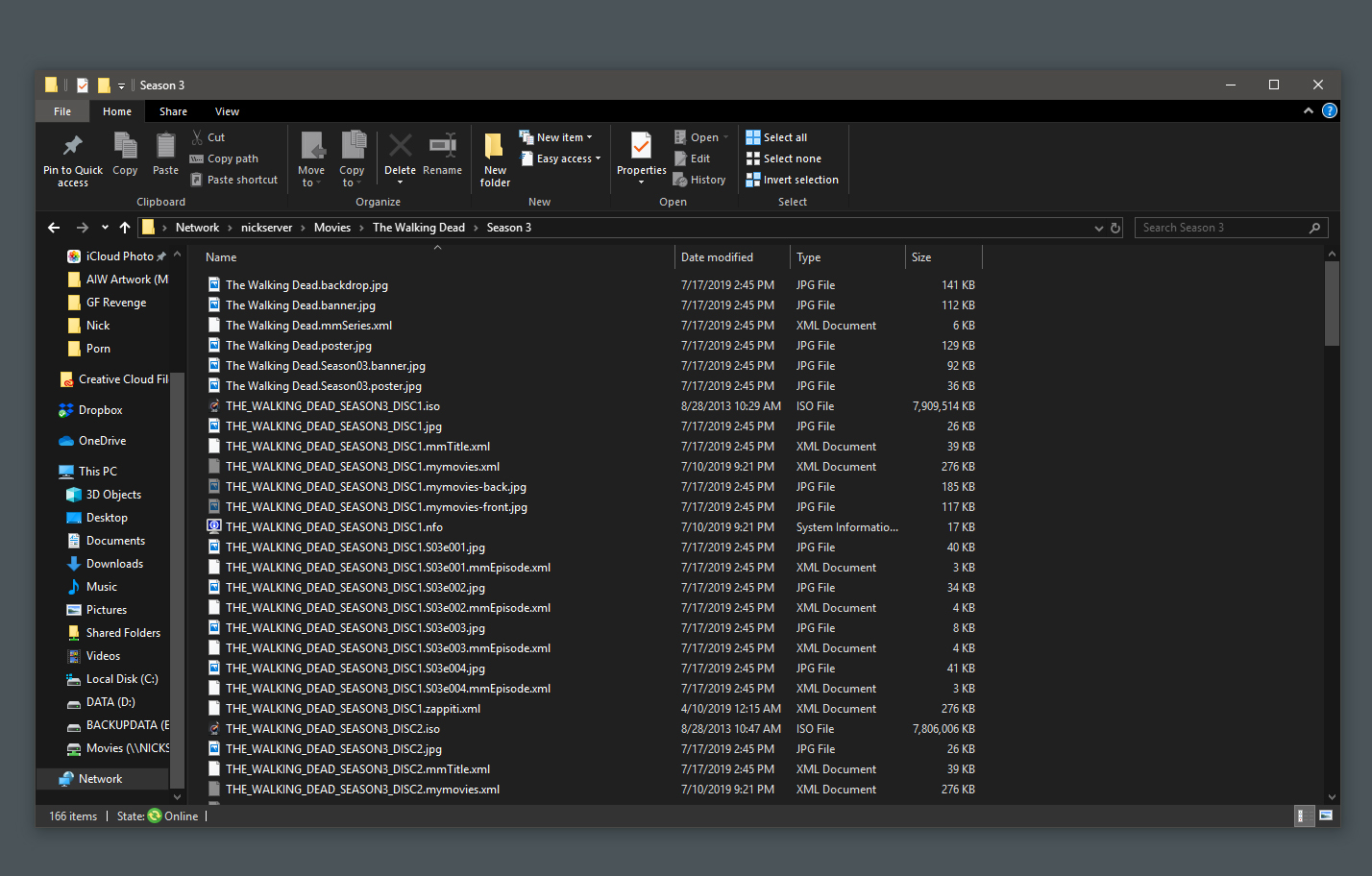

Sorry it took so long. I travel for work and have a 20 month year old so I haven't had a lot of time at home to reply. Here are the files. I only screen capped a few of the files in the directory but there's a lot as you can see the pattern.
I really need to see the mmTitle.xml files. Can you try zipping them up and posting, and if that doesn't work then email them.
