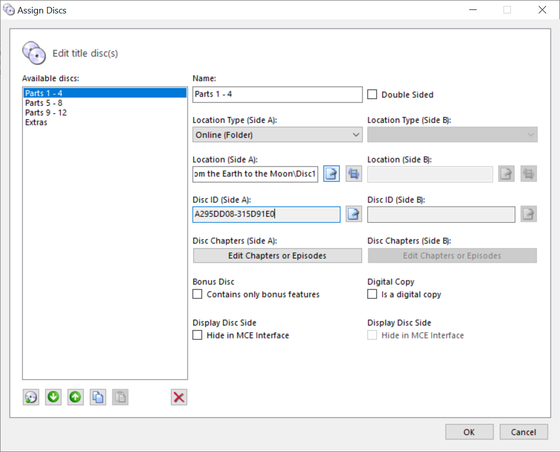

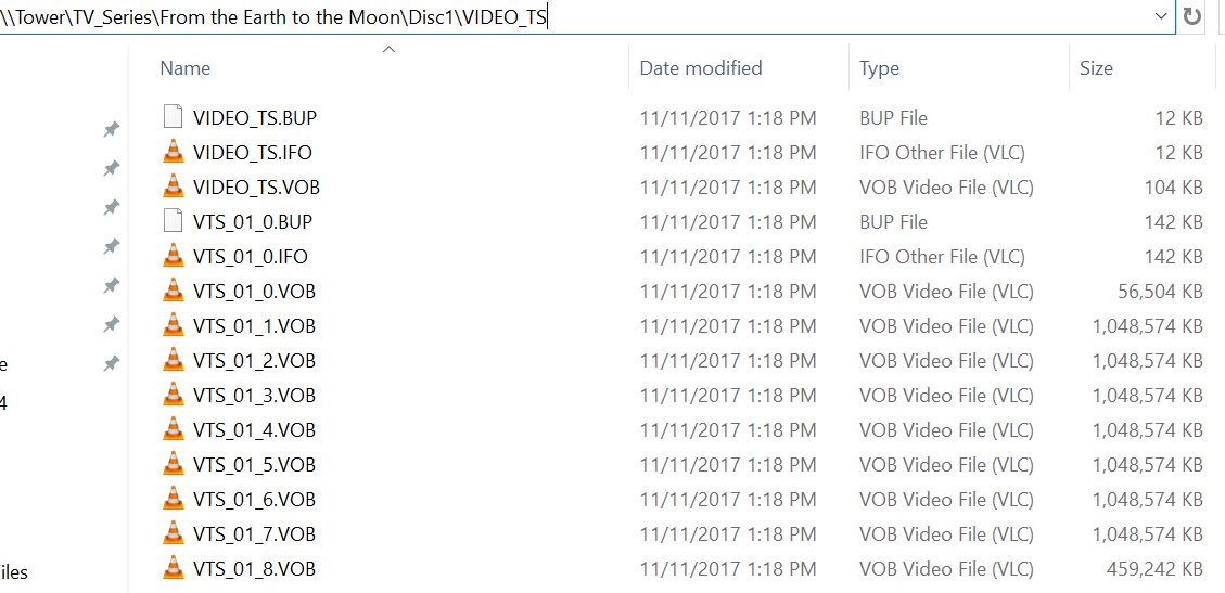

The structure you are describing, \Title\Disc\VIDEO_TS\*.VOB, is a standard DVD rip to DVD Folders. For example, here is one of mine:
When you add a DVD Folder to My Movies, it is best practice to do by configuring each Disc as an Online Folder, and point it to the Disc's root folder, like this:

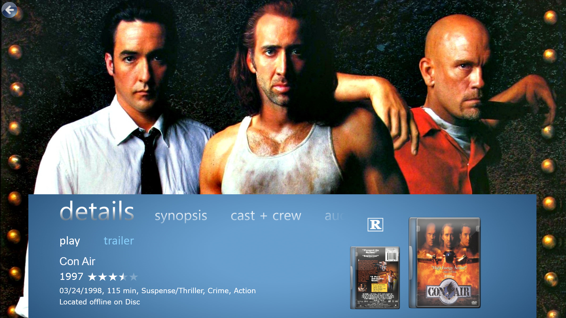

Perfect timing, I was just getting ready to reply. The problem still exists that shows the disc is 'Located offline on Disc' after I select a movie to play. I have been using the Full Sync method in CMC. I do use MyMovies to keep the catalog up to date and for exporting at this point. The file structure for the VOB movies is pretty simple now, everything is in the root folder of the movie (i.e. ConAir/All movies and XMLs).

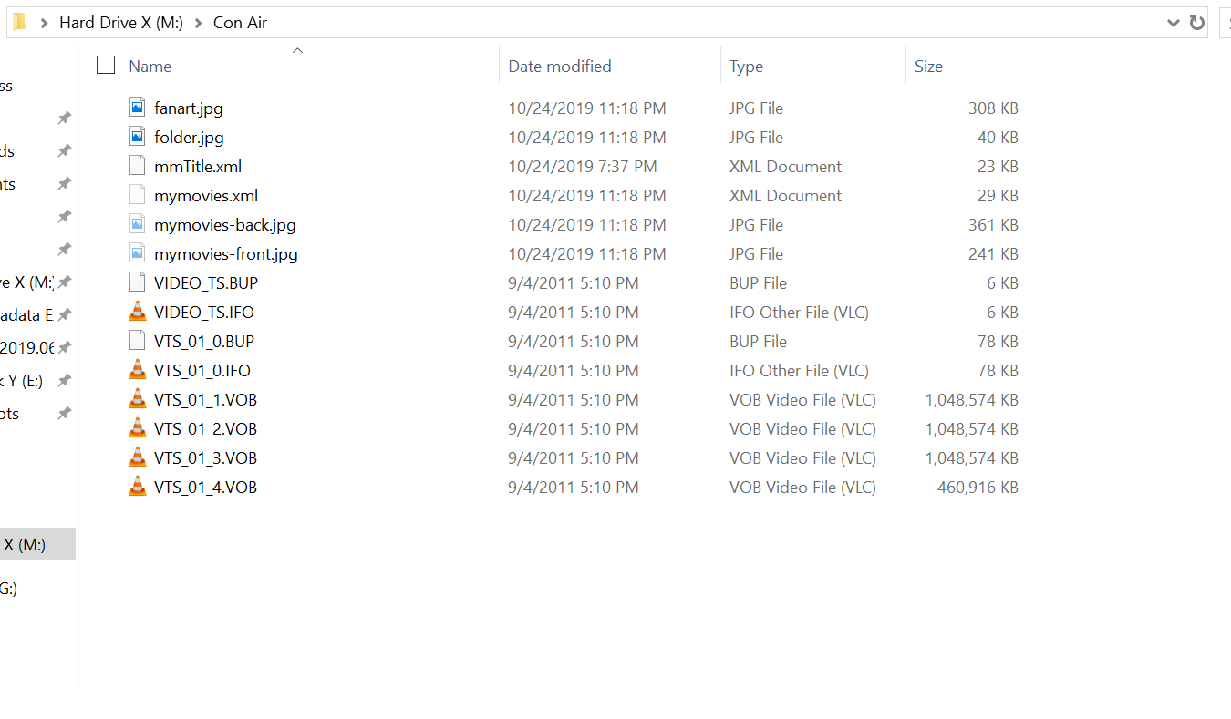

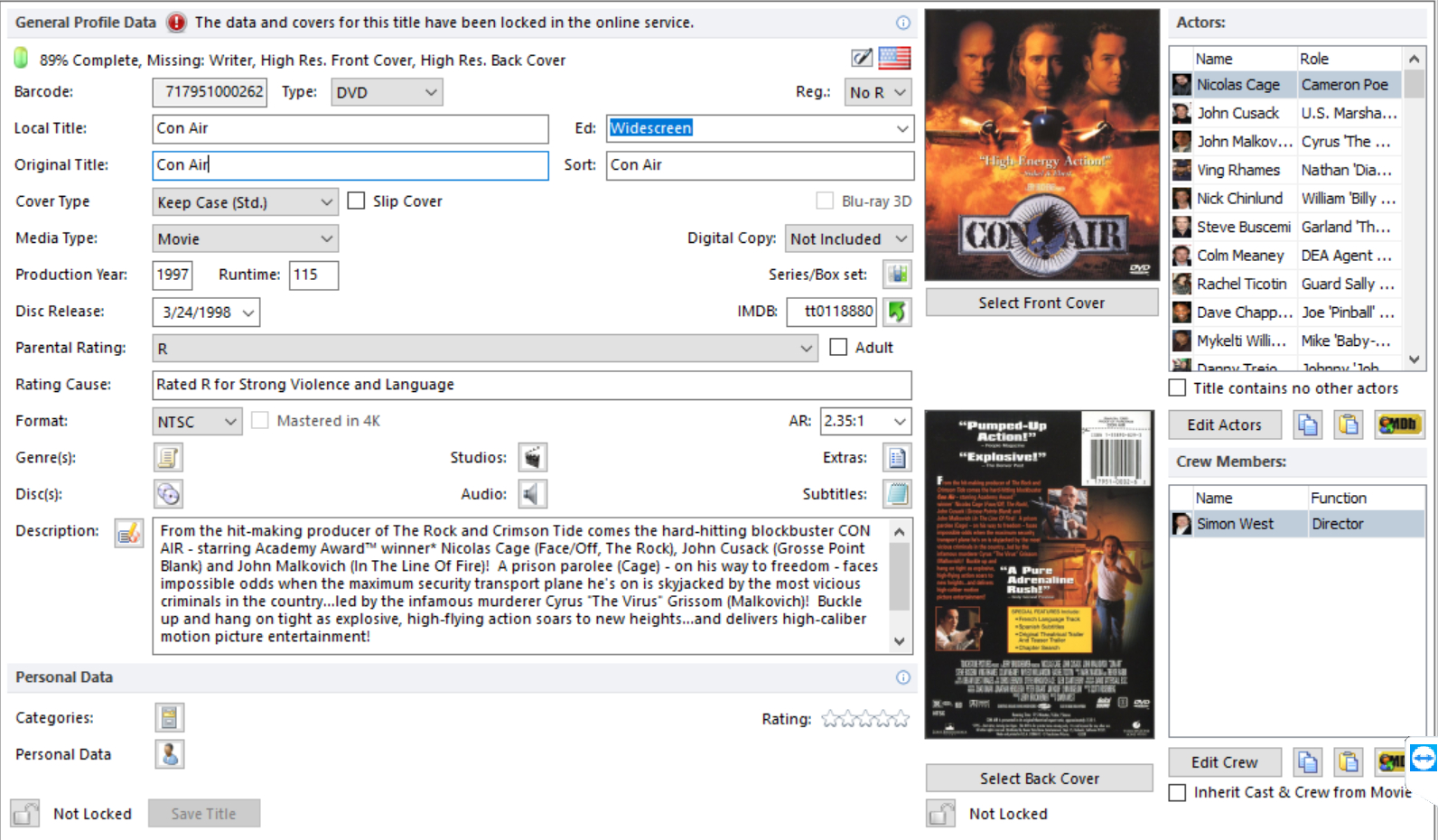

Could I ask you to share some screenshots? I would like a screenshot of each of the following (for one title only):
  • Disc Configuration (same as my screenshot above):
  • Windows directory of the same disc root (i.e. ConAir/ , but use same movie as Disc Configuration screenshot):
  • The same Title's detail page in CMC
Also, please attach the mymovies.xml file that's in the directory screenshot.

In your folder screenshot, I see both a mymovies.xml file, and a mmTitle.xml file. I didn't think you were using CME based upon one of your earlier responses, but since mmTitle.xml files are only created by CME, then I know that you are using CME.
Since you're new to CMC, a quick note on these files:
mymovies.xml files are created by My Movies Collection Management. Originally, CMC only used these files to sync all metadata, and will still use them if they are the only file present.
mmTitle.xml files are created by CMC Metadata Export (CME). The metadata files created by CME are better than the mymovies files (for various reasons I mentioned elsewhere on this forum), so when both mmTitle.xml and mymovies.xml files exist in the same folder, CMC will always use the mmTitle.xml file. By the way, I highly recommend using CME for the vastly better metadata.
Which brings us back to your screenshot. The mymovies.xml file has a timestamp of 11:18pm, almost 4 hours newer than the mmTitle.xml file which was created at 7:37pm. This probably means that the change you made in My Movies Collection Management got exported to the mymovies.xml file, but not the mmTitle.xml file. But since CMC is still using the older mmTitle.xml file, it isn't seeing the change.
Perhaps you didn't run CME again to pick up the new changes? After doing the first full export, CME is designed to be run in a changes only mode, so it is very fast to export (sometimes faster than My Movies Collection Management!!!). But you do have to run it so it can do its thing.
From this point, you have a couple options: 1) Run CME and let it update the mmTitle.xml file(s), or 2) Delete the mmTitle.xml file and let CMC resort to using the mymovies.xml file.

Ok, I get what you are saying with the differences between the XMLs. I did a bulk delete of all the mmTitle.xml in all folders in my entire collection and re-synced the database in CMC. The movies are still saying 'located offline' when I select a movie to play.
