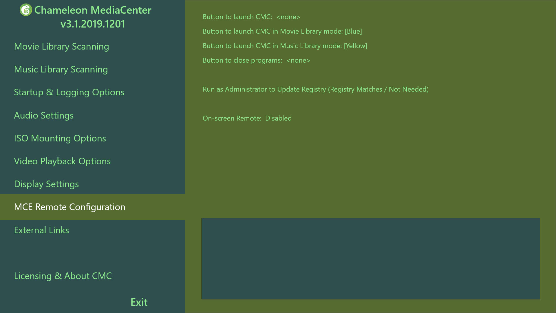

Hi
Please find attached MCE Config page, thanks
- MCE Config.jpg (166.58 KiB) Viewed 11020 times
Re: Remote Hot keys
Hmmm, I'm a bit confused.
You say that CTRL+ALT+8 works, but that is not configured here. Perhaps you configured it earlier and have since changed it?
ALT+F4 is a default Windows hotkey, so that always works. You simply did not configure an MCE remote button to link to it. I assume you are manually mapping ALT+F4 using your Android remote.
Just to be sure: did you reboot Windows after applying the new configuration?
You can also enable Debug Logging, and start CMC with Admin rights and run the registry update again. It will log what is going on, so that can help troubleshoot.
