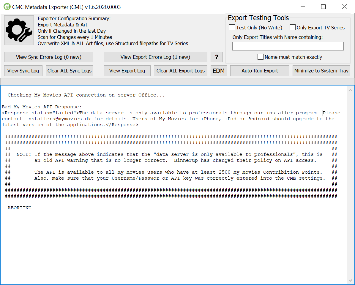

I changed the program settings again and discover something new. Now, the program response with different error message. Something like API is meant for professional. This part not quick understand.
Kindly refer to attachment for better understanding.
Different Error message.
Annotation 2020-06-07 225236.jpg (159.52 KiB) Viewed 35761 times
Re: CME v1.5 is freezing everytime I run the test
Post by Pauven » Sun Jun 07, 2020 11:05 am
Binnerup requires you have to have 2500 My Movies Contribution Points to use the API. Based upon that response, I would say you don't have enough points.
That API response message is out of date, Binnerup really should have changed the wording. You don't have to be a professional, you just have to have 2500 points.

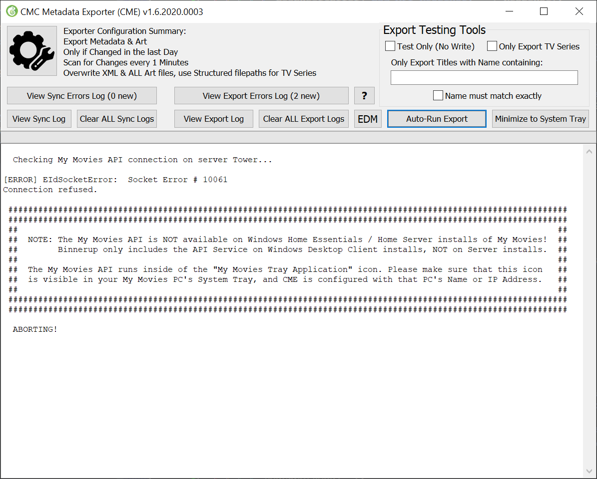

I have learned from your experience and made a few improvements to the next version, CME v1.6.
CME v1.6 will do a quick connectivity check that should indicate an issue in under 5 seconds, versus the 3+ minutes you were experiencing.
If CME doesn't find the My Movies API, the following message is shown:
And if the My Movies API responds with a failed status, CME will show this message:
Hopefully those two messages will help new users get CME up and going faster and with a lot less confusion.
I've also fixed the issue where the buttons don't work after a failed connection, which was really bad if a user configured CME to Auto-run on startup, as you couldn't access the settings anymore to fix anything.
