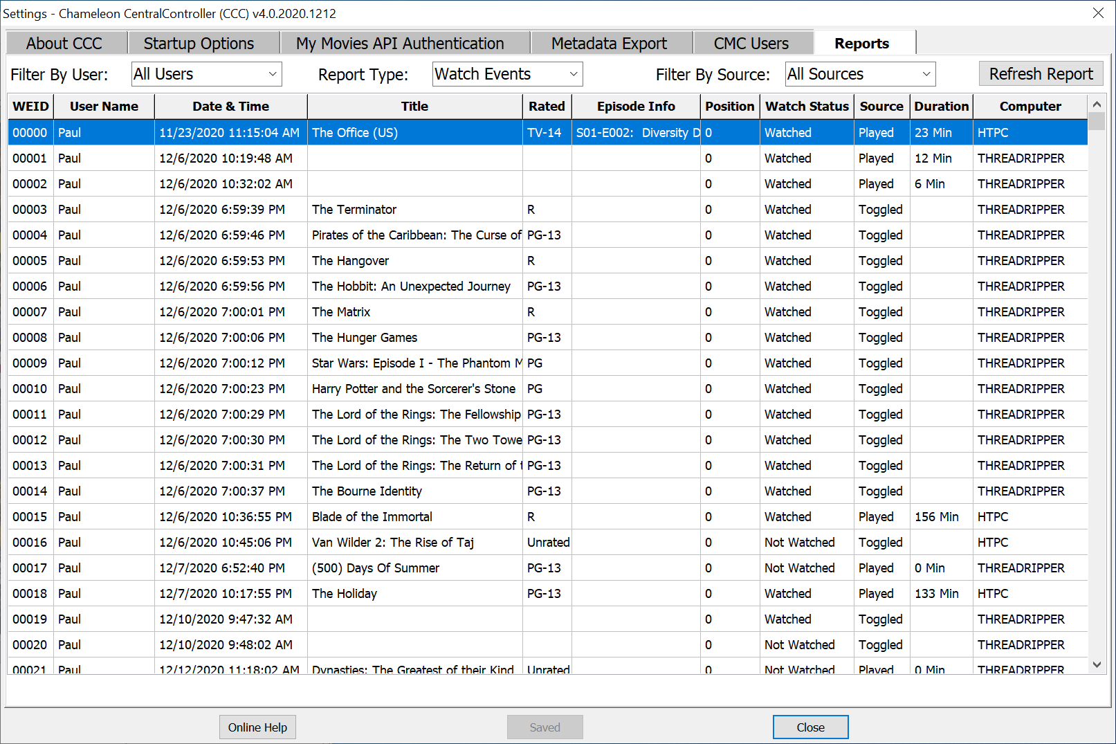

If you would like to see this data, in CCC you can open Settings and select the "Reports" tab:
There are several filtering options at the top, allowing you to view data for a particular user, switch between the Watch Events and WatchLists data, and for Watch Events you can select the Source (Played or manually Toggled).
Even though there is a "Refresh" button to manually refresh (you can watch new data stream in from CMC), every time you change any of the options the report automatically refreshes.
All of the columns are sortable, and clicking a second time reverses the sort direction.
Additionally, when you select one or more records, an option to "Delete Selected Record(s)" will appear at the bottom.
