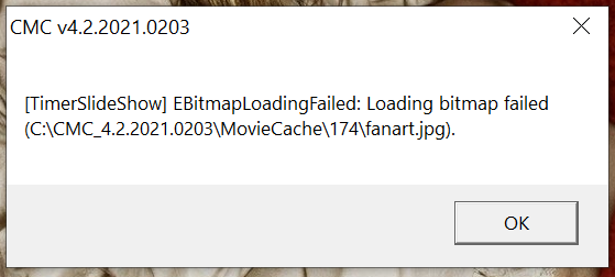

Welp! It happened again. After the error occurred, I did a full sync to see if it might pop up again after a full sync. Take a look and see what you think it might be.

Take a look in C:\CMC_4.2.2021.0203\MovieCache\174 to see if fanart.jpg exists - I think it does and is most likely somehow corrupt. You should be able to tell what movie/show ID 174 belongs to.
You can force a re-export of that movie with CCC (type in the name in the text box and do a Full Export, and it will append).
If that doesn't resolve the issue, then you may need to go into My Movies and see about replacing the artwork. I've come across (and reported) bugs before where My Movies fails to convert artwork from one codec to another, and it might be that this artwork is not a JPG, and somehow got into their system without being converted to JPG.

I took look inside folder 174 and fanart.jpg does exist. I logged into my server and re-exported Fearless (yeah I'm a Jet Li fan. Also a Donnie Yen Fan) and had CMC do a smart sync. I was able to open the jpg and view it with windows photos before exporting, but that doesn't mean that it's not corrupted. Now I'll just have to wait and see if it displays without CMC throwing a error.

Some apps, and I believe Windows Photos is one, will still display an improperly named file. You can right click it and check the properties, the details might reveal it's a different format.

I had a few more pop up with two different movies for fan art and covers. I think what might be the problem is I had to reboot the htpc a few times when I was trying to get everything running. CMC would sometimes do a download of the movie cache when it started, and I had to do a reboot in the middle of it. None of the titles had this problem before the upgrade. I’m continuing to watch it. I did a full export again and then a full sync, and those two titles appear to be fine now. It’s not the end of the world. It’s just annoying. I think it will eventually sort itself out.

If possible, it's best to let the JPG artwork syncing finish before exiting CMC or rebooting. Sounds like that might have been behind these recent issues.
When I first released CCC, I had low confidence in it's ability to accurately stay in sync, which is the main reason why I configured it to do a full refresh weekly. Ironically, that seems to have caused more problems than it solves, because unless that full export goes perfectly, you end up replacing a good export with a bad one. Add in the fact that the full export forces a full sync to each client, and you've doubled the opportunity for issues to creep in. And in return, the users get somewhat inconvenienced waiting on a full sync to finish, especially the artwork.
After I fixed a few export related bugs in CCC v4.1 & 4.2, I've personally changed over to only doing a full refresh monthly, and so far I've been pretty happy with it. I'm planning to make this the new default for CCC in a future version.
Next I'll probably try turning off my scheduled full export altogether. While on occasion I've seen scenarios where a full export fixes issues, I'm hopeful that I've exorcised those demons and perhaps it's no longer needed, as least not on an automatic schedule, just manually as-needed.
