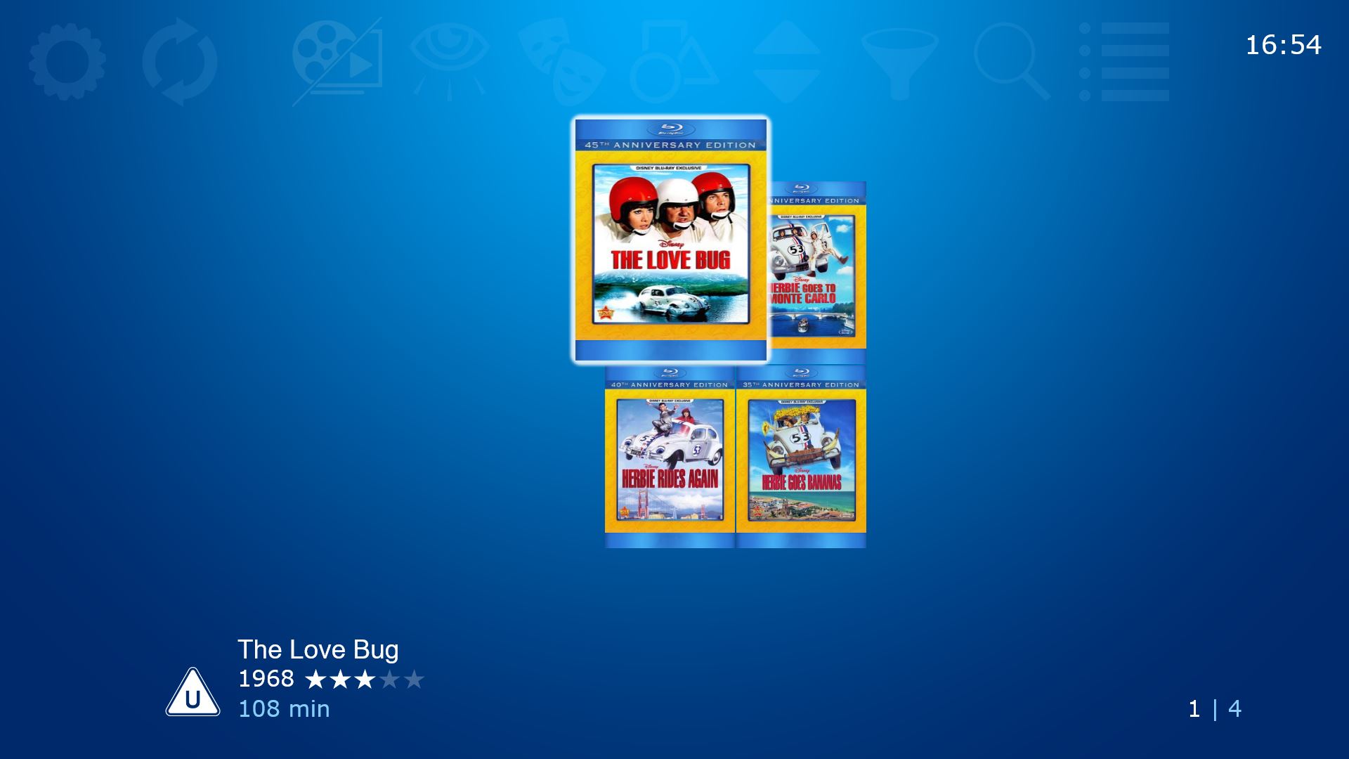

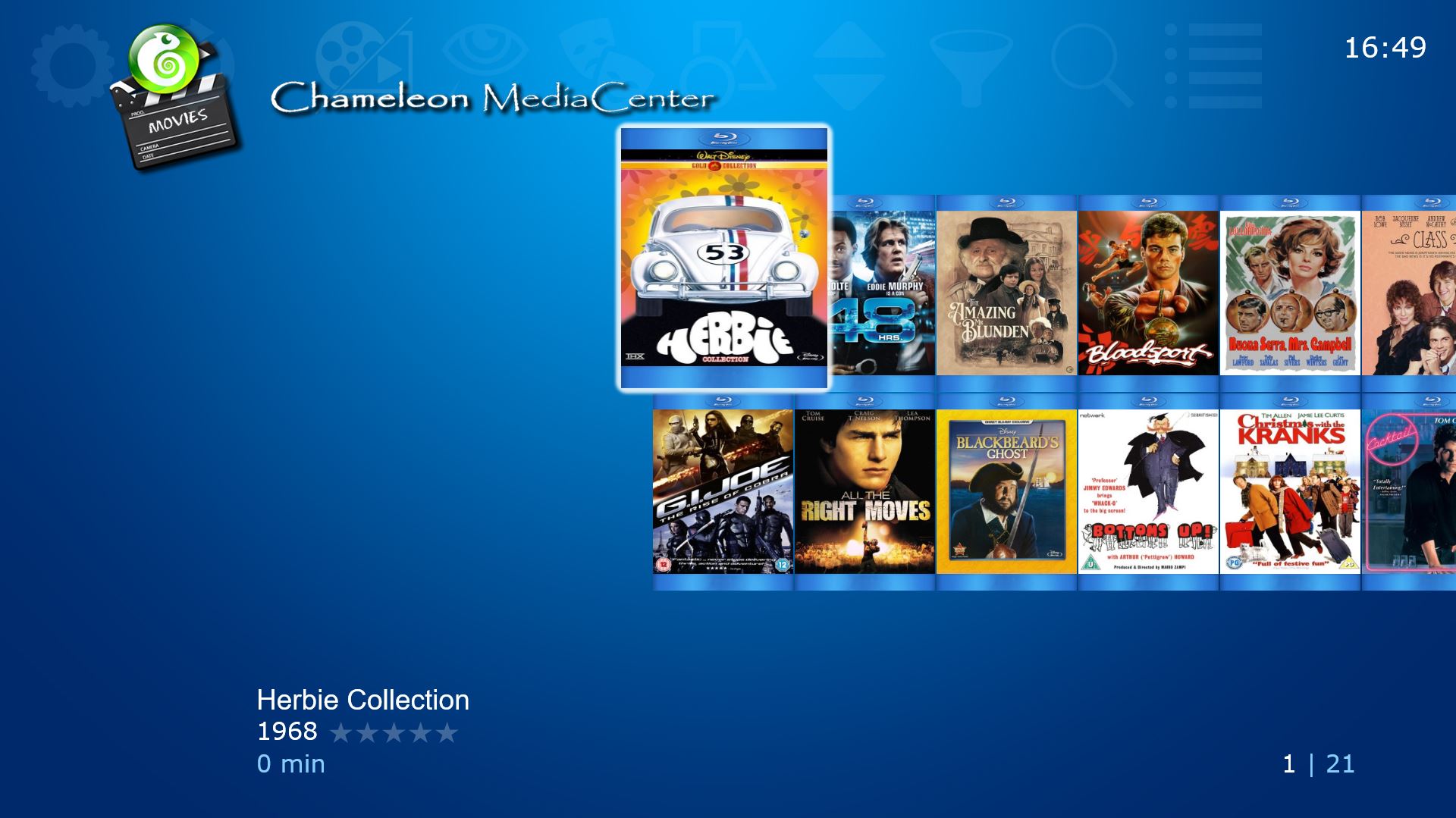

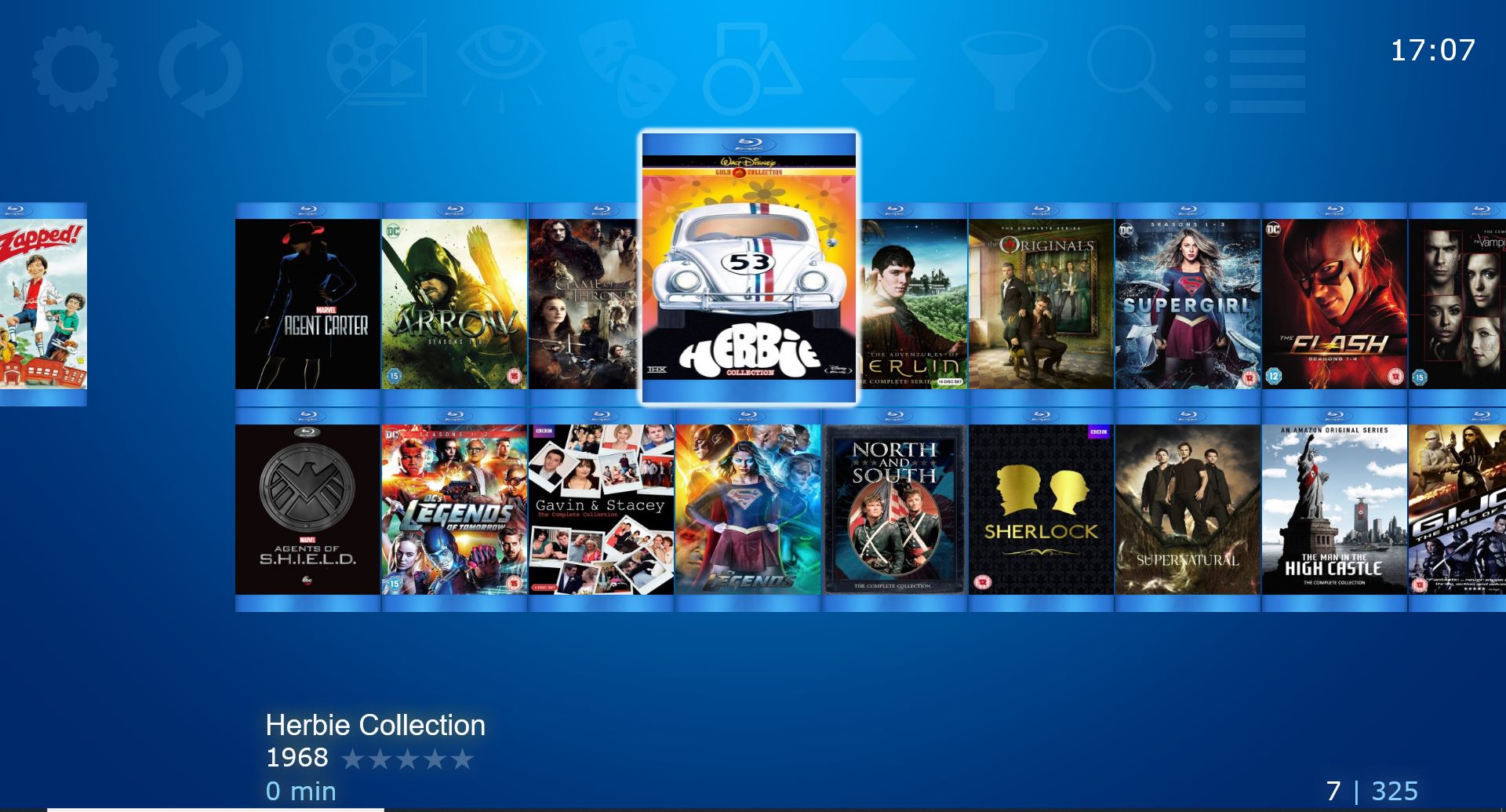

Any movie boxset is okay in Movies and All Media (example Herbie IMG 006) But if I change this box set to Documentary or Other Media it is not displaying as a box set just individual titles (IMG 007) but is still a boxset in All Media (IMG 008). The point I am trying to make is if for example if I made a home movie boxset and put it in other media it will display as individual titles instead of a boxset.
