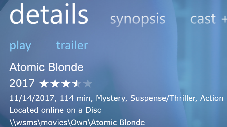

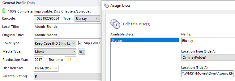

I am not sure if this provides any further evidence of the weirdness and possibly where things are amiss but here are some screenshots from the new HTPC (MCPC named) that is also exhibiting some issues. Even though MyMovies Collection Management is configured for Atomic Blonde to have a file path to \\wms1\movies\own\atomic blonde the cmc_moviedb.xml file and the movie itself in CMC both show the path to the old server share \\wsms\movies\own\atomic blonde.
MyMovies Collection Management config for Atomic Blonde

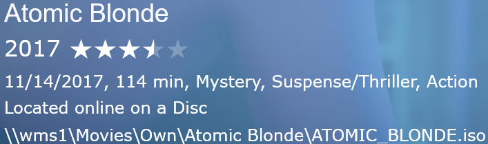

As a test I changed the new HTPC (MCPC named) to use folder scanning and import the .xml files from MyMovies. When I did this I verified that Atomic Blonde now shows up with the correct share path to the file and that the cmc_moviedb.xml file reflects the correct share path.
CMC screenshot of the corrected share path for this title

Now when I revert this HTPC (MCPC named) back to using CCC for importing all of the titles the issue reappears. The share path shown in CMC for the title Atomic blonde is back to the old path \\wsms\movies\own\atomic blonde and the cmc_moviedb.xml file is showing the old path as well.
Correct me if I am wrong but this tells me that CCC has incorrect information even though it is supposed to be pulling from MyMovies Collection Management which has the correct file path for the network share.

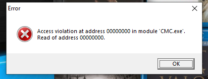

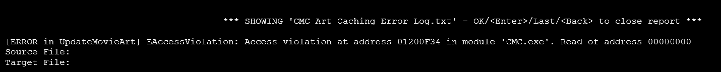

However, I am still getting an error on MCPC with the Art Cache Synching and then a subsequent Access Error Violation. I would assume this is referring to the NetShare created in the CCC folder which is reachable by either CMC client. I can browse to \\wms1\ccc without issue from either client.
This is the art caching error
This is the access violation error after the art caching error
Any ideas what would cause this and how to resolve?
