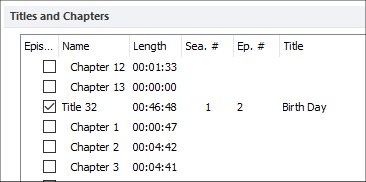

The pattern I'm seeing is that the good episodes don't have the Title # populated, and have the filepath. The bad ones are the opposite.
You're using CCC, correct?
If so, I believe the problem is upstream in CCC. I'm not quite sure why it would only affect the first episode per disc, though.
Also, just to be thorough, can you post one more screenshot, of S1E2 mapped on the disc? You showed S1E1, but not any others. I'm sure it's mapped like you said, but a quick double-check won't hurt.

Pauven wrote: Mon Apr 17, 2023 11:43 am You're using CCC, correct?
Yes sir, using CCC. All discs are properly mapped. I'm that weird sort of animal that doublechecks what comes down from the webservice when I get a new title.
