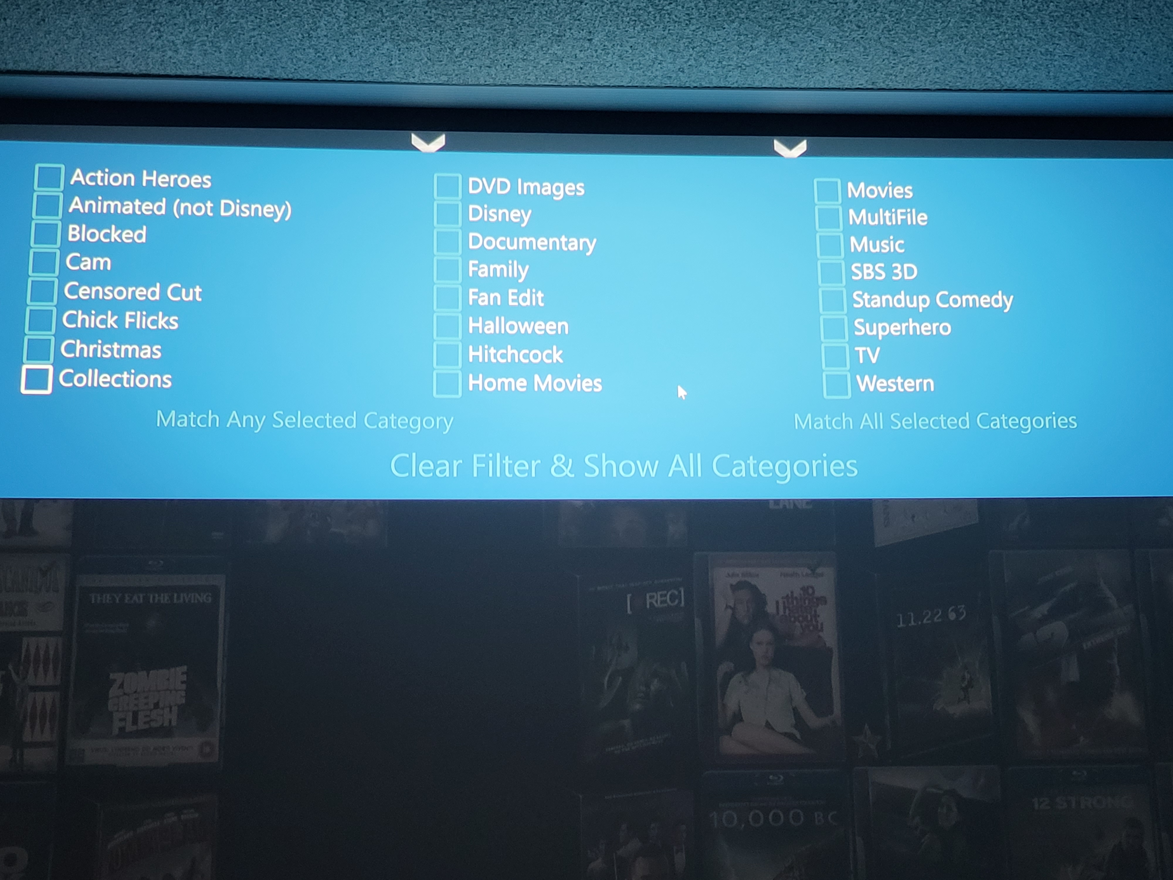

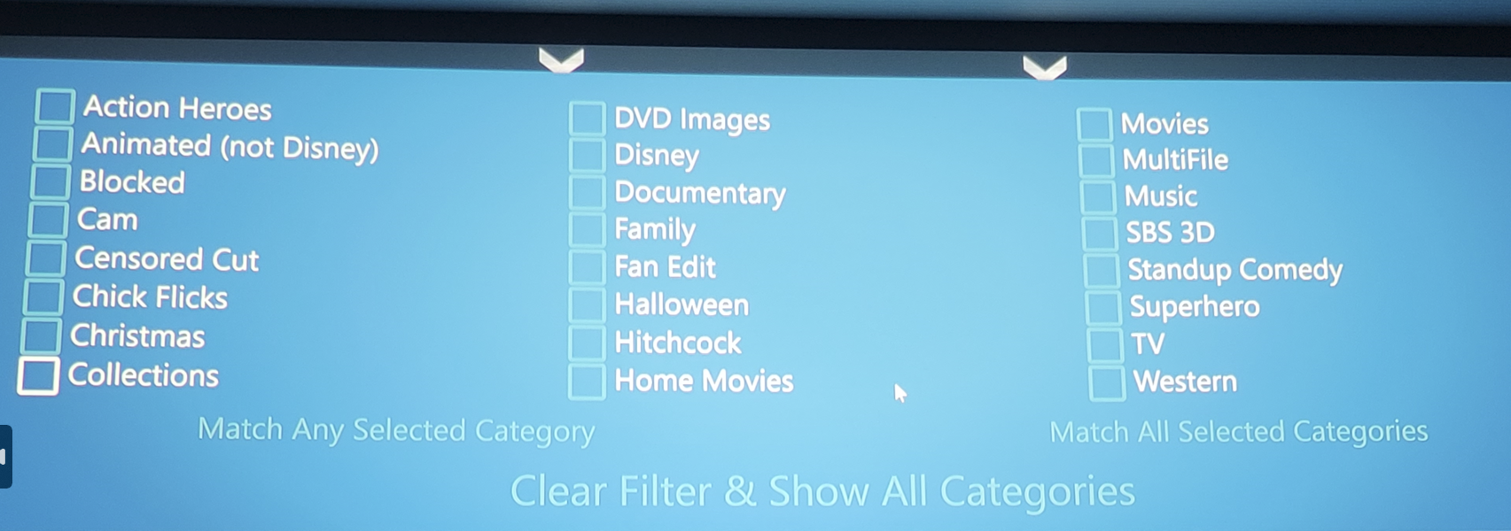

One issue i'm having after upgrading to the latest v6 release is that my categories are not being read properly from the database. See this Imgur post for what it looked like before/after update:
https://imgur.com/a/DF6NU1l
I'm wondering if there is a fix for this? I use category filters all the time, so this is a real breaking change for me unfortunately =(
I have around 5k movies where i stored custom categories by hand for every single movie, huge effort.
Let me know if you want me to do any digging for you, executing any queries in the db to view what is there and reporting back, etc to help troubleshoot this.

Thanks for reporting this issue p64imp. Sorry, I don't have a fix ready to go, I didn't know about this issue until now. I'll dig into it.
v6 changed the columns from 3 to 4. I have some users with a lot of categories (over 100 if I recall correctly), and 3 columns just wasn't enough for them.
I thought we had tested this change pretty well, but you've definitely uncovered an issue or three in my code.
Please confirm or correct the following observations:
For now, I would recommend you revert to v5 since this is affecting you. You can also turn off the check for updates option in the settings so you won't be prompted to upgrade every time you start CMC.
- You have exactly 25 Categories
- You have a newly added Category in your v6 images, Holiday
- The duplicate title, Hitchcock, should be Halloween
- The 3 issues are:
- Halloween shows as Hitchcock
- Checkbox missing for Superheros
- Your selections are not applied correctly when filtering, i.e. you select TV and you get Christmas
Re: [Broken in v6] Category issues when upgrading to 6.0 from 5.0
You nailed it for most of your points below. Point 3 isn't entirely the case. When I select one category it sometimes exposes another... But when I select some categories it applies a filter that seemingly makes no sense at all.
I did add holiday, but when I saw the issue in v6, I assumed it was my new category add that caused the issue. I removed the category and the issue persisted. I then restored a recent back up in a state before holiday was even added, and some how it still showed up....?
I then did a fresh install of the cmc App... Holiday some how still shows up. No idea how but it does.
