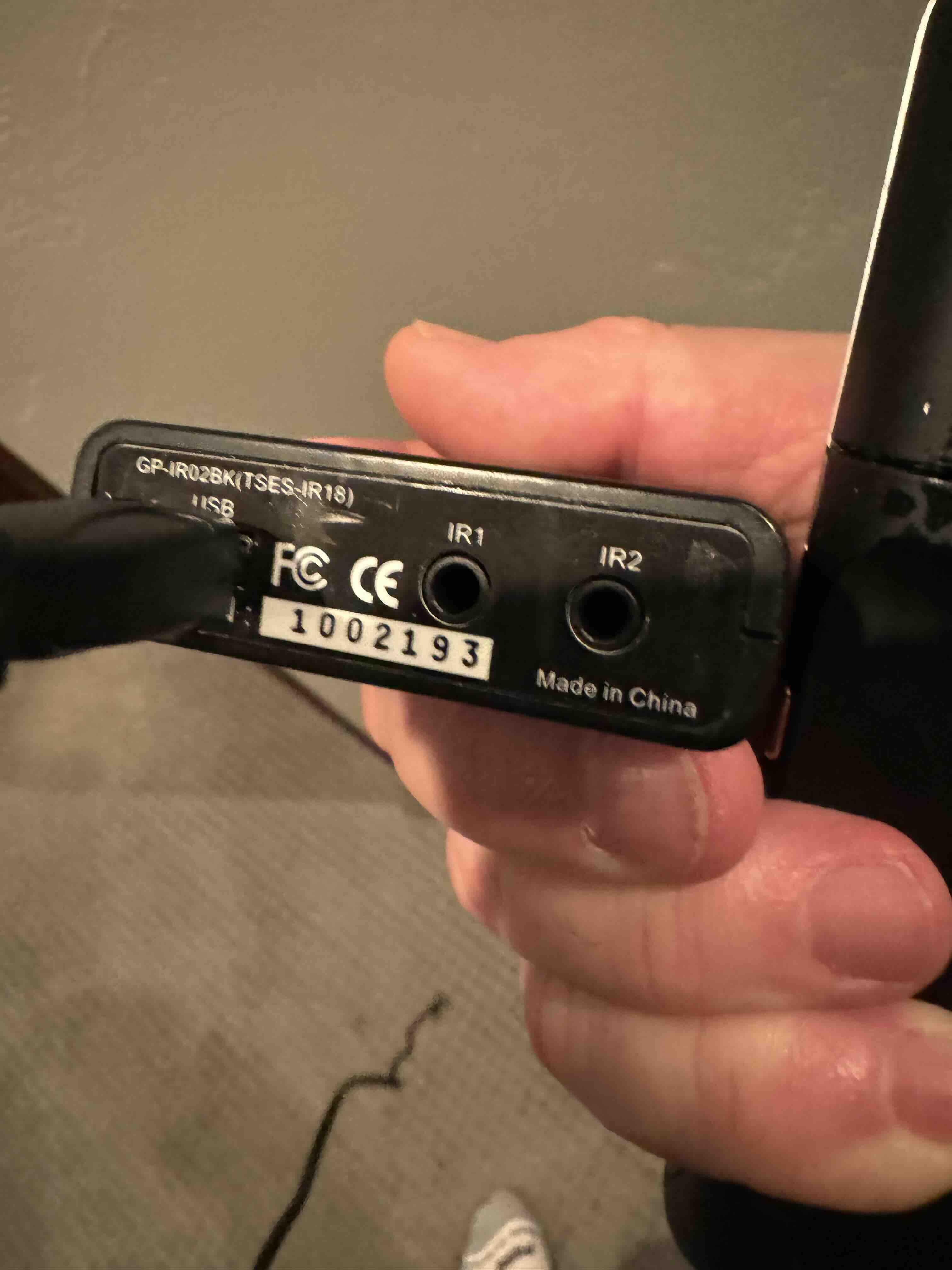

This does get more interesting as I keep digging. I posted a picture of the one that works on my Windows 10 machine. When I googled that Part number it came up under my purchases on Amazon from January 23rd 2012 (that's not a typo!). I don't see anywhere where it says RC6 on it either which might explain why it doesn't work on my new machine.

The picture below is the one that works. That was an interesting experience. All of that to get a button to work (smile).
