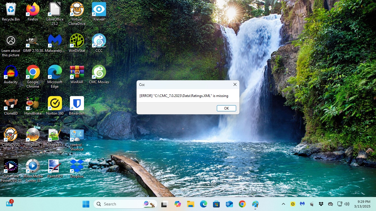

I bought a new PC which came with windows 11 Pro. I am having some issues with running CCC. When I run it I first get an error regarding a missing file "ratings.xml". It then tells me that I have to install the network share folder. When I first ran CCC I ran it as admin and installed the share. This happens every time I run CCC. I did successfully run a full import for all my disks. For the ratings error look at the attached file. CMC has all the covers but the sync has an exclamation point. Has someone ever reported this problem with windows 11 pro? Some people must be using windows 11. I looked at all the support issues but I don't see anything on windows 11. Mymovies seem to be running fine by the way. I have both ccc and mymovies on my new PC and I am running CMC on it too. The CCC connections in CMC look fine too.

It looks to me like you may have renamed the directory after install, is that right? The path looks weird.
CCC is very sensitive to directory name changes, and/or moving the directory after setup.

Which takes us back to your error message screenshot, where it complained about Ratings.xml being missing:
  • C:\CMC_7.0.2023\Data\Ratings.xml
That's what originally popped out at me, it's complaining about Data inside the CMC directory, not the CCC directory.
It almost seems like you are slightly confusing CCC with CMC. You definitely moved some stuff. Or maybe you extracted the contents of the CCC directory directly to a folder named CMC_7.0.2023.

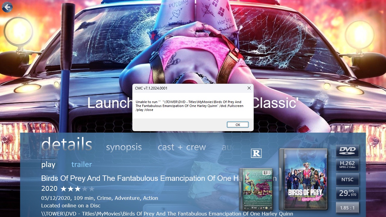

When trying to play a DVD with MPC-BE I get the following error in CMC. it says that it is opening MPC classic. isn't that MPC-HC? I don't have MPC-HC installed and i double checked my settings for DVDs It is set to MPC-BE. PowerDVD and Jriver media Center work fine.

Jamie wrote: Wed Mar 26, 2025 8:35 pm When trying to play a DVD with MPC-BE I get the following error in CMC. it says that it is opening MPC classic. isn't that MPC-HC? I don't have MPC-HC installed and i double checked my settings for DVDs It is set to MPC-BE. PowerDVD and Jriver media Center work fine.
CMC supports both MPC-BE and MPC-HC, perhaps you selected the wrong one, or the one you have installed is not being found. In Settings > Info you can show the detected players, that would be helpful here.
