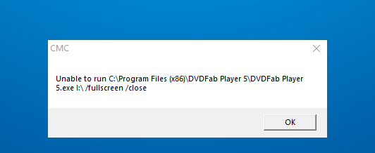

I was checking out Chameleon v2.1 build 2019.0123 and whenever I try to play an iso file using DVD Fab Player 5 I get the following error:
My machine is running Microsoft Windows 10 X64 Pro
Do you have any indication what might be the problem ?

Re: DVD Fab Player 5 problems....
Post by Pauven » Tue May 14, 2019 10:03 am
Hi Andreas,
Can you browse out to C:\Program Files (x86)\DVDFab Player 5\ and make sure the program file "DVDFab Player 5.exe" exists?
Also, it is trying to play the disc in drive I:\, please make sure that is your Virtual CloneDrive letter, and if not then correct it in the Settings.
Let me know what you find.
Post by ANDYK48 » Tue May 14, 2019 1:32 pm
Hello Paul,
Thanks for the quick reply :)
The "DVDFab Player 5.exe" is in the "C:\Program Files (x86)\DVDFab Player 5" folder.
The settings for virtual clone drive are also correct...
The iso files are mounted from a network share on my unraid server, if this makes any difference....
If you can think of anything else let me know.
Andreas
