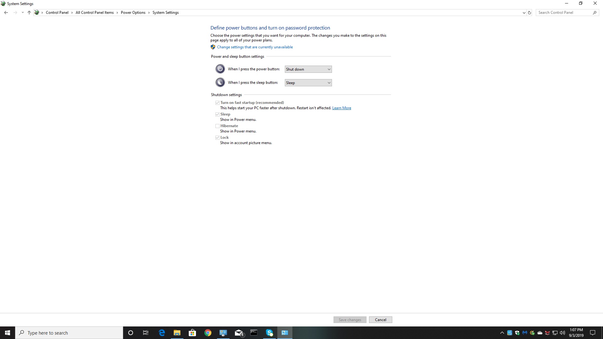

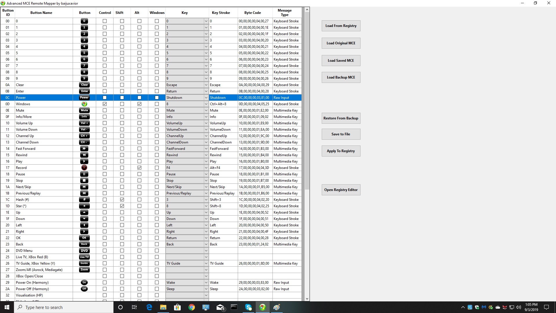

here are my current mapper power button setting. Power button highlighted in blue.
Here are my current sleep and shutdown action settings.
system pwer actions.jpg (130.08 KiB) Viewed 22582 times
