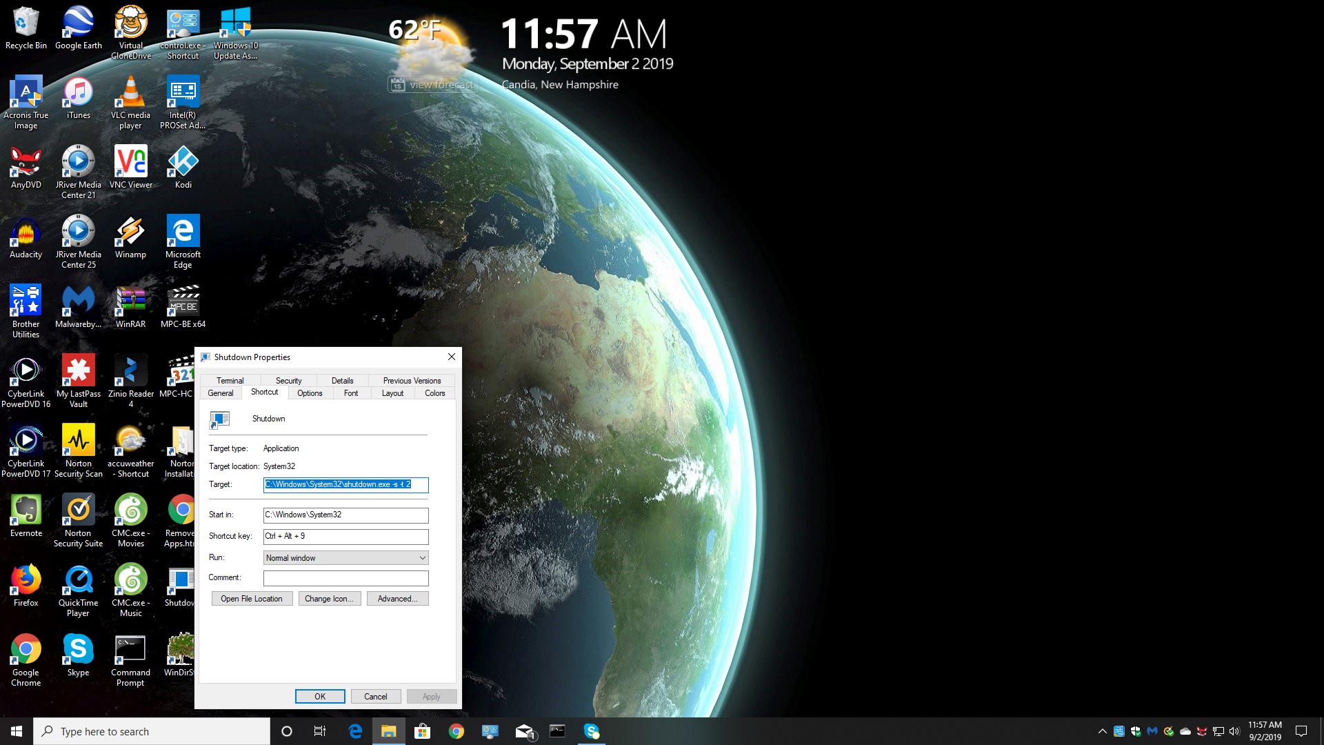

In "Advanced MCE Remote button mapper", I program the power button to invoke keystroke CTRL + ALT + 9 to run a shortcut to shutdown the PC.
I have a shortcut that initiates the power shutdown. See screenshot.
Could CMC do the same programming?

I noticed that for the MCE advanced mapper by default that they use a command "shutdown". This doesn't seem to work for the nucs which I assume is the problem in this case. The keystroke is being sent to the NUC which seems to not know what shutdown means. I map the shortcut and it works fine. For now I am using the mapper program to define the shutdown button and CMC for all the other functions.

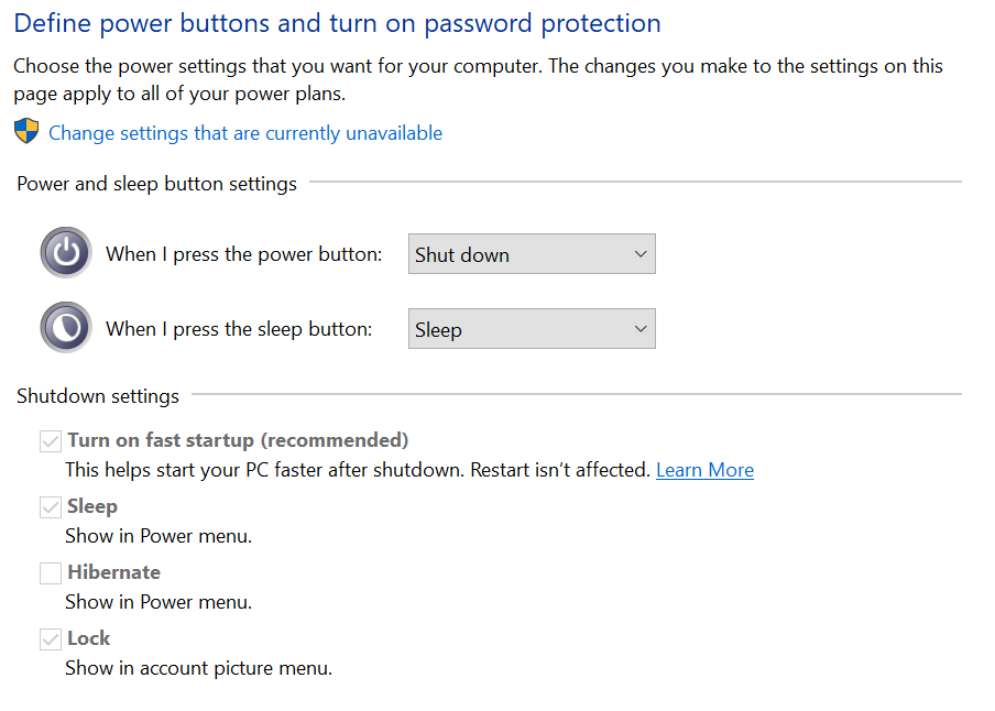

Here's what Advanced MCE Remote Mapper shows for my power button - this should be stock Windows 10 values:
EDIT: Here's my system settings:

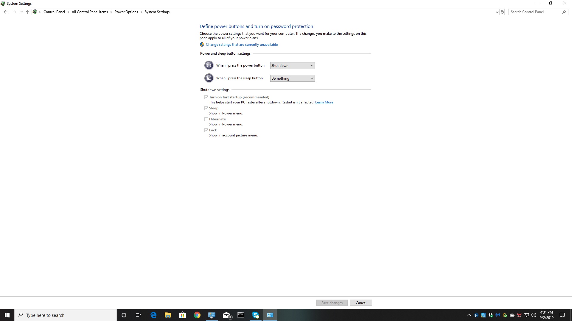

My shutdown setting is set to shutdown. Sleep is not set.

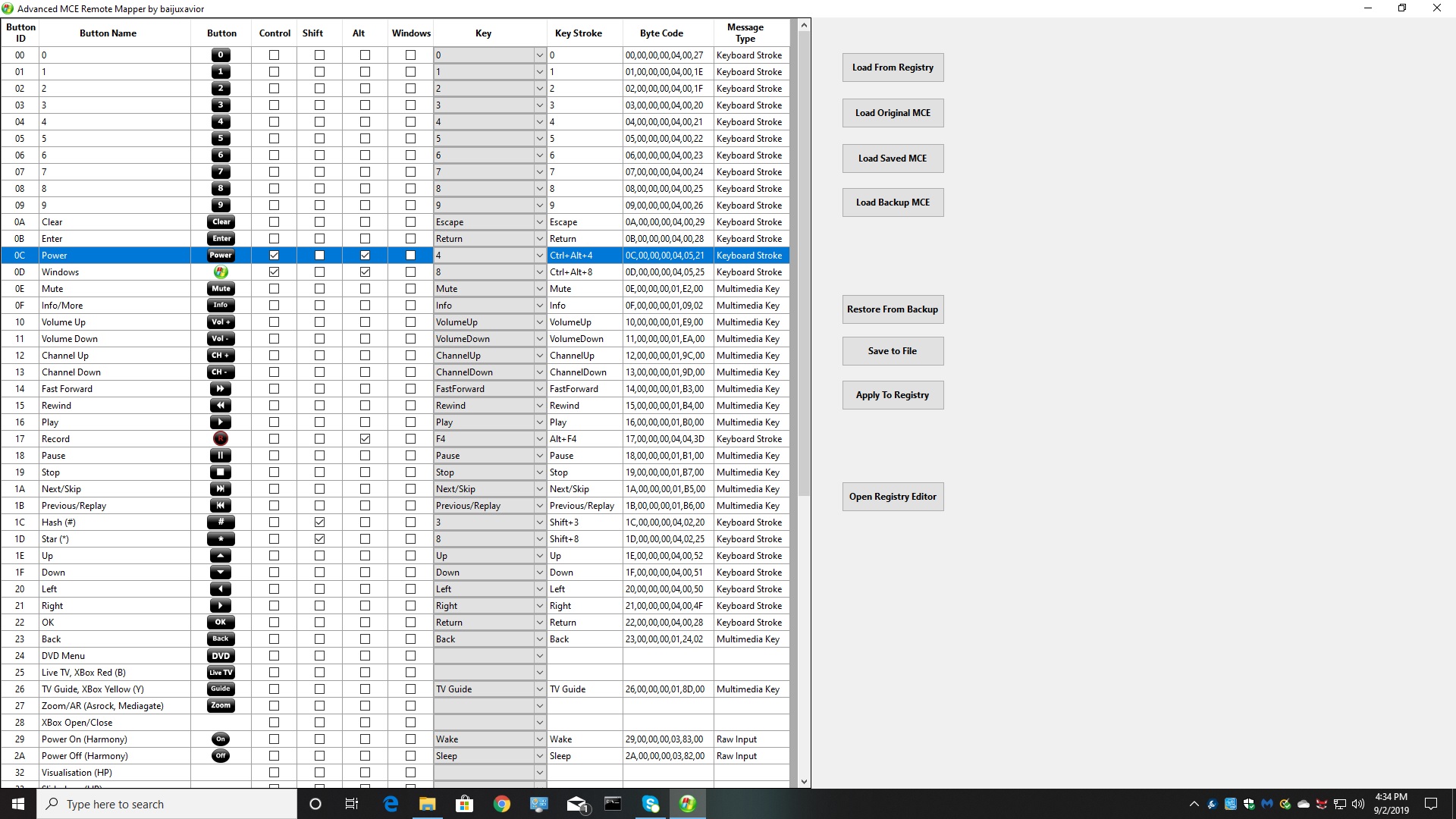

My mapper program by default is set to this which does not work.
mapper shutdown.jpg (493.79 KiB) Viewed 23949 times
I set it to this and it works.
