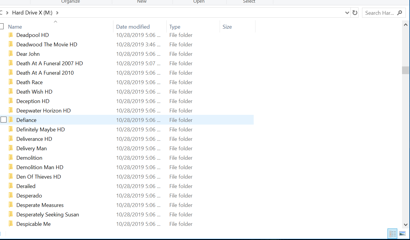

I have no VIDEO_TS folders in my entire collection now. I moved everything to the movies individual root folders. I experimented with moving the VOB files around and resetting where the MM database was pointing and nothing made the movies come online in CMC. The folder structure was all over the place for the VOBs so I just ended up changing them all to match (i.e. delete every folder but the root movie folder). After your last email, I restored one test folder that was offline and did exactly as you said (i.e. 127 Hours\MainMovie\VIDEO_TS) then reset the MM pointer and did a full sync in CMC. Its still offline.
Sorry for this being a pain but I must be missing something or there is a glitch with CMC vs my setup.
soundmanmike
- Posts: 36
- Joined: Thu Oct 24, 2019 3:46 pm
- Location: Traverse City, MI
Re: VOB Movies Not Showing Up In Catalog
Ok, I redid the test movie and I found that it had two sets of XMLs. One set in the root folder with the MainMovie folder and one set with VIDEO_TS. Once I removed all the test XMLs in all folders and had MM rewrite the setup for that movie. Then I re-synced CMC and finally the disc is online. Since I have removed all folder structure (Movie\MainMovie\VIDEO_TS) is there a easy way to mass fix the folders. I had to manually remove them and it was a time consuming pain. Thanks again for all of your help!

Everything is on M:\ ....its a 50 TB setup. I was thinking about a script myself but I do not have a lot of experience in that area. NO, there are no multi disc titles that are contained within the same folder.

No, everything is movies. MKV, ISO, VOBs etc. All in their individual movie title folder.
