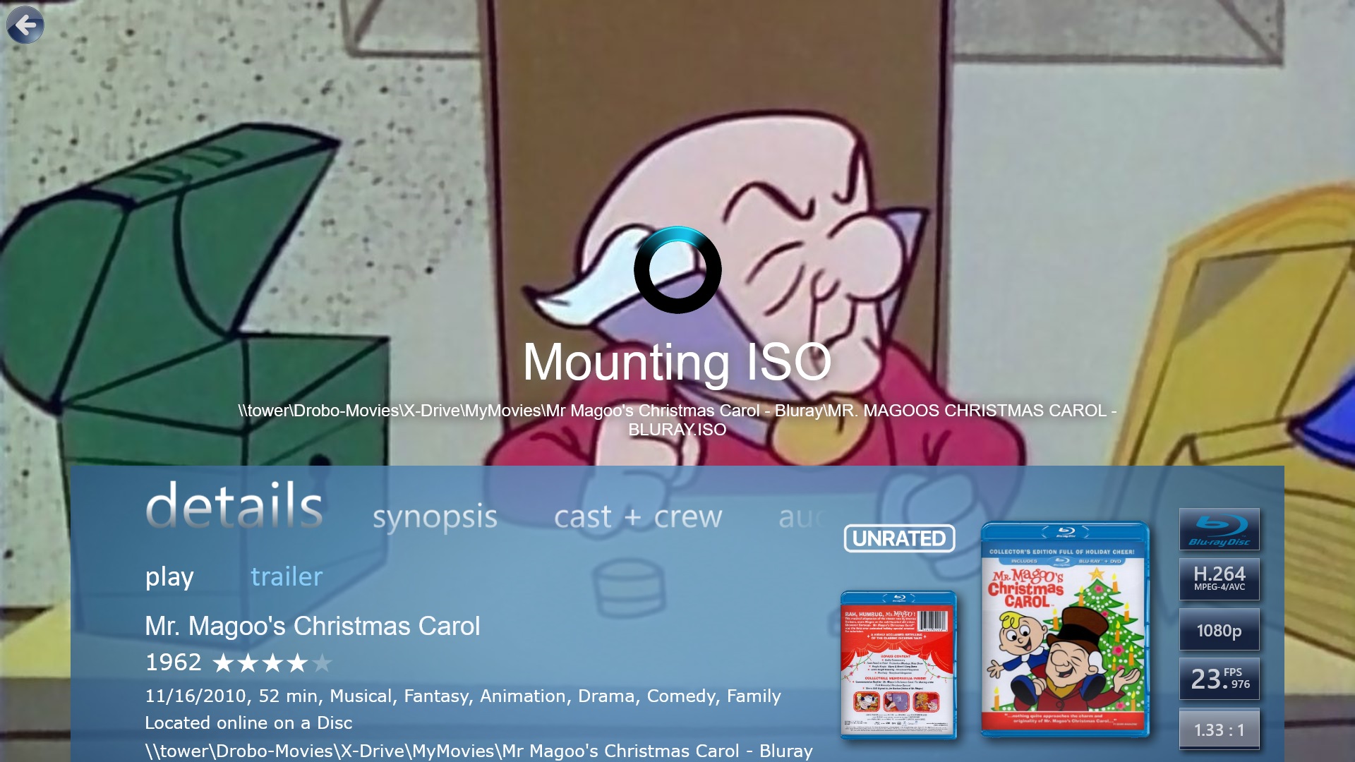

After removing the "." from several files on unraid and in the MM CM. I did a "Full Import Now" When it finished the titles appeared
properly and I was able to mount & play the discs in CMC. I did not have to delete any DB files and will refrain from doing so in the future.
period removed - full export.jpg (385.24 KiB) Viewed 5627 times

working on RC2. Added a period to one Mr Magoo disc. Duplicate disc occurred so that I have to run full import. I'll let you know my findings when the import is finished.
Re: extra discs showing up in CMC which are not related to the title
Post by Jamie » Tue Dec 22, 2020 11:03 pm
Periods inside the MM disc location field work fine now. I tested a couple of titles which I reverted back to having periods in the disc path. No problem mounting and playing each disc.
