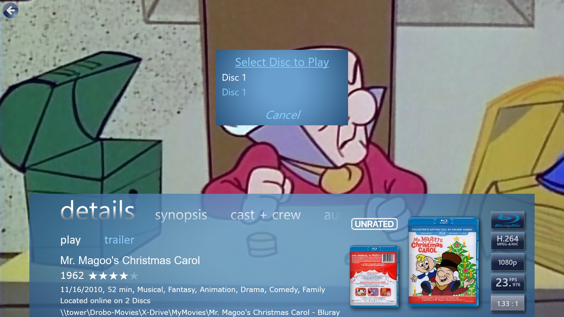

I have several titles in CMC which have discs that do not belong to the title that I am trying to play. I used CCC to import the titles. Some discs were fixed when I deleted he cmc DB bin file and ran the entire import. Some discs were fixed by importing from scratch but others had discs that belong to other titles still.

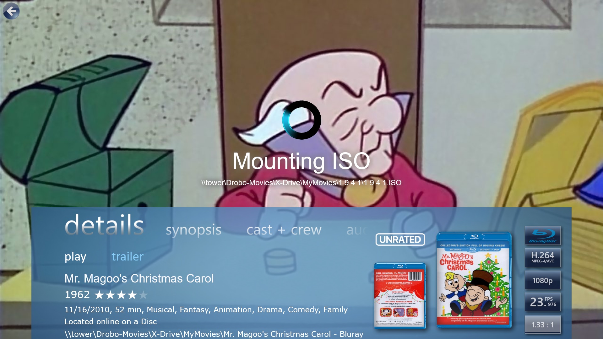

I still have 3 titles that appear with these extraneous discs. I check the MM CM which looks fine to me and I did a few other investigative procedures and the MM data looks fine. One disc, Mr Magoos Christmas shows the correct path on the Choose to play screen, but when I click play CMC mounts the title 1941 and plays the 1941 disc.
Here is a picture of the screen I'm talking about.

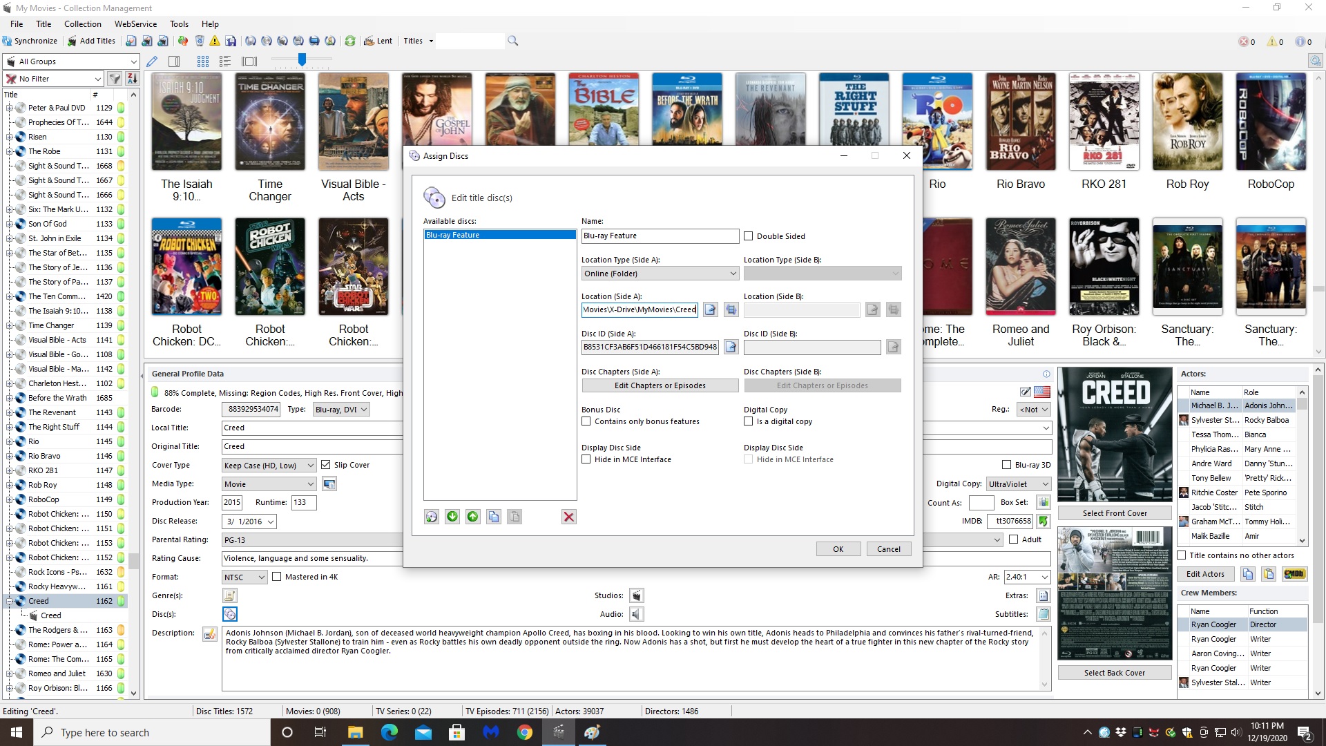

Here is what I see in MM CM
- creed mm cm.jpg (684.04 KiB) Viewed 8551 times

Question - does the problem only occur for titles that include a period in the name? For example, "Mr. Magoo's Christmas Carol - Bluray" has a period after Mr.
I think my disc location validation logic is falsely identifying the folder as a file because there's a period in the name, and everything after the period looks like a really long file extension.
