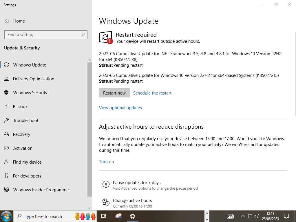

Must be Microsoft with their updates, as it’s updating/downloading automatically although it wasn’t set to. The same updates that I had removed by system restore earlier.

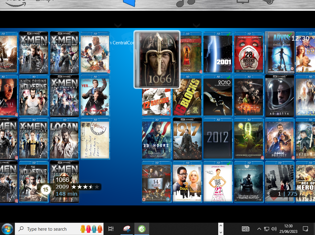

Well that was lucky, I did a restart and it's all back.

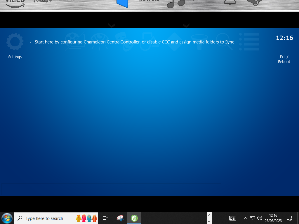

But there is one thing, on CCC, it says, Start here by configuring Central Controller or disable CCC and assign media folders to Sync.
Don’t know why it says that?

That "Start here" message is shown on new installs, when the connection to CCC is not configured properly yet the option to use CCC is enabled.

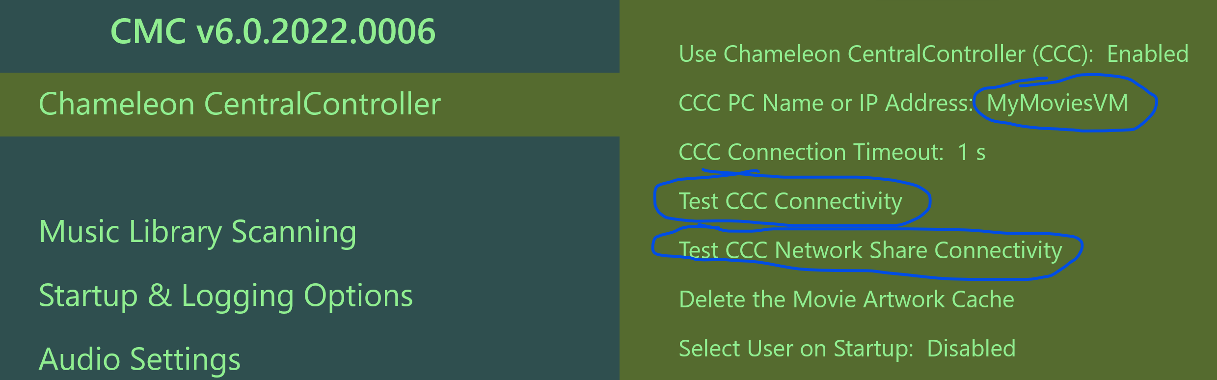

On a new install, CMC is set to use CCC, since that is the newer and better method. But it still needs to be configured to work. So in CMC, go into Settings (which is where that message is pointing you), and configure the "Chameleon CentralController" settings.
Mostly, you'll just need to set the "CCC PC Name or IP Address". If your CCC install happens to be running on the same PC, just put "localhost" as the PC Name. Otherwise, put the name of the PC where CCC is running (remember, you should only ever have 1 copy of CCC running for your entire home, each CMC PC connects to that one PC). Here you can see my PC Name is set to "MyMoviesVM", which is the name of the PC where I have CCC running:
Be sure to Save if you make any changes. You'll also want to run both the "Test CCC Connectivity" and "Test CCC Network Share Connectivity" options. The first one verifies that CCC is reachable (of course, make sure that CCC is running when you do this test), and the second one verifies that the network share which is used for DVD artwork is configured and reachable. If either test fails, then either the PC Name is wrong, or CCC isn't running or installed properly, or possibly you have network firewall issues.

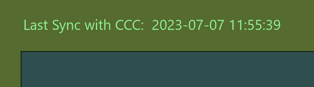

Additionally, lower down on the page is a status line that indicates the last time that CMC successfully synced with CCC - this should be pretty recent, if not then that indicates an issue communicating with CCC:

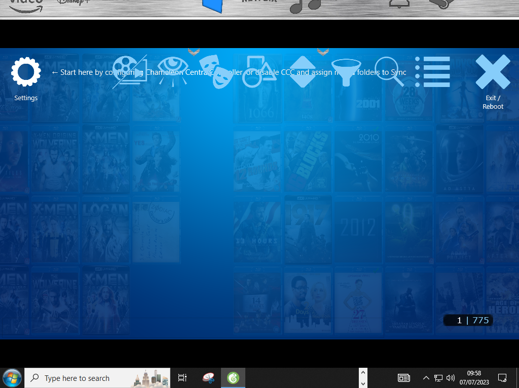

One last thought - you recently mentioned that all CMC settings were lost, then you rebooted and then they came back. Your screenshot makes it looks like the settings were lost again. I'm wondering if you perhaps have CMC installed in 2 different folders, and one is configured and one is not, and you are switching between them and getting different results. Just a thought, seems that could explain some of the weirdness you've encountered. You can have multiple copies of CMC (and different versions too) in different folders, and they each run independently. That's helpful when I have users beta testing new versions, they can run it side-by-side with older versions, comparing results. But in general, you should only have 1 copy of CMC installed unless you are doing special beta testing.
