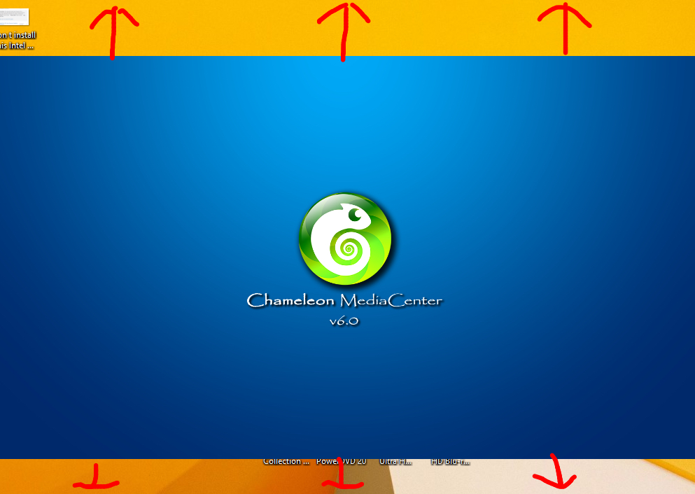

I'm not too sure if the latest Windows updates have done this from this date 21/06/2023, (I couldn't get into all the different Windows settings, in Windows settings) or the latest Intel graphics update??? But the interface format has changed. I have managed to do a full system restore, but the interface hasn't changed back to normal. (I'm using v6 CMC.)

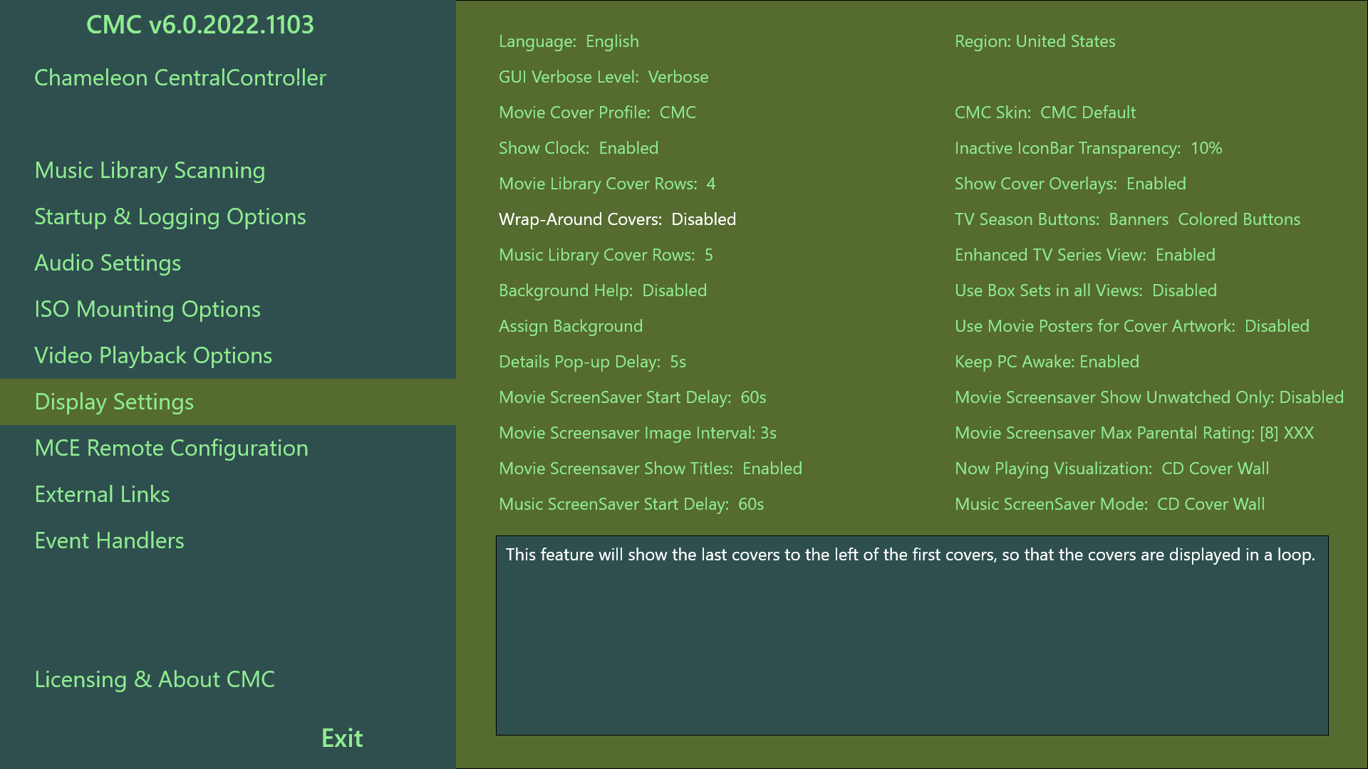

Are you referring to the wrap around titles? That is the CMC default setting. You have to change that in the CMC settings. See Settingsricardo8369 wrote: Wed Jun 21, 2023 12:59 pm I'm not too sure if the latest Windows updates have done this from this date 21/06/2023, (I couldn't get into all the different Windows settings, in Windows settings) or the latest Intel graphics update??? But the interface format has changed. I have managed to do a full system restore, but the interface hasn't changed back to normal. (I'm using v6 CMC.)

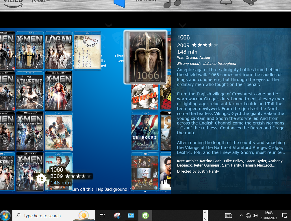

Re: Different format
No, the interface itself. It should be more open out, without seeing the black bars top & bottom and also the banner (right at the top) showing, with Netflix, Amazon Prime, etc

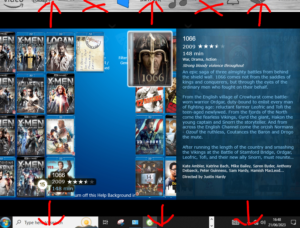

See attachment

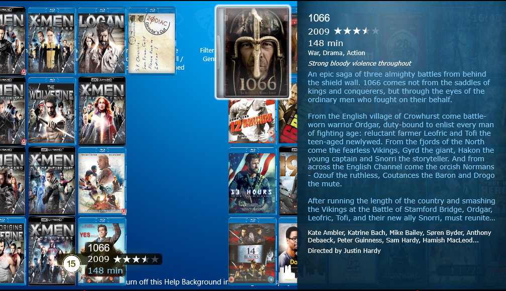

This is how it should look like, without anything else showing
