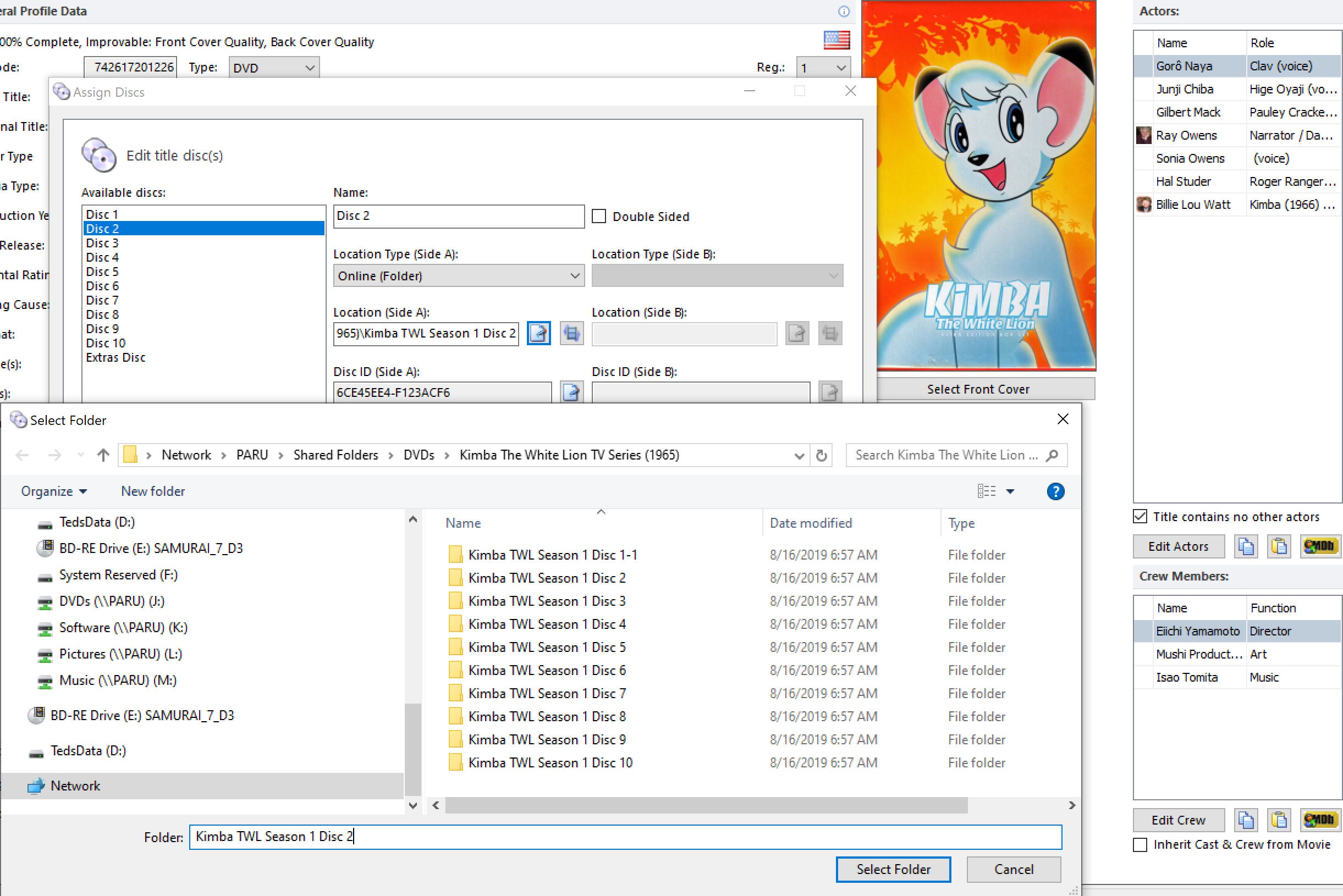

Happy Friday! Attached are the screenshots you requested. I'm not a big TV series fan as I don't have a lot of them. It's just some are special to me because I used to watch them as a kid and Kimba is one of them back in the mid 70's. I still enjoy watching it occasionally. I'm the only one that brought this title into MM, so I know the mappings are correct. I double checked a couple of discs and they are spot on. Movies have been coming in flawlessly with the occasional MM data issue that people will put in the wrong information. Sometimes I think they do that just to get points. I could approach Brian with this, but I'm not sure he'll be much help when it comes to third party software. I could get really drastic and delete and re-rip the media, but it's not the media that is the problem.

The message "No Episodes indexed for this Title's Discs, skipping Meta-data export." is generated based upon a parsing of the <Title> xml data. Perhaps something is going wrong there.
Please provide both the mymovies.xml and mmTitle.xml files to me for review from one of the Kimba disc folders.
Please note, the forum is currently preventing direct attachment of the mmTitle.xml files (a safety feature gone awry), so either email them to me or zip them up before uploading to the forum.

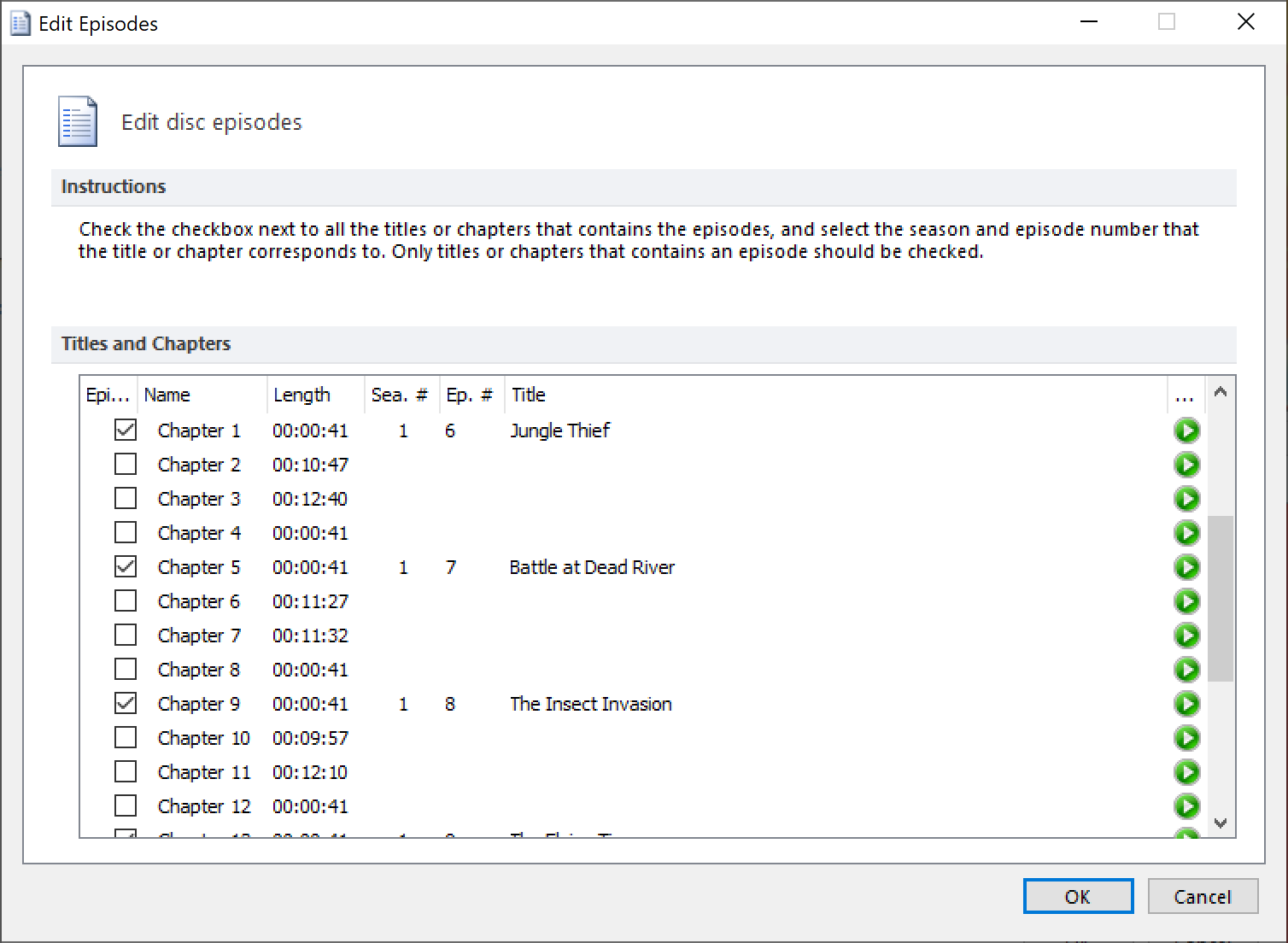

Here's an edited version (to make it more readable) of what's in your Kimba XML. The yellow highlight is what the CME function is checking to see if it is TRUE, but since it is false it fails. The green highlight is being ignored by the function, even though as you can see it indicates an episode exists.
<Title ContainsEpisode="False" Number="3" Hours="02" Minutes="03" Seconds="28" TVSeason="" TVEpisode="">
<Chapter ContainsEpisode="True" Number="1" Hours="00" Minutes="00" Seconds="41" TVSeason="1" TVEpisode="1">
<Title>
<![CDATA[]]>
</Title>
</Chapter>
</Title>
Which brings us to problem #2 - Chapter based episodes. Currently, Chapter based episodes are not supported at all by CMC, only Title based episodes. This is on my to-do as a future enhancement, but for now it just isn't possible with the current version of CMC.
One of the challenges of Chapter based episodes is that very few players support them. I think MPC supports starting playback at a specific Chapter, but most players either only support starting playback at a Title, or don't support either at all (i.e. PowerDVD/DVDFab Player/JRiver do not support Title or Chapter playback at all, which is why they cannot be used for DVD Episodes).
For that reason you'll need to continue treating Kimba as a regular DVD, and launch episodes from the DVD menus. And that is what should be happening automatically, based upon the reported behavior of CME & CMC.
Luckily, so far very few TV Series seem to use Chapter based Episode indexes, most use Title based indexes, so the impact should be small. I have one series myself, Invader ZIM, that uses Chapter based episode indexes on a DVD, so I do have media to develop against.
