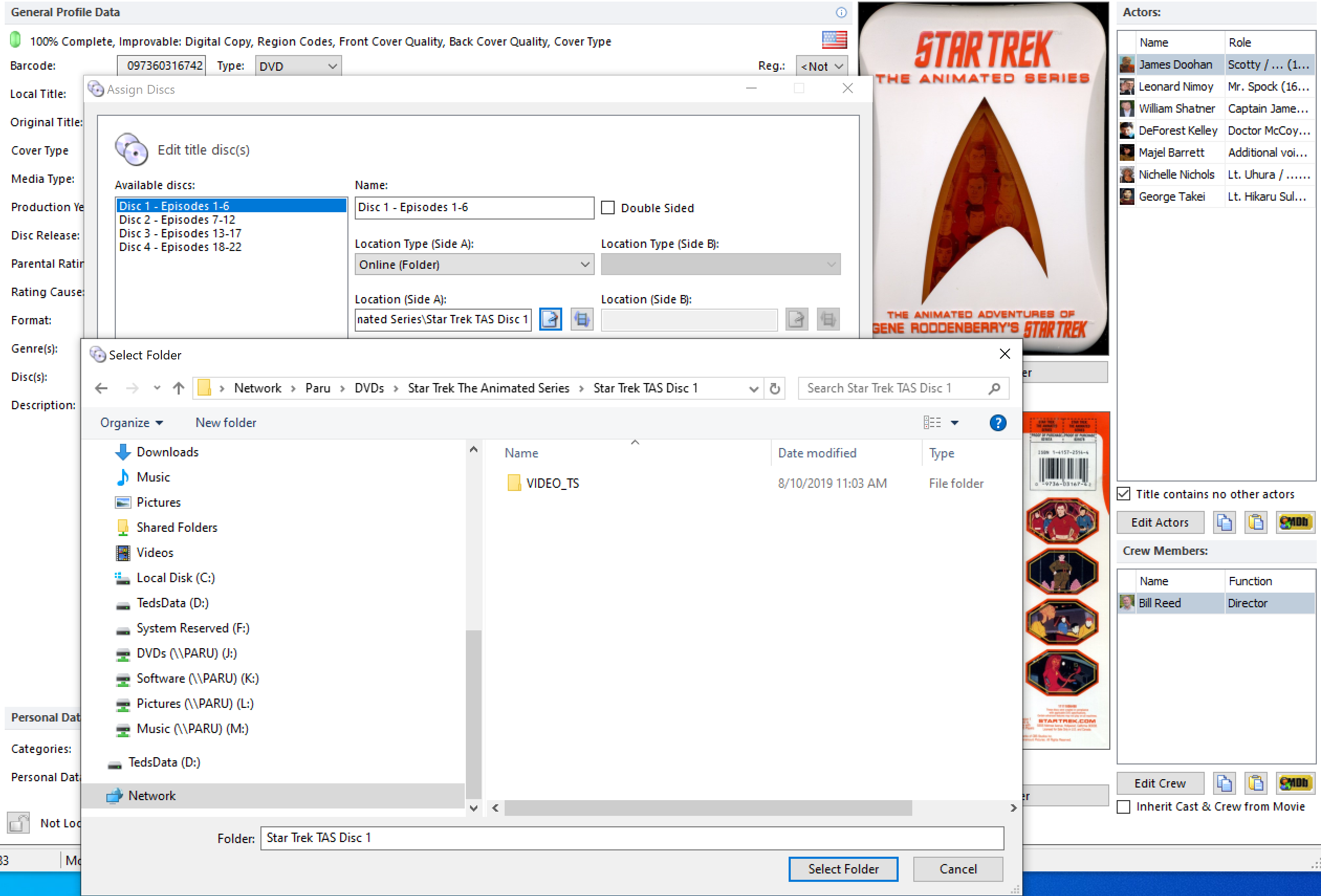

Several tv series are not displaying in the expected manner. Two of the worst are battlestar galactica and Star Trek the animated series. For star trek I keep getting a path error that it can’t write the files to the titles folders. I have double checked the paths and they are correct . The path that it tries to write to for one folder example is //server/DVDs/Star Trek TAS/Star Trek TAS disc 1/Star Trek:
That last part (Star Trek:) is where it gets lost. It tries to find that path for all four discs which does not exist. None of my folders have that last part of the path. For Battlestar CME finds the path, but can’t complete writing to the folder. MMCM has no issue writing to those folders. There are a couple of other tv series that are not displaying all episode data as well, but I want to concentrate on these two first. This is driving me crazy!

Teddyboy wrote: Tue Aug 13, 2019 3:10 pm Several tv series are not displaying in the expected manner. Two of the worst are battlestar galactica and Star Trek the animated series. For star trek I keep getting a path error that it can’t write the files to the titles folders. I have double checked the paths and they are correct . The path that it tries to write to for one folder example is //server/DVDs/Star Trek TAS/Star Trek TAS disc 1/Star Trek:
The problem is the colon in the path - colon's are invalid. I thought I had already fixed that issue. Can you confirm what version of CME you are running?
Also, please provide a screenshot of MMCM showing the disc location for Star Trek TAS Disc 1, and also an export log from CME for the same title.

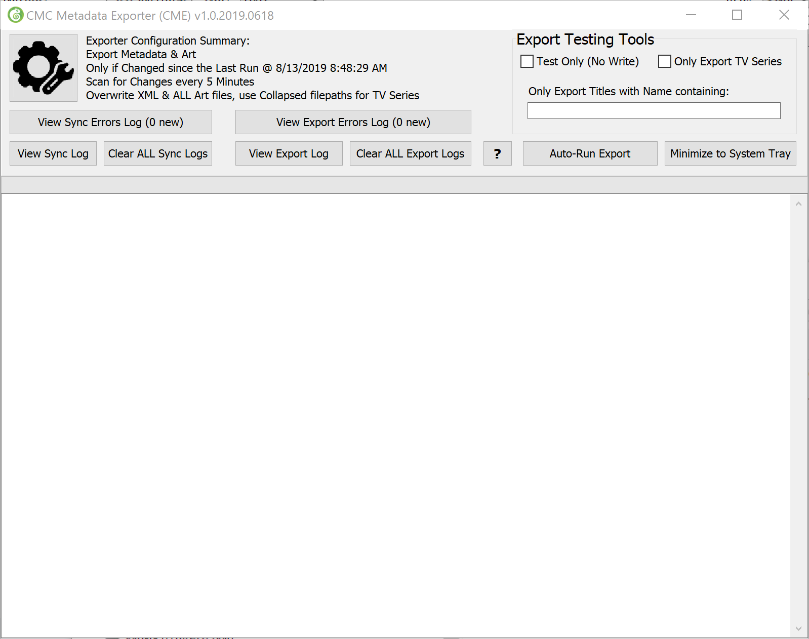

The version of CME is 1.0.2019.0618. Attached are the two files you requested, and a screenshot of CME to show the version number. I did not give you the whole export log. Just the part for Star Trek the animated series. Lets just start with the series first then on to the others that are having some issues after we've found a solution for this one. There are only about three or four others.

You're not running the latest version that includes the fix for reserved characters in TV series names.
Do you not receive an upgrade notice when you run CMC? The CME upgrade is included as part of the CMC upgrade.

Well that would explain that then. I'm actually running CME my PC, so I can use MMCM and CME from there instead of running to my htpc because I wanted to see the sync output. It's easier this way as my HTPC is in my living room. I haven't notice any notification, but I haven't been using my htpc a lot. I'm starting to as of today to watch movies. I don't normally shut down CMC. I just let it run, but with all the metadata stuff going on I have been closing it a lot, but as of today it's going to stay up. No I haven't really noticed.

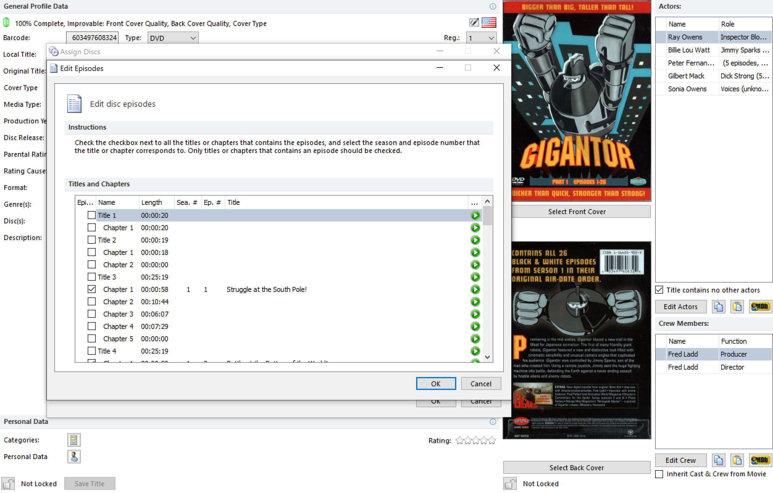

Here is another one that has me stumped. None of the season one episodes will show in CMC. CME states that there is not episode data when clearly there is in MMCM. I can't figure out what is wrong.

Teddyboy wrote: Wed Aug 14, 2019 12:09 pm Here is another one that has me stumped. None of the season one episodes will show in CMC. CME states that there is not episode data when clearly there is in MMCM. I can't figure out what is wrong.
Please include screenshots of the Gigantor main Title screen, and the Assign Discs screen.

Will do that when I get home. Do you want to see a screen shot of each discs assign disc screen? I think I have one or two more series that need some work to get them to display series info properly. Blue planet is having a similar issue as Gigantor. The same fix might apply to it as well.Pauven wrote: Wed Aug 14, 2019 5:30 pmTeddyboy wrote: Wed Aug 14, 2019 12:09 pm Here is another one that has me stumped. None of the season one episodes will show in CMC. CME states that there is not episode data when clearly there is in MMCM. I can't figure out what is wrong.
