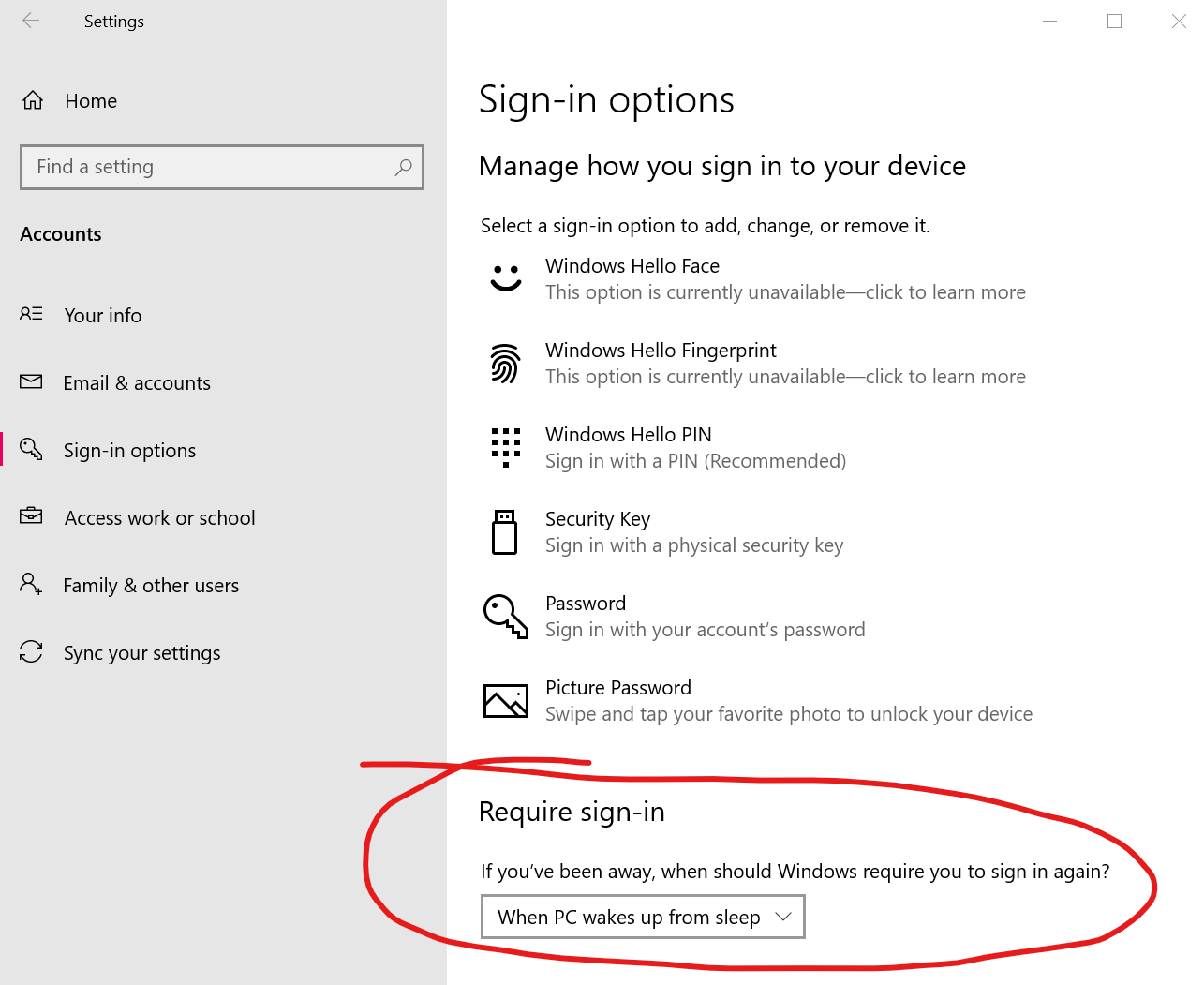

Post by Pauven » Thu Jul 02, 2020 6:29 pm
After further testing, I discovered that the change above only hid the Lock Screen, and not the Sign-In screen. When I slept the PC from CMC using the Sleep option, that didn't show the Sign-In screen so it seemed perfect.
But when I slept the PC using the power button on my remote, it did show the Sign-In screen. Not sure why that is different.
I tried to control it via the registry, but couldn't find a value that would control it and let me edit it via the registry (Windows blocked me from editing the controlling registry key).
Looks like the only way to disable the Sign-In screen is manually via this setting:
Posting here for future reference, as I'm sure to forget...
