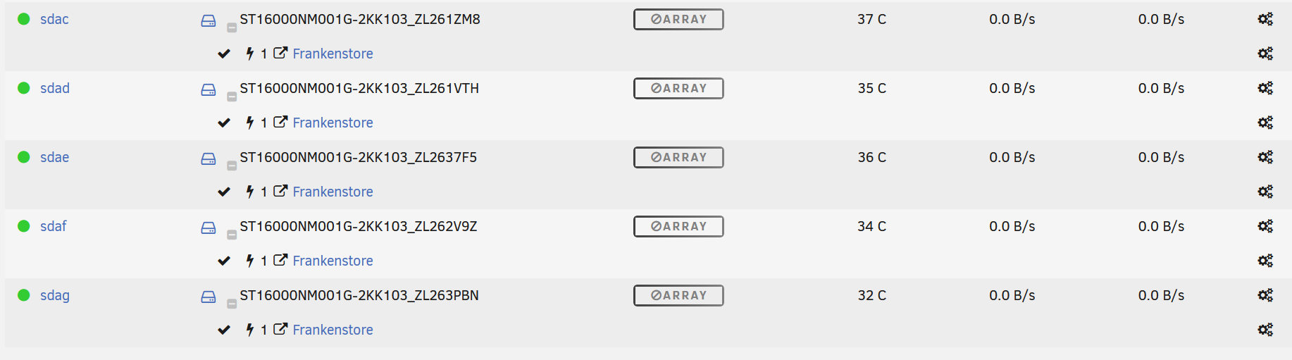

Uh-oh:
Now all drives have the ØARRAY value in the button, which I presume means they are a member of an incomplete array. I can't edit any of them, and I can no longer mount them. I can't revert them. Even the gears Settings button is blacked out/disabled and can't be clicked.
This is exactly what I was worried about, and why I had reached out to UD's developer dlandon for confirmation on the steps.
I still have some ideas on how to recover. I might be able to remove and re-add the drives to the btrfs pool using the commands documented earlier. I might be lucky and have the data recovered since it's just a simple single pool, but worst case here I may have to spend a week running a new backup.
I should have stayed content with the solution I had in place. It worked perfectly, and I knew not to click the Mount button on any drives other than #1.

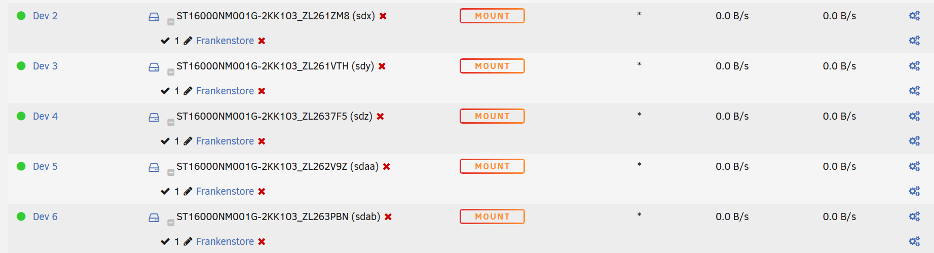

While troubleshooting the issue, I discovered several error messages in the Unraid log complaining about duplicate devices. I was pretty sure that this was caused by renaming disk label Frankenstore_D2 to Frankenstore. I also noticed that none of the 5 drives had a "sdx" device label. I figured that at this point, Unraid/Linux was confused, and I needed a fresh boot.
I powered off all 5 drives, and then removed them from UD's Historical Devices, and rebooted the server.
After startup, I powered on backup drive #2, and was able to rename it back to Frankenstore_D2. I then powered it off, cleared the Historical Devices again, and powered them all back on in sequence.
This time they all got device ID's, have the button enabled to mount again, and are configurable. Interestingly, they all show mount point or drive label Frankenstore.

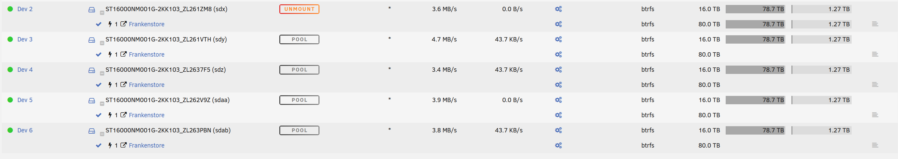

I then proceeded to mount drive #1, and amazingly I think I've achieved the originally desired result:
The data still displays slightly weird in UD, but now they all have the same Frankenstore mount point, the secondary drives show POOL instead of MOUNT. And oddly they all show the exact same pool size and free/used amounts.
It's a bit of a guess at this point as to exactly how I achieved this result, but I think the actual secret was simply removing these 5 drives from the Unassigned Devices Historical Drives. The individual drive labels still have the drive suffix on them, i.e. Frankenstore_D2, Frankenstore_D3, but now they finally share the same mount point. So it's the exact same steps I outlined to create this pool earlier in the thread, with one additional step to unplug them and then clear them from Historical Devices. A lot easier than I expected, and a lot scarier when I tried to follow the directions dlandon shared.
Even more odd, I keep trying to find a way to show that the individual drives still have the suffix, but I'm failing. Somehow they are actually showing as the same disk label ID, Frankenstore. I don't really understand, but I suppose this is the btrfs pool now overriding the label. But I'm not really incentivized to keep troubleshooting this, as it's now working exactly as I hoped, shomehow...

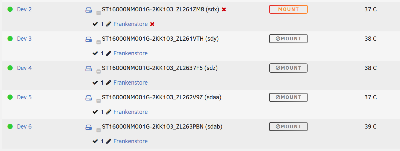

I did make another tweak. I noticed the option to disable the Mount button if I edit the individual drive settings, so I went ahead and disabled it for drives 2-5:
Now I don't even have to think about which drive is #1, there's only a single mount option. After mounting, drives 2-5 still change to POOL as shown above. My earlier concern that I wouldn't see individual drive activity or temps was unfounded, I still see everything so all is good.
