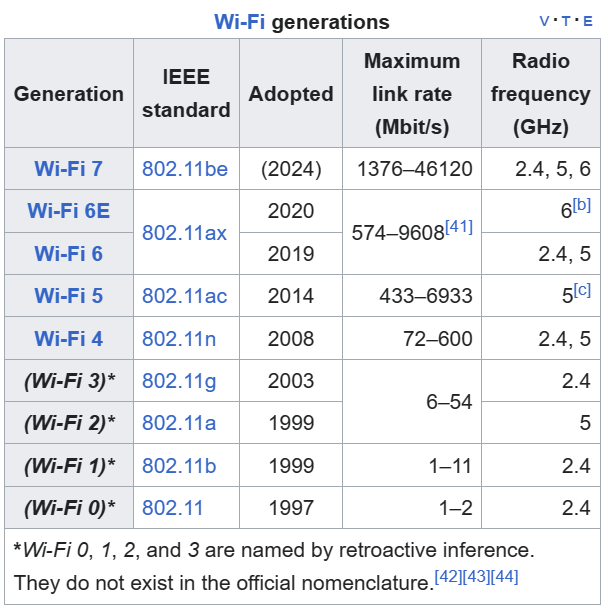

I've tried searching the forum and haven't found info on my next question. My kids(and grandkids) have asked me about getting them on this endeavor. They have an older house that is not wired for ethernet. They would like to have a PC in their rooms and be able to watch movies. Can this be done over a standalone(no internet) wifi network. Master would have internet of course. When update time comes for CMC_CCC , internet would be activated to update, and shut down again on slaves.
Re: v7 upgrade problem with Sync
Post by Pauven » Thu Jan 11, 2024 9:08 am
Yes, modern Wi-Fi should be sufficient, though Wi-Fi router quality will be a factor.
About 20 years ago I attempted a Wi-Fi setup, and it almost worked, but connection quality and speeds were not quite good enough for a watchable experience. I believe this was using Wi-Fi 2 tech. Luckily for your kids Wi-Fi has improved a lot.
Wi-Fi comes in different speed standards, and I think you'd want at least Wi-Fi 5 or faster. Remember, you need this on both your wireless router, and also on your PC's. I'd recommend a Wi-Fi 6 solution, it's been out for 5 years already so should be readily available, and it supports both 2.4 and 5GHz frequencies so you have more frequency options. 6E adds 6GHz which opens up even more frequencies, but if they're in an older home then they probably aren't in a heavily congested area competing for radio frequencies.
Don't worry about Wi-Fi 7, it literally came out this week, and there's very few devices that support it.
You also need a nice router that can handle multiple streams, otherwise having multiple rooms watching simultaneously could be a problem. I think some of the better routers can handle 6 streams or something like that. Just because a router says it has Wi-Fi 6 capability doesn't mean it can handle multiple streams at full speed, so definitely don't pinch pennies on the router, it's the heart of the solution.

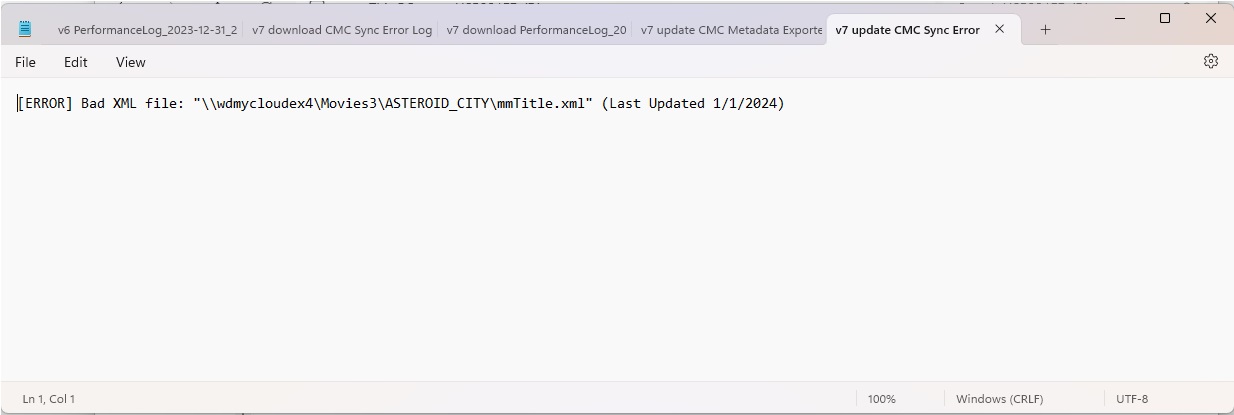

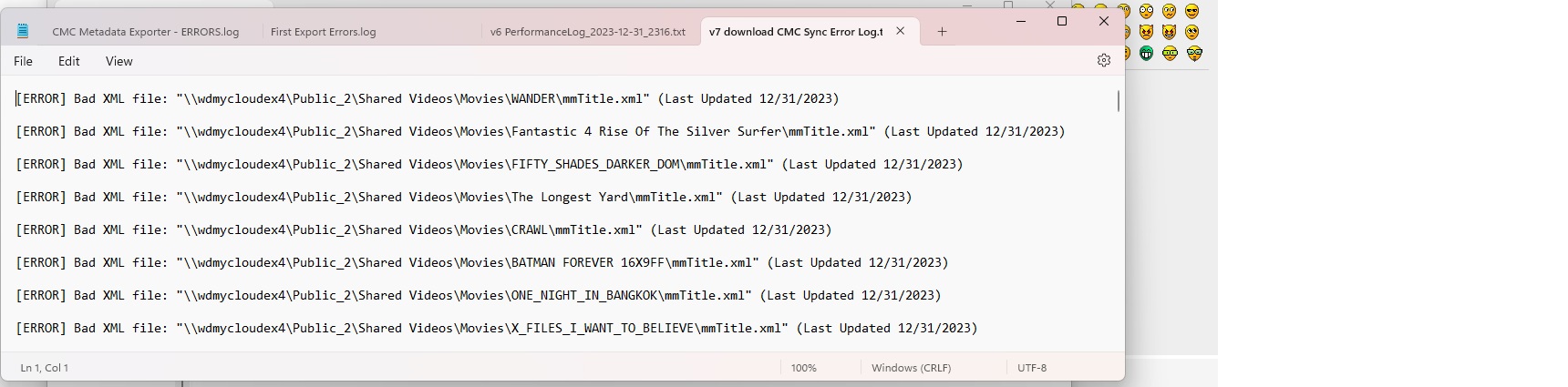

robert5733 wrote: Mon Jan 01, 2024 3:33 am Opened CMC v7 and ran a sync, received errors on all titles for bad .xml, mmTitle.xml.
all title error.jpg (182.18 KiB) Viewed 20181 times
So I decided to check the operation of export and sync. Changed the title of a movie in MMCM by adding a space. Saved the metadata and exited. Opened CME and exported changes. That title successfully exported.
Synced with CME and it gave an error for that title as bad .xml as before. All others are still fine.
one title error.jpg (49.28 KiB) Viewed 20181 times

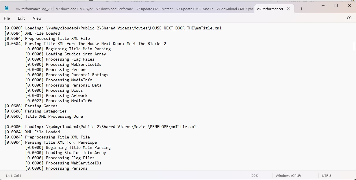

One thing I found in the logs is during performance logging, in v6 it loads all the information from the metadata
v6 loading titl xml data.jpg (159.92 KiB) Viewed 20181 times

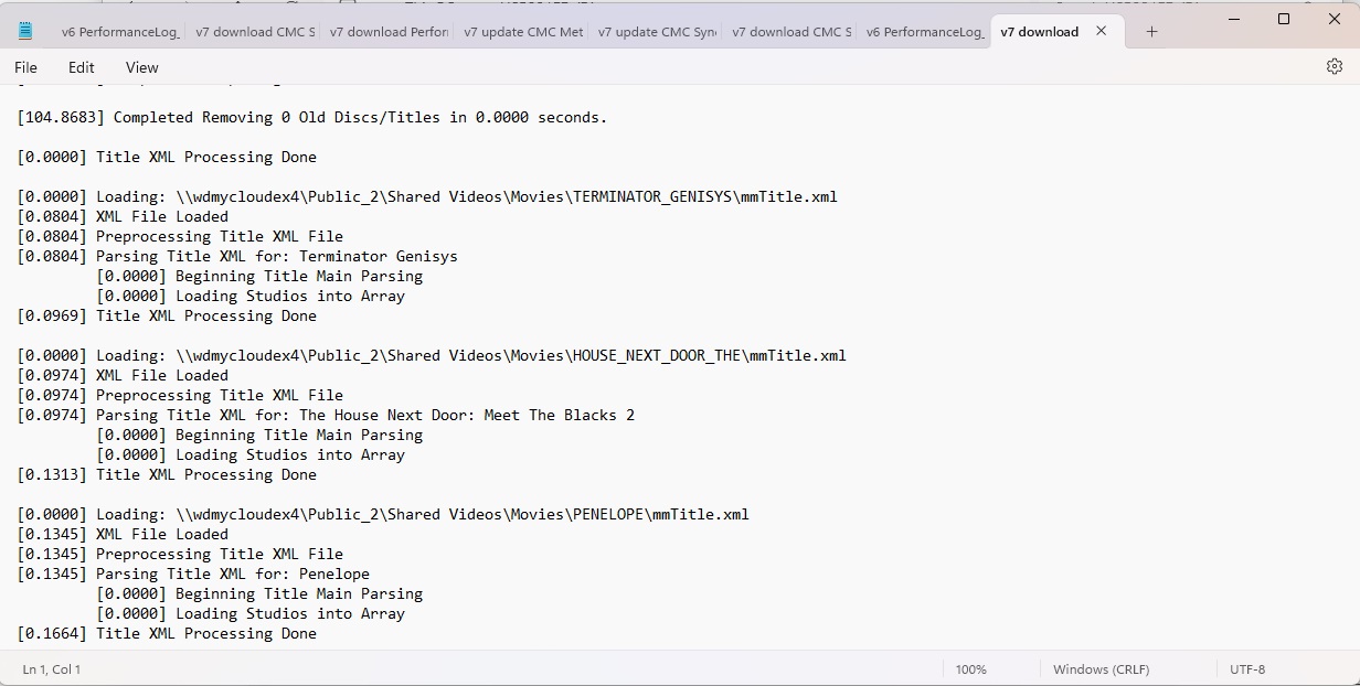

but in v7 it is not loading information
v7 loading titl xml data.jpg (164.1 KiB) Viewed 20181 times
