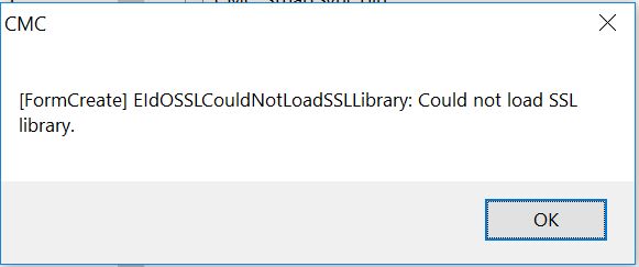

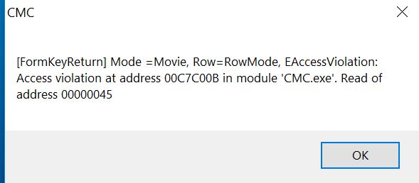

I returned from a week away for Thanksgiving and I am now seeing error messages when I attempt to use CMC.

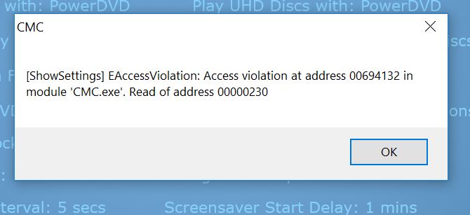

I attempted to enable the debug log setting but I am unable to access the settings feature in CMC.
Please reference the attached error messages that occur when trying to load CMC, move within the libraries (Movies & Music) and when I attempt to access the settings page.
Any help is appreciated in getting this working again.
Thanks

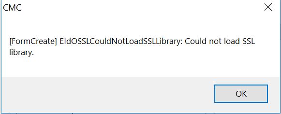

Downloaded and extracted into a new folder and was able to run without errors by double clicking the executable manually. If I attempt to run the application by selecting the Windows button on my remote it starts to load but I get the cannot load SSL library error.

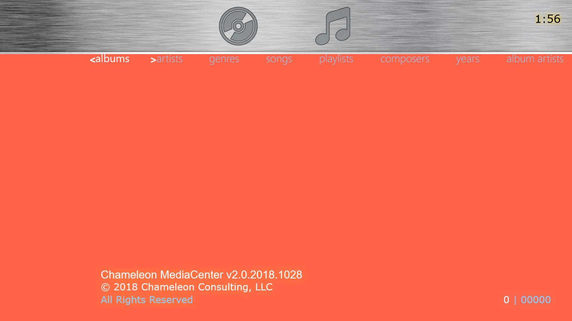

When I click this error to OK it CMC starts but loads with orange background and is limited in functionality.

Okay, something has become corrupted inside your normal CMC program folder. It could be the CMC.cfg file, or one of the CMC*DB.bin files.
Going in order of least impact, do the following:
Delete all *.bin and *.xml files ( should be 2, or 3 if you use the music library too).
Delete all XML files (should be 1, or 2 if you use the music library too).
Start CMC. If no errors, then run Syncs to rebuild the DB's.
If still errors, you'll need to also delete the CMC.cfg file. Then when you run CMC it will be like the first time. Reconfigure your settings and run Syncs.
If that doesn't work, then delete your CMC program folder, and start from scratch. Should only take a few minutes to set up and get your sync running.

In my last post I tried to overwrite the files in the existing C:\MMBrowser\ folder and that did not resolve the issue. I then created a new CMC folder and extracted the new download into that folder and reran the setup. For the most part this resolved some of the issue but not all. I can launch and run the cmc.exe file manually or add it to the startup folder in Win10 and it works. However, if I try to launch it from the remote I get the SSL library error message.

The remote configuration is still pointing to the original directory.
In the new directory, run CMC as Administrator. Configure the remote buttons you want on the Settings panel, Save, and also from the Settings panel select Update the Registry, then reboot.

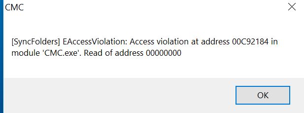

Ok. I followed the directions and now it seems the program is launching without error. However, now it starts syncing titles and it has been stuck for an hour at building directory list. It is scanning the UNC path \\servername\movies and coming up with nothing.
I can browse to this directory via the path from this machine without issue. Any idea on what would keep it from syncing the titles? Would enabling the logs help in this process?
