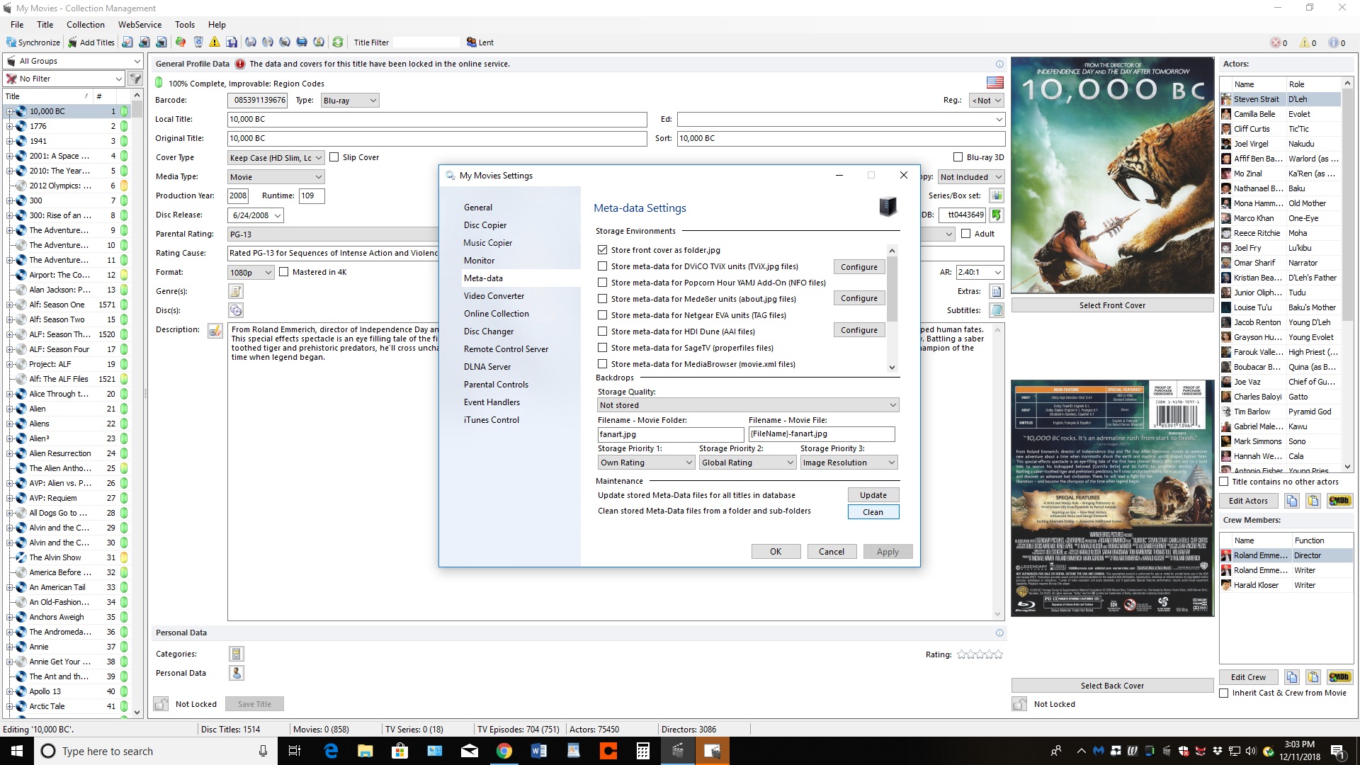

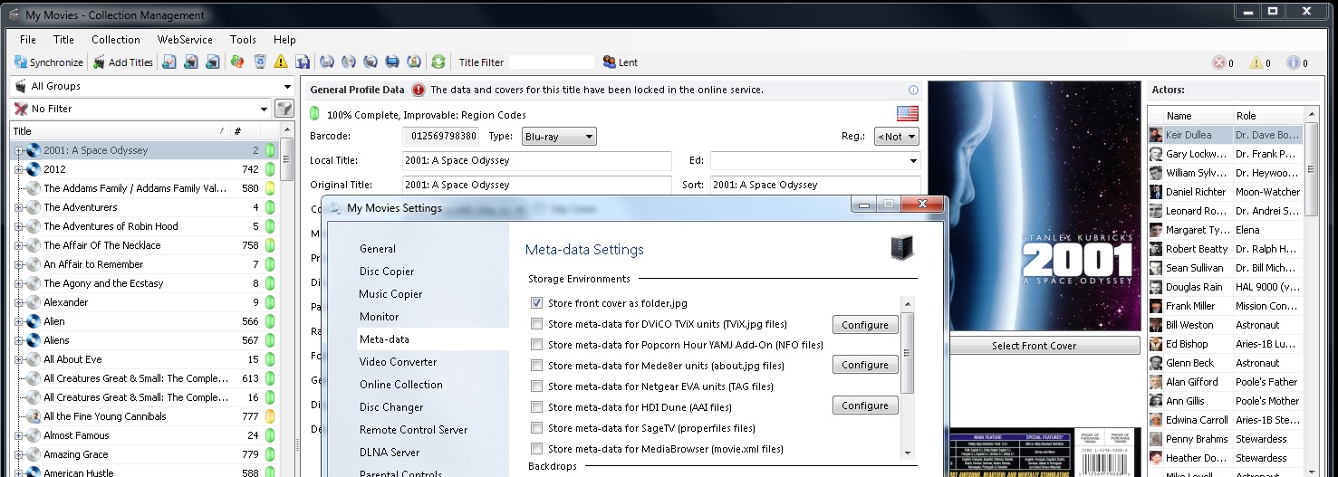

It's probably worth it to post the folder.jpg issue on the My Movies forum for support. But there are a few troubleshooting steps you can take first:
- When you select a title in My Movies Collection Management (MMCM), you can click a button on the top toolbar for 'Save Meta-data', and it will force MMCM to immediately write all the meta-data and artwork for that title. Have you tried this on a title that isn't generating the folder.jpg?
- Have you tried rebooting? There do seem to be some memory related issues with MMCM that are best fixed by an occasional reboot. Perhaps the setting to "Store front cover as folder.jpg" isn't taking effect without a reboot.
- Have you double-checked that "Store front cover as folder.jpg" is still checked?
- For the titles that are still missing a folder.jpg, have you double-checked that they are configured as either 'Online Folder' or 'Online File'?
- Have you enabled debug logging in MMCM? The logs are hard to read, but they might give a clue as to why the folder.jpg files are not being written.

Re: Movie folder.jpg files
Regarding my missing folder.jpg problem, I opened MMCM and verified that "Store front cover as folder.jpg" was checked. Then I hit "Save Meta-Data".
When looking at my movie folder afterwards using File Explorer, folder.jpg was still not there.

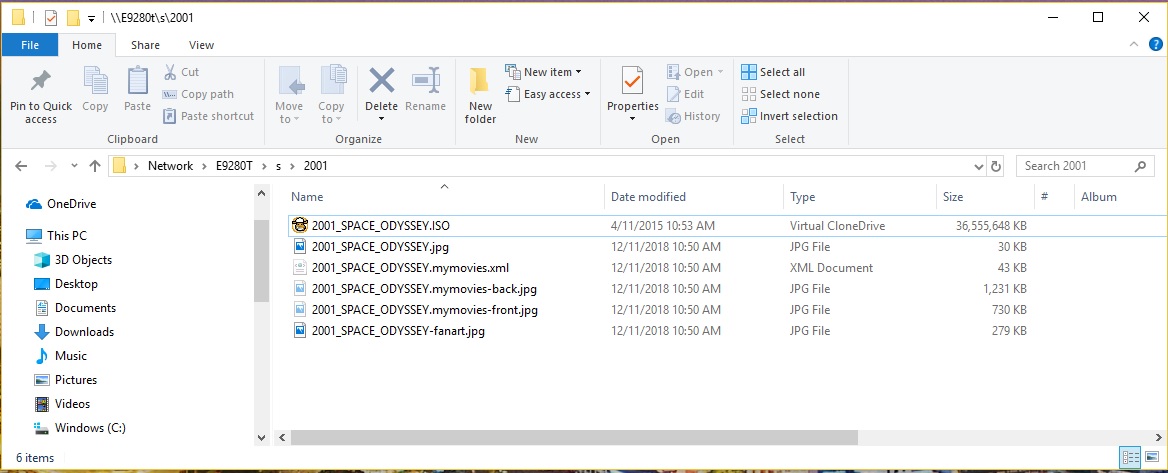

Hey Pete, 2001_SPACE_ODYSSEY.jpg is the folder.jpg file. You can tell because of the small file size. This must be a title configured as an 'Online File', for which the folder.jpg is actually named for the ISO, i.e. <ISOName>.jpg. Only Online Folders will be named folder.jpg.
CMC has logic to use the <ISOName>.jpg file if found, so these should work just fine.

This does work just fine. I just didn't realize it. So I must do a Gilda Radner "Nevermind".
So far - for testing - I had only copied 4 movies to my test Windows 10 PC. They each had a folder.jpg. I picked them because I thought they would only show up in CMC if they had a folder.jpg. (I had previously been working on my music collection where a folder.jpg definitely must exist in each folder.)
So I must have missed somewhere in your documentation that said online files will have a <ISOName>.jpg that CMC will read as a folder.jpg. I have just copied my 2001 SPACE ODYSSEY folder into my test PC. And as it contains a 2001_SPACE_ODYSSEY.jpg it works fine. Sorry to have bothered you.
I am very happy to know that I will not have to make copies and create new folder.jpg's.

No, you didn't miss it. I just never thought to document it. My oversight, sorry.pks wrote: Tue Dec 11, 2018 4:39 pm So I must have missed somewhere in your documentation that said online files will have a <ISOName>.jpg that CMC will read as a folder.jpg. I have just copied my 2001 SPACE ODYSSEY folder into my test PC. And as it contains a 2001_SPACE_ODYSSEY.jpg it works fine. Sorry to have bothered you.
Glad it is working for you.
