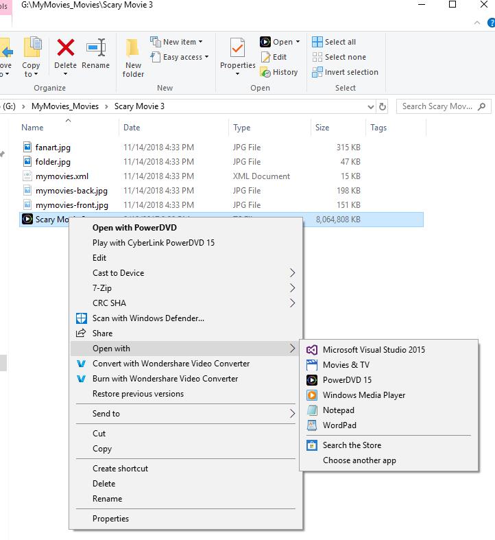

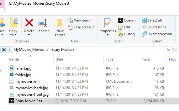

I have now migrated to Windows 10 and purchased a license.
TS files are transport stream files that are contained within the DVD VIDEO_TS folder structure in a slightly complex way as you know. But they can also exist as simple straight forward stand alone files. I believe it is essentially an mpeg-2 file.
Please see the attachment for Scary Movie 3. It resides within a simple folder named Scary Movie 3 like my other movies (ios files and regular video DVD folders).
There are two pictures attached. By right clicking on the ts file, it can be readily played by PowerDVD 15, and Movies & TV, and even by Windows Media Player. I can change the suffix to .mpeg-2 and it will play in Movies & TV and Windows Media Player. Then I can change it back to a .ts file with no harm done.
It's just that the folder containing the ts movie does not show up in CMC as an available movie to play.
As I mentioned earlier, I have over 100 such .ts movies that I have recorded off of TV using Hauppauge Colossus 2 High Definition Video Recorder. It does a really good job of recording and the ts format that it records to has very good quality.
Pete

And I am directly pointing to the .ts file in MyMovies.

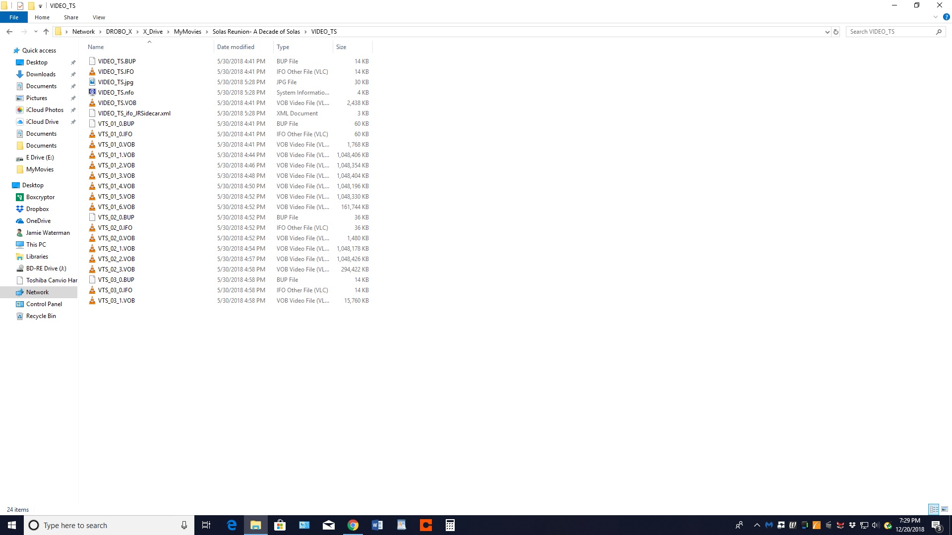

I think that Paul will have to program this situation separately from what he is doing now. What type of disk was this .ts file ripped from, or how did you create it? This information will help Paul to program and test for this situation that you just reported. In mymovies, dvd's are generally ripped to VOB files and placed in a VIDEO_TS folder. See my attachment. Blurays are ripped to ISO files. Other files are mkv and mp4
