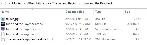

I checked the "D:\Movies\Alfred Hitchcock - The Legend Begins\Juno and the Paycheck" subfolder reported as missing mymovies.xml files and it hadn't been updated by My Movies, however, other subfolders in the "D:\Movies\Alfred Hitchcock - The Legend Begins\" path had been and had a mymovies.xml file.
This was just a group of nested folders. not a box set.
Do you have any idea why some subfolders would have been updated and not others?
Tom
Tom

Sorry, I wasn't clear. I don't need screenshots of the error file. You had already attached that and I could read it just fine. But then you went and removed it for some reason, so now I can't see it.
Regardless, what I need are screenshots of Windows directories and My Movies Collection Management.
For example, provide a screenshot of the Windows directory showing all files:
The provide a 3rd screenshot showing Juno and the Paycheck in MMCM.
Finally provide a 4th screenshot showing the window that opens when you press the "Discs" button while viewing Juno and the Paycheck in MMCM.
- D:\Movies\Alfred Hitchcock - The Legend Begins\Juno and the Paycheck

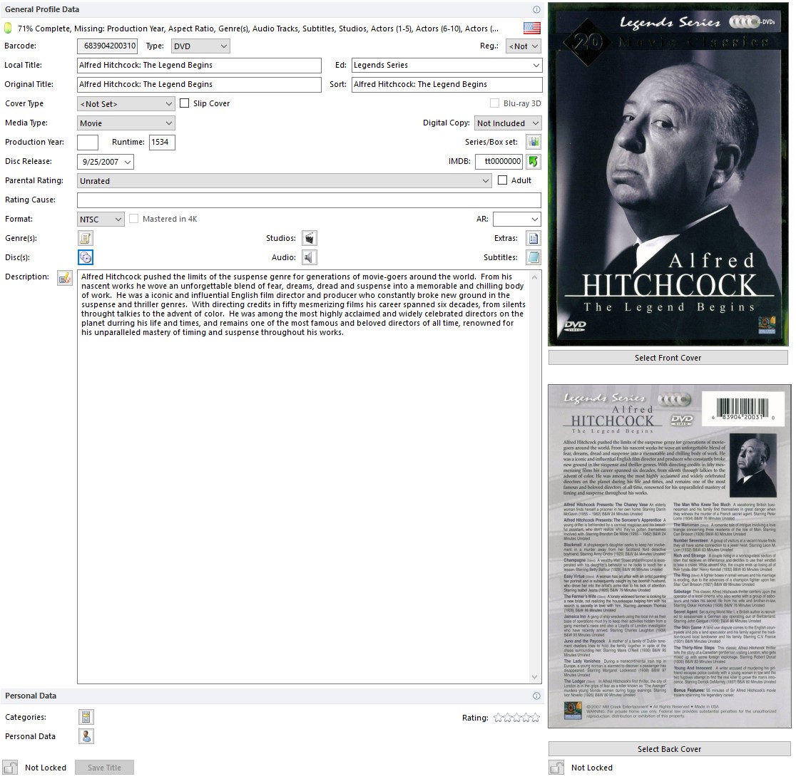

Here are the first two screenshots you requested. There is no Juno and the Paycheck title in My Movies so I can't provide the last two.
In order to get the Alfred Hitchcock title to play nice I would have to add Juno and the Paycheck as a title, however, My Movies does not have that title. That must be the reason some of the titles have the mymovies.xml file and others don't. I checked some of the other titles in the Alfred Hitchcock - The Legend Begins series and the titles in My Movies have the mymovies.xml file and the missing titles don't.
I looked at the mymovies.xml for a title that has one and it contains information about the whole series not the individual title and the .jpg files also show the main series pictures so I suppose I can copy that mymovies.xml and the .jpg files to the folders that don't have them. The xml files have information indicating the title is an episode of a TV series, however, the titles are about 1 hour 20 minutes long while his TV series was only 30 minutes so I don't believe the titles appeared in his TV series.
Tom
Tom

Re: Sync Errors
Thanks for the screenshots, extremely helpful.
Bingo.
But for best results, you'll want My Movies to generate the xml file, rather than you copying it.
Please provide a screenshot of the "Discs" for the Alfred Hitchcock - The Legend Begins. I want to see how that looks, and that might be the best place to add this.
I was also surprised to see that Juno and the Paycheck was an .mp4. Are all of them? Or are some DVD ISO?
tombean wrote: Fri Feb 08, 2019 12:08 pm In order to get the Alfred Hitchcock title to play nice I would have to add Juno and the Paycheck as a title, however, My Movies does not have that title. That must be the reason some of the titles have the mymovies.xml file and others don't. I checked some of the other titles in the Alfred Hitchcock - The Legend Begins series and the titles in My Movies have the mymovies.xml file and the missing titles don't.
Bingo.
