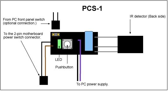

This tip comes from user pks who normally powers off his HTPC, and uses the SIMEREC PCS-1 to power it up with his remote control:
pks wrote:A number of years ago, I purchased the very inexpensive PCS-1 hardware device from www.simerec.com and installed it in my PC. This approach might not be for everyone. I had to drill a small hole in the front of my PC case for the included IR receiver.
But installation wasn't that tough and I love it. It has always worked very well. Anyone interested in more info can check out:
http://www.simerec.com/PCS-1a.html
So once again, my butt has remained on the couch from startup to shut down. Now if I could only find someone to carry me to bed.
While pks only uses the PCS-1 for powering on his PC, it is actually capable of much more. It can perform a shutdown or a startup, and even a forced-poweroff. This little hardware device is connected to your PC's motherboard just like your PC's power button, and essentially lets you press the power button on your PC's case via remote.
That also means that whatever behavior you configure for the power button in Windows is now conveniently at your fingertips on your remote control. For example, in Windows you can configure the power button to do a shutdown, or hibernate, or sleep.

SIMEREC also offers the PCS-2 which has the same features as the PCS-1, adding 2-button support for independent on/off control. Personally, I hate when devices like TV's and A/V receivers use the same IR command for both on/off, as it makes programming macros on a universal remote harder. The PCS-2 seems like the perfect solution for me, and I'm seriously considering picking one up for my HTPC.
One of my main goals for using a device like this is to be able to force restart Windows remotely should the PC become unresponsive. When I asked pks if the PCS-1/2 could do this, he said he had never done this himself, but he did some digging in the documentation and found this:

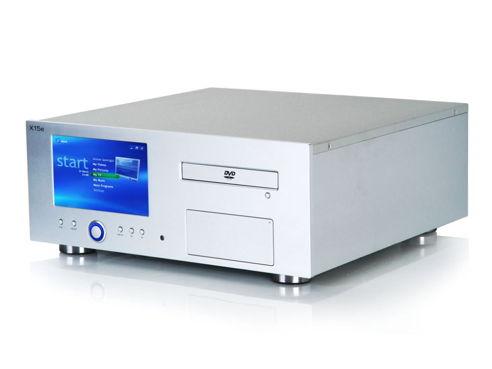

Years ago, too many to recall exactly when but easily over a dozen, I bought a high-end HTPC case, the Origen X15e. It's a beautiful case, looks right at home in an A/V stack, and has plenty of room inside for a full-size PC build. It takes full-size DVD drives, and you replace the drive tray cover with the brushed metal cover using double-sided tape, so the drive looks fully integrated.
http://www.origenae.com/en/htpc_x15e.htm
It's has a few features that I've long struggled with.
The glowing blue orb power switch is super bright and very annoying when it is in your line of sight. I'm thinking I can install a resistor inline with the LED to dim it down.
The LCD touchscreen is super cool, but I've never really found the right software to run on it. I'm thinking I will someday write my own... 8-)
And the built-in IR receiver never seemed WMC compatible, so I never really used it and instead used external WMC IR6 USB receivers. You can see the integrated IR receiver in the picture above, the small black dot at the bottom center of the faceplate.
The motherboard/CPU in this build has flaked on me a few times, and I stopped using it entirely over a year ago. Instead, I use my 7 year old laptop, hidden behind my TV, as my HTPC. The laptop has done surprisingly well for DVD/Blu-ray playback, but isn't up for any gaming. With all the talk recently about nano-sized HTPC's with integrated Blu-ray drives, my mind returned to this case thinking I should swap in a new motherboard.
So I picked out a new motherboard and CPU (the new Ryzen 3000 series is great, I picked up a 3700X and will be using it for gaming too), and a new UHD Blu-ray drive. All the other components (NVMe drive, RAM, video card) are coming from excess supply that I have.
Long story short, as long as I was rebuilding this PC, I thought I should try and address the built-in IR receiver in the Origen X15e, to see if I could finally make it the solution I always thought it would be. While reading up on the Origen website, I was shocked to read it has a feature I totally forgot about: It can remotely power on a powered off PC, just like SIMEREC's PCS-1. :!: Woo-hoo! :D
Here's the info on the IR110 receiver: http://www.origenae.com/en/accessory_ir110.htm
I'm not sure if this IR receiver ever made it into any other products, but wanted to mention that it exists and has this capability.
