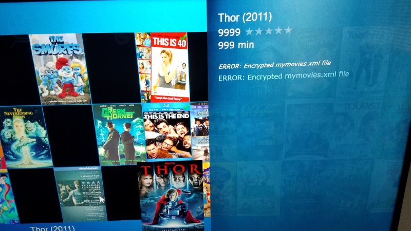

When browsing over movie tiles, some of my movies are coming up with an error stating there is an encrypted mymovies.xml file. I have reviewed the xml file and i can open it just fine, attributes are clean... Not sure where to go to fix this one.

- encrypted_xml (Custom).jpg (112.03 KiB) Viewed 14883 times

Please attach the mymovies.xml for Thor. The exact file that is causing the problem should be listed in the CMC Sync Error Report (in the Logs directory).

It is encrypted per the info in the file, but I'm not sure if that's part of mymovies process? Most of my titles are not encrypted.
i tried applying a different source title to it as well and no luck.

On the How-To page, there is an entire section on fixing encrypted and bad My Movies XML files as well as the initial metadata cleanup steps new users usually have to follow: https://chamconsoft.com/cmc/how-to.html
You should definitely read that, as it explains what is going on.
But that is a painful process, and exactly why I created the brand new CMC Metadata Exporter (CME): viewtopic.php?f=14&t=169
With CME, you no longer have to do any of those steps listed in the How-To for metadata cleanup and fixing encrypted XML. Instead, CME will export all brand new metadata, without any of the cleanup headaches.
It will also export more metadata for TV Series, allowing for a nicer browsing experience (and without all the extra tricks we use to do to get episode metadata to export). And the metadata files will be smaller too, which makes for an approximately 40% faster sync!
Since CME uses the My Movies API, Binnerup requires that you have 2500 contribution points to use it. It's definitely worth it, but If that's out of reach for you, then you can still use CMC with the mymovies.xml files, you'll just have to follow the manual cleanup steps in the How-To articles.

I don't have many points, but i was able to clean everything up thanks to your knowledge of the software. I didn't have too many to clean up, so i manually went through them. Here is what i did for anyone having this issue in the future:
1) Review the CMC logs and delete any encrypted mymovies.xml it finds
2) In my movies, search for those movies and update the information
Pretty easy fix for anything broken/old. For me personally, the biggest 'want' are the poster/fanart images and movie titles. Any missing art, i add it to my mymovies collection.
Hope this help someone down the road. And i agree with you if you have the points, there are better/quicker/easier methods available as you suggested.
Thanks again for your help!
