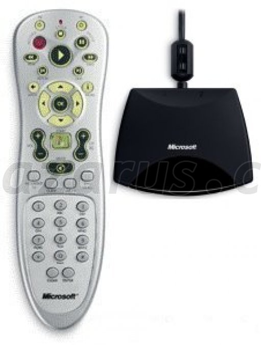

This is the remote that I’m using. A plain old mce remote. I think it’s one of the first one that we’re produced. For closing programs I use the mce record button. I run CMC as administrator so it can adjust the registry. I picked a episode from a series’s that I know is correct. MPC loads and starts to play the correct episode. When I press the record button nothing happens. It does not shut down MPC or J River. With JRiver when I press the record button to stop the player it puts me into theatre view. Appear to be doing things correctly. LOL.

I was able to resolve the remote issue. I had to download Advanced MCE Remote Key mapper to get the change to take. I had to run the tool as a administrator before I could push the change to the registry. Once I did that. The remote functions as intended. It now shuts down either jriver or MPC whichever has focus and returns me back to CMC. I don’t know CMC was being so fussy about the key mapping. I ran CMC as administrator made the change saved then quit CMC. I even rebooted the pc. Go figure. The other issue is I can’t seem to get the green button to accept that I want it to start cmc. I’m not going to set it to run automatically just yet. I have a few more tweaks for MPC to do.

Okay, good. On Windows 10, all buttons are available for reprogramming. On Windows 7/8.1, Microsoft prevents the reprogramming of WMC and multimedia buttons.
Teddyboy wrote: Mon Aug 05, 2019 11:10 am What I should have done is load CMC under administrative privileges, make the changes then save and exit. What I did was make the changes and save then run CMC again under administrative privileges thinking that it would apply the changes.
Either way should work. The import thing is that you have to run as Administrator to update the registry, and then you have to reboot before the changes take effect.

Hmmm, this seems very odd. The code in CMC that programs the remote was heavily inspired by the Advanced MCE Remote Key Mapper's source code, so they function very similarly. The main difference is that CMC is streamlined to just program a few buttons to work with CMC, while Advanced MCR Remote Key Mapper is fully featured to program any and all buttons to do anything.
Also, in addition to updating the Windows Registry to program the buttons, CMC also creates some special shortcut files with programmed hot-keys. These are required for make a button launch CMC.
Sounds like both of these are failing, which is why programming a green button in Advance MCE Remote Key Mapper wasn't enough to launch CMC.
Please run CMC as Administrator, then enable Debug Logging, then Update the Registry. This should produce a debug log file capturing the output from updating the Registry and creating the Shortcut files. Post the log file here.
