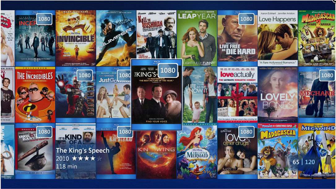

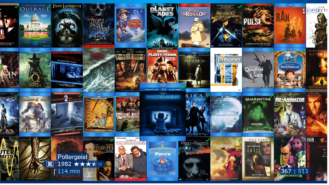

When I'm navigating in CMC, I use 4 rows of covers to display my collection. When navigating my collection to play something, the cover will enlarge a certain percentage so you know that's the one your over. Even though it enlarges, it tends to blend in with the other covers. Could you put a contrasting boarder around it do that it is more noticeable?

Teddyboy wrote: Sun Aug 18, 2019 4:22 pm I’m using the built in CMC profile for MyMovies cover display.
No, you are not. At least not according to your screenshot.

The top one is your MyMovies cover display the bottom screenshot is from the MyMovies site as a example. In settings what’s available to me in display settings for movie cover profiles are CMC, CMC no box set, MYMovies, and Plastic. The only skin I have available is the CMC default skin. When I pick MyMovies cover profiles with CMC default skin it works fine with the exception of no glow. There are no cover profiles in my default install. In the cover profiles install there is just you cmc profile.
