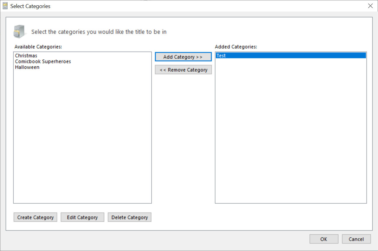

I then added Eulogy to the 'Test' Category and saved it:
I would expect this change to be reflected in the "personalDataChanged" date. Here's the new API response:

As a second test, I changed the Category from 'Test' to 'Halloween' and checked the API again. And again the API had the correct timestamp. I tested changing the Category through both the Categories button, and by right-clicking on the title, and it all worked correctly.
