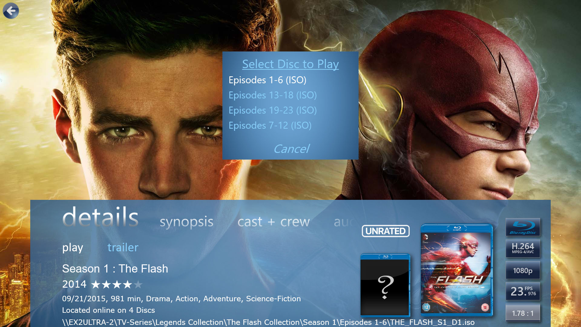

I have found that the title list of my box sets isn't recognising numbers of more than 9. This means number 10 will be listed after number 1 but before number 2 etc. Please could the program be amended to recognise all numbers in numerical order so the listing is correct. Please see attached to see exactly what I mean, thanks

In an alphabetical sort, 10 sorts between 1 and 2, this is correct and working as expected.
The solution is to adjust the Title's "Sort" name, or the Disc name, in My Movies Collection Management. For example, rename the discs as "Disc 1 Episodes 1-6, Disc 2 Episodes 7-12, etc. will address the sort issue you describe. Alternatively you can use leading zeros: Episodes 01-06, Episodes 07-12, etc.
