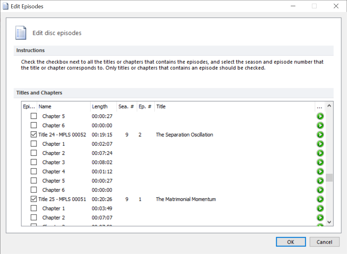

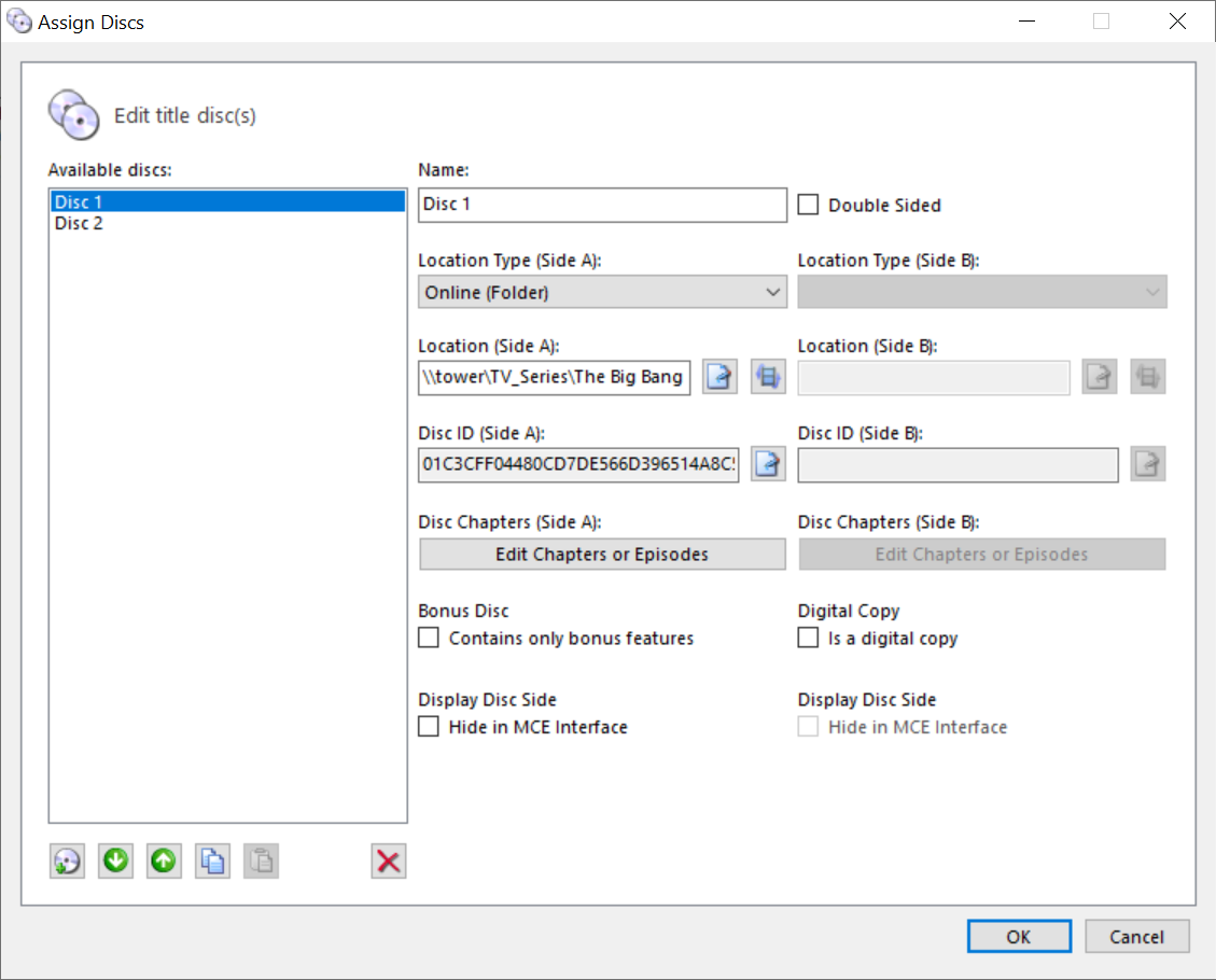

Next I need screenshots of My Movies Collection Management showing Discs and at least 1 Episode Mapping. Here are examples of what I want (from my own TBBT Season 9):

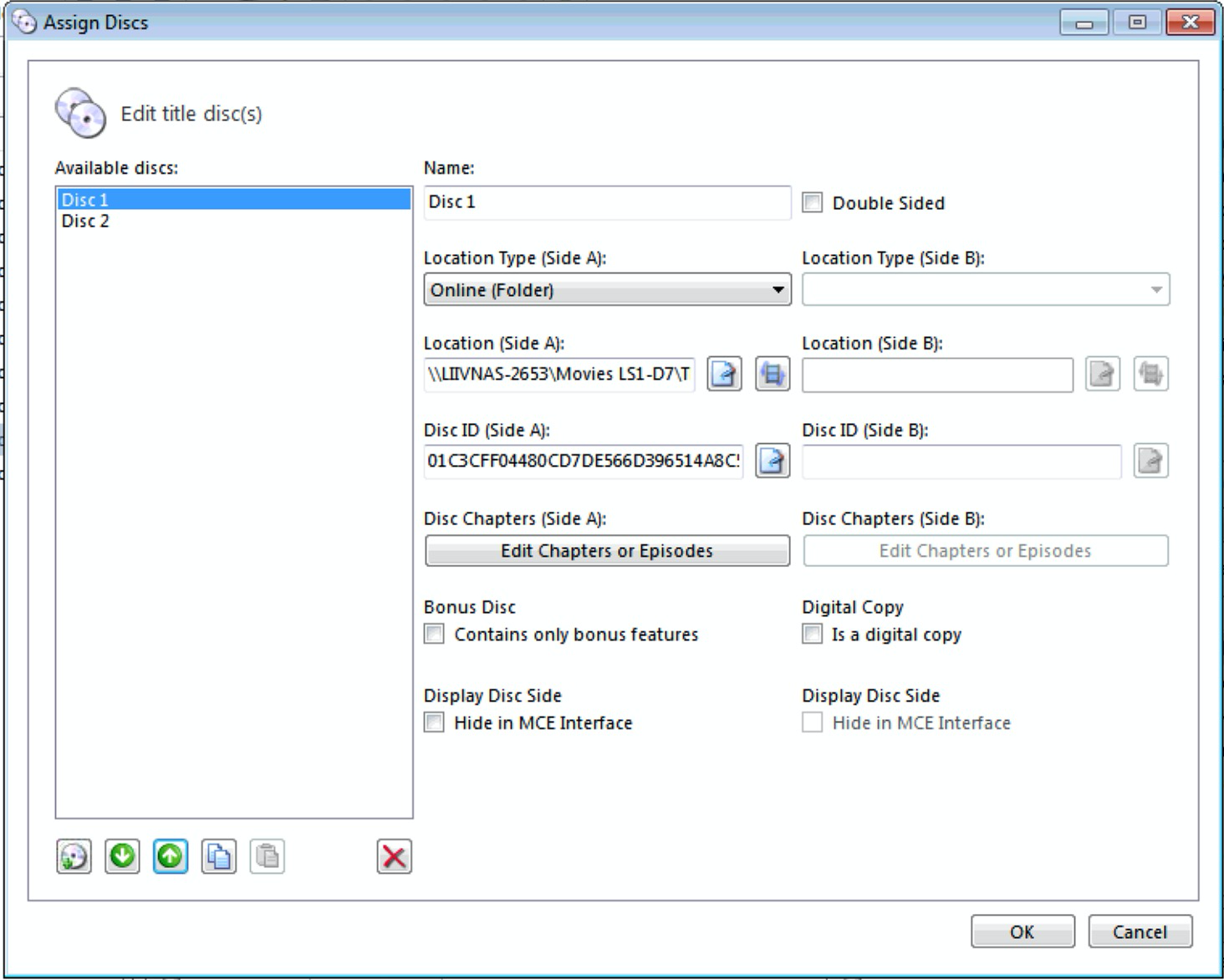

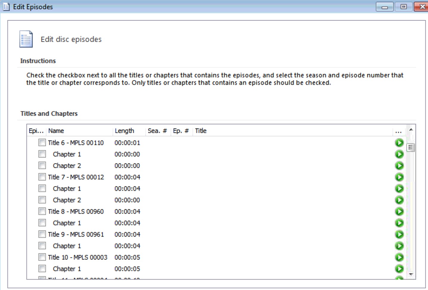

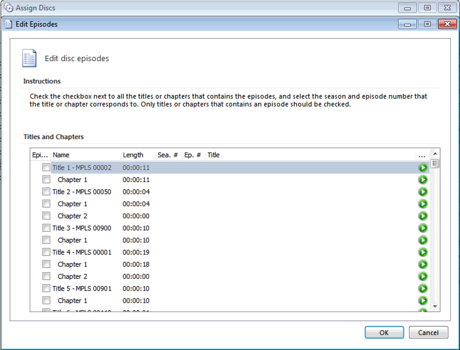

Here is Disc 1.... Do you need Disc 2 as well?

The problem is you don't have any episodes mapped. Look again at my 2nd screenshot, which shows Season 9 Episodes 1 & 2 mapped. You need to do the same.
