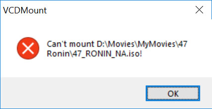

Are you talking about this error message?:
If so, then that is from Virtual CloneDrive, not MM Browser. And instead of hitting 'Back', you can press 'OK' or 'Enter' on your remote or keyboard, and it should go away.
I don't think there is anything I can do from inside MM Browser to control Virtual CloneDrive error messages.
Is that the error message you were referring to, or is it something else? If something else, can you take a screenshot and share it here?

Post by Gilles2 » Wed Apr 18, 2018 3:18 am
This is not this error message. Sorry.
The error message is displayed in large white letter on the MMBrowser interface, not in a separate windon like on your example.
